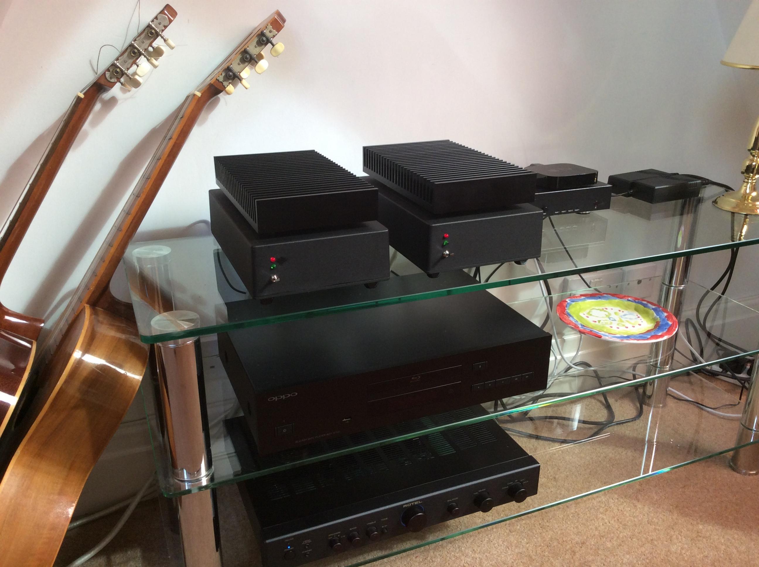

Having had a 20 year break from DIY audio, I was inspired to build two ACA, and I have to say, I am pretty astounded with the resulting sound. I have a fairly modest setup, Oppo 101 blu-ray (excellent CD reproduction), 10-year old Rotel RA-04 (using pre-out sockets), KEF IQ3 bookshelfs (about 89-90dBm I think). What a step up in finesse compared to the Rotel power amp stage! Much more detail, better dynamics, overall more realism. And for my tastes, plenty loud enough.

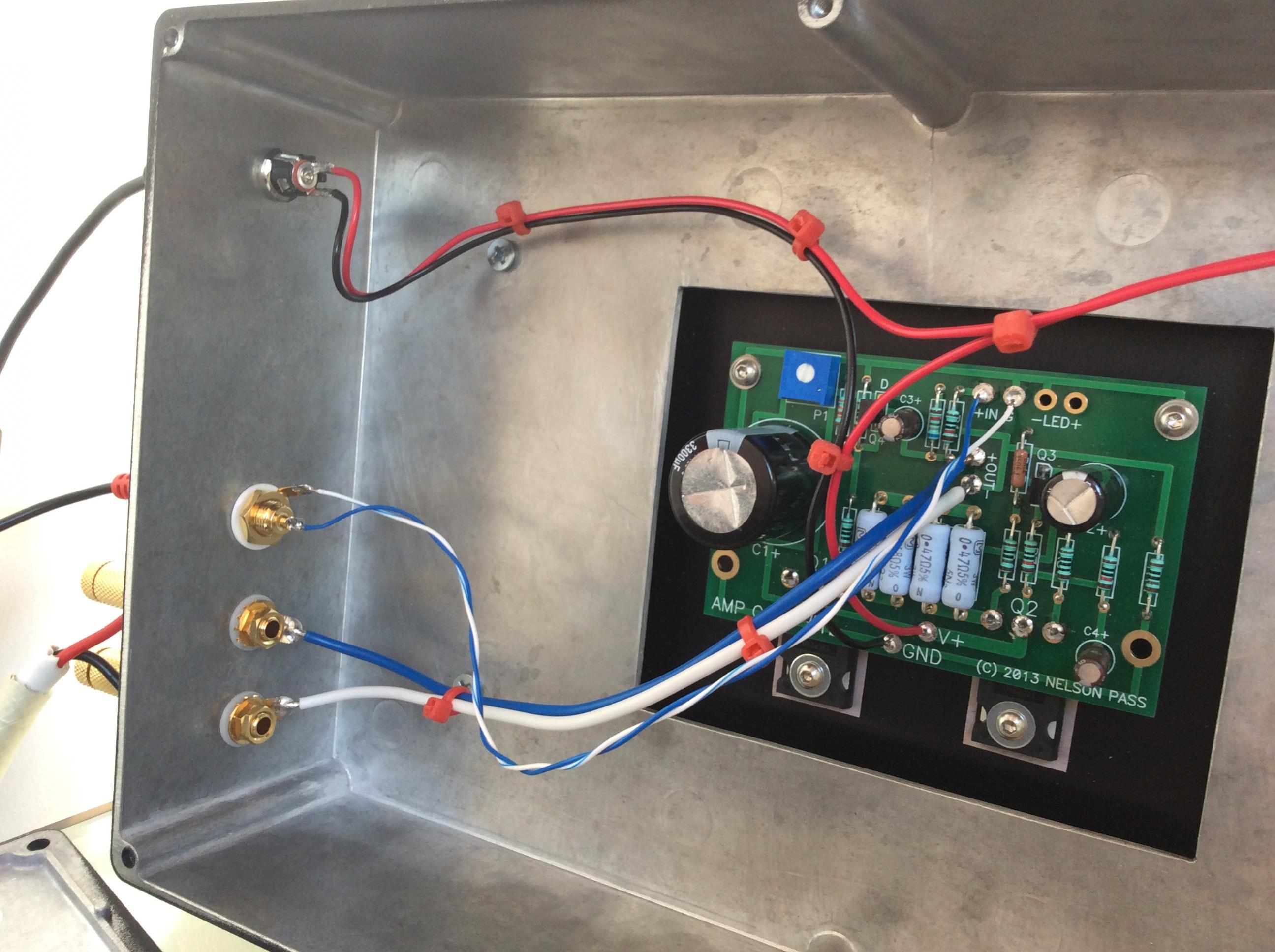

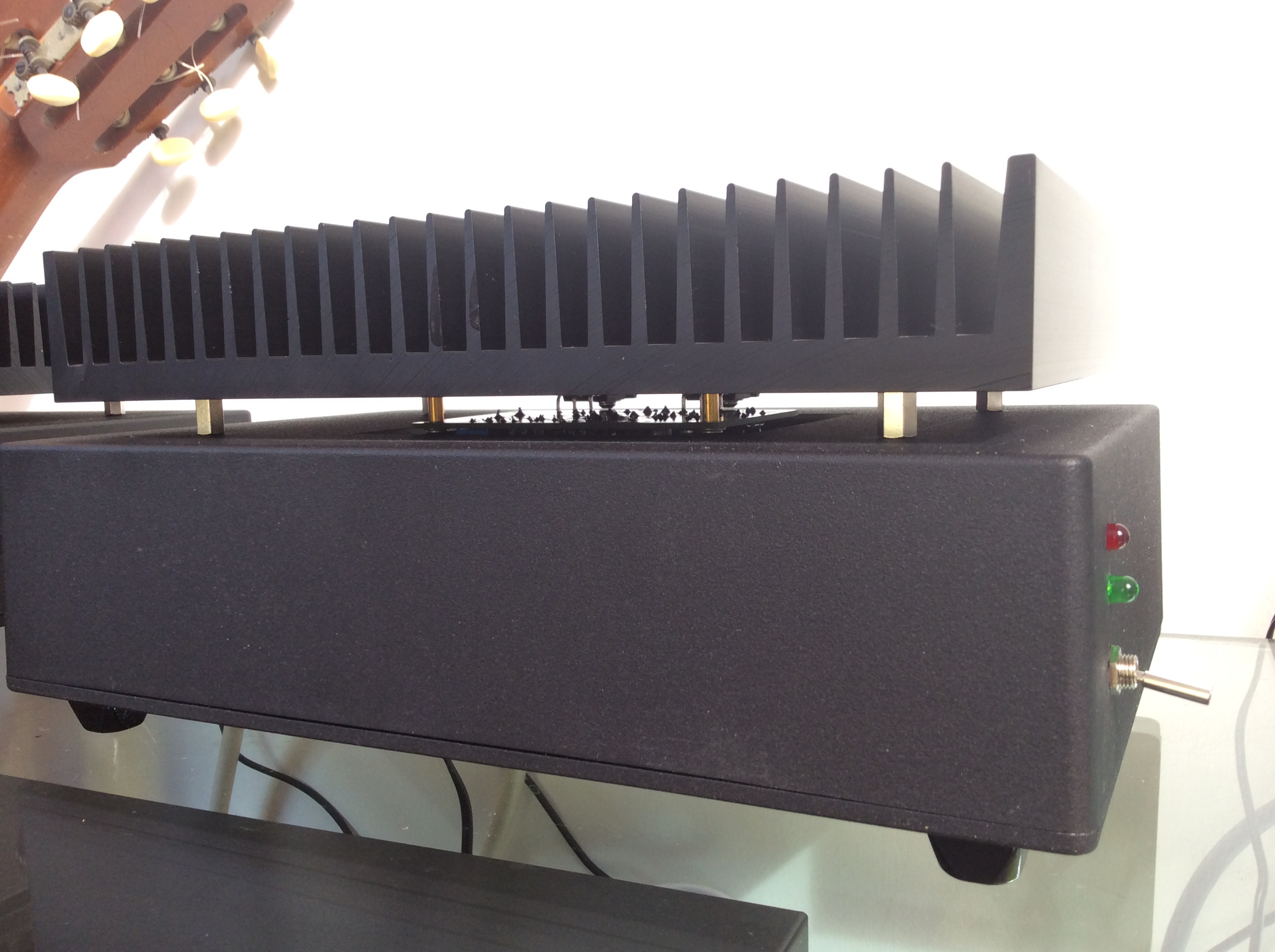

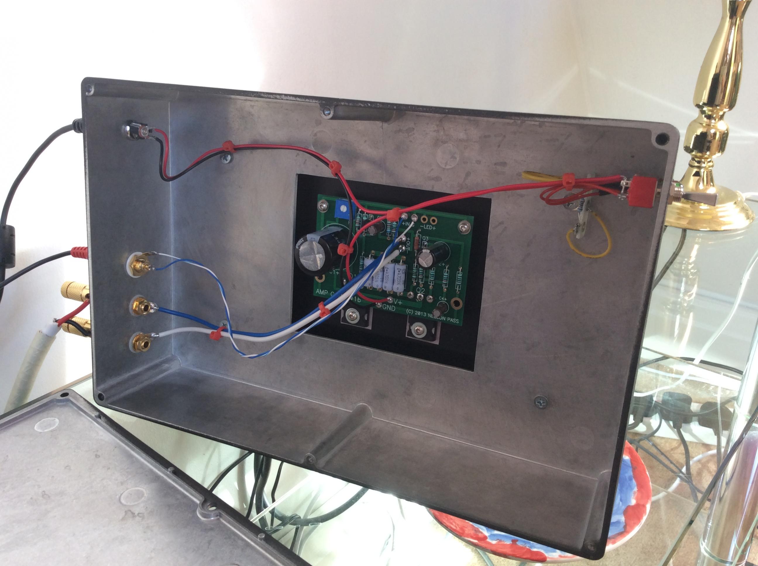

Anyhow, you can see by attached pics that I am using Hammond die cast aluminium enclusures, horizontal heatsinks (250x150x40mm) on stand-offs to let the air get around, PCB's upside down with access by taking off the bottom plate of the boxes. Sort of Quad II style if you like! I have the R15 mod, and it is possible to touch the sinks indefinitely without discomfort, so they must be <45C I suppose.
I have to say that the power resistors do get hot, but I have tried with the amplifier upside down (PCB upright) and still pretty hot. The situation is not really worsened by the PCBs being normally upside down I think. I will have to monitor the situation though...

Very nice work Niceonecyril! One of the nicest designs I've seen using he Hammond enclosures. My power resistors don't get very hot, but I haven't done the mod on them yet. Perhaps that is why. Thanks for the pics.
Nice one niceonecyril 😀
I've been running my with the heatsink in the same vertical layout with no issues. My ACA is from the first run of complete kits and the heat sinks are smaller than yours.
It's at least 3yrs old and there's been no issues, just sweet sweet music
mikegranger, Skip Pack, JRKO,
Thanks for your comments, I'm glad its not just me: yes, the heatsink dissipation is fine in this orientation, perhaps a little less efficient than with baseplate vertical, but adequate. I am thinking of getting the power resistors more up above the board though, maybe 1/2inch and not so close together. Power dissipation in these is roughly 2x unmodified version.

One thing that I didn't bargain for is that heatsinks of this size are quite often not entirely flat: these have about a 0.8mm upright hump across the width of the base plate as bought in from the metal supplier. This was a good reason to stand them off the box a little. I was told by ABL support that if you really want flat, you have to do a milling/grinding operation on the bottom face. With a 10mm base there is no bending them easily either. Bolting them hard on the enclosure might result in the Hammond losing the battle.

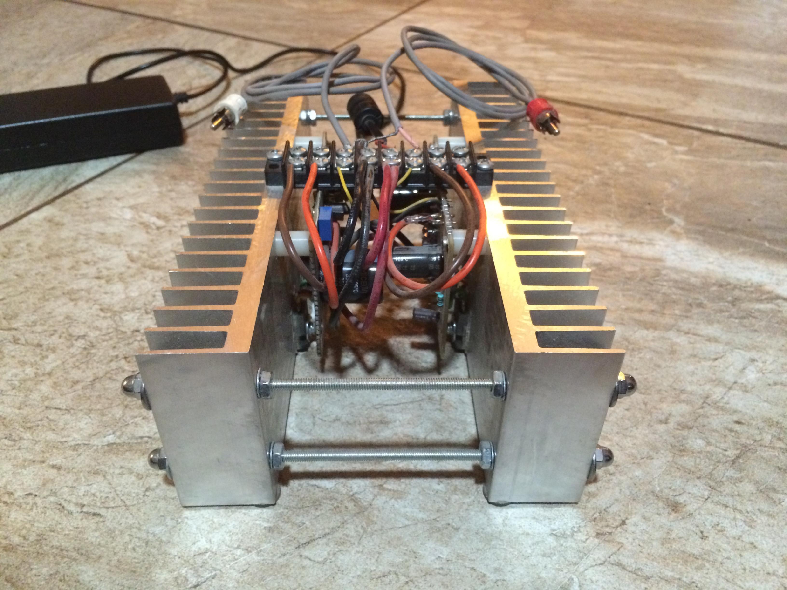

Here is my minimalist version of a stereo ACA amplifier. It was built early on using the only thing I could find in stock at the DIYAudio store ... The excellent heat sinks. It is bolted together using threaded rod and acorn nuts. Stick on rubber feet on the four heat sink corners keep the sinks slightly elevated for better air flow. The barrier strip adds additional strength and provided the connections to the outside world. Pretty ugly compared to what others here have done, but it has very good ventilation!
