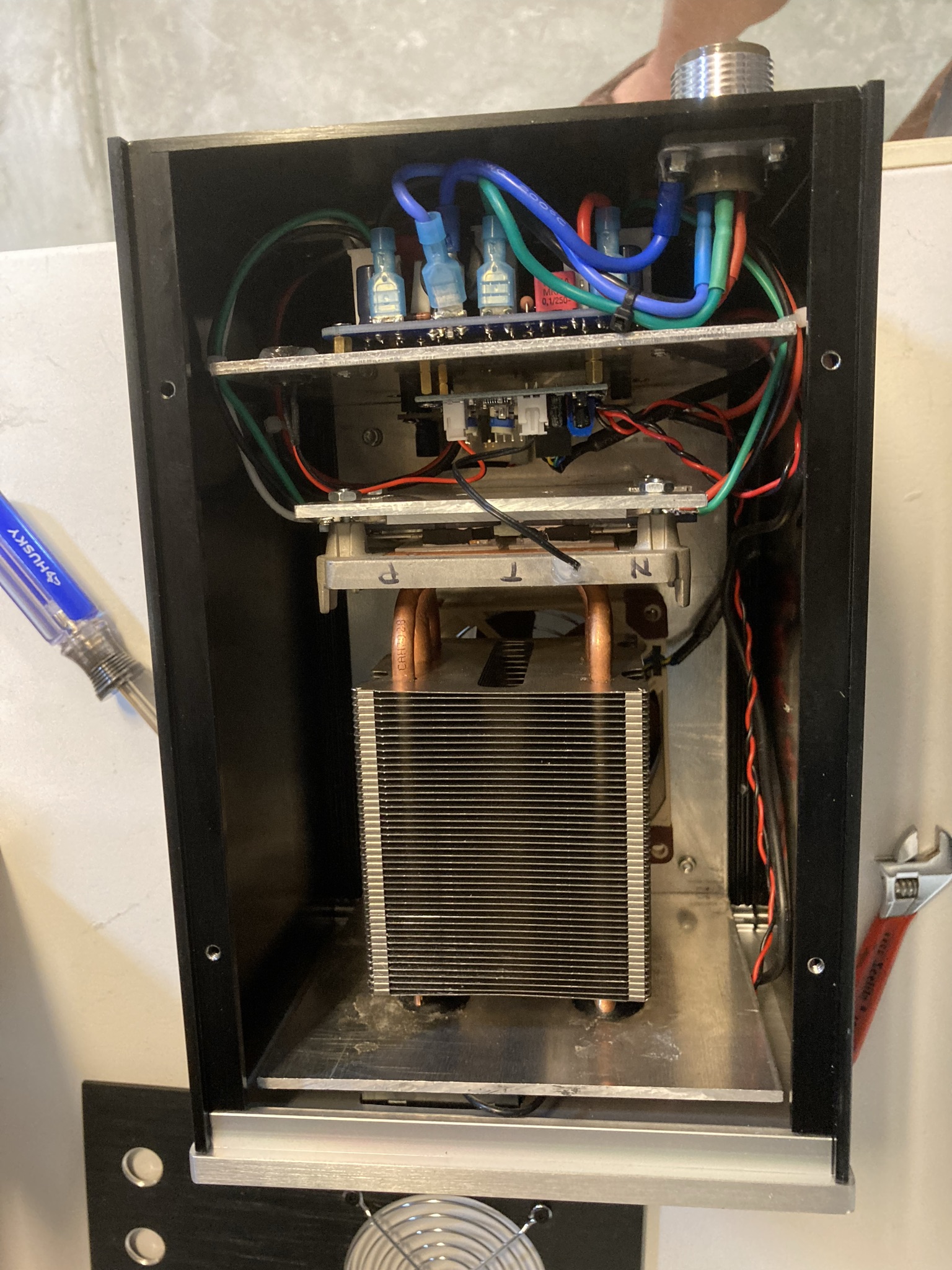

You need to use the $3 PWM controller and the low noise adapter (I suspect they are series dropping diodes?) and the Noctua will be silent. Adjust the PWM for low speed and stick the temp probe in the fins and it will speed up if above preset temp according to data sheet. There are two thresholds , 50 and 70C, I think.

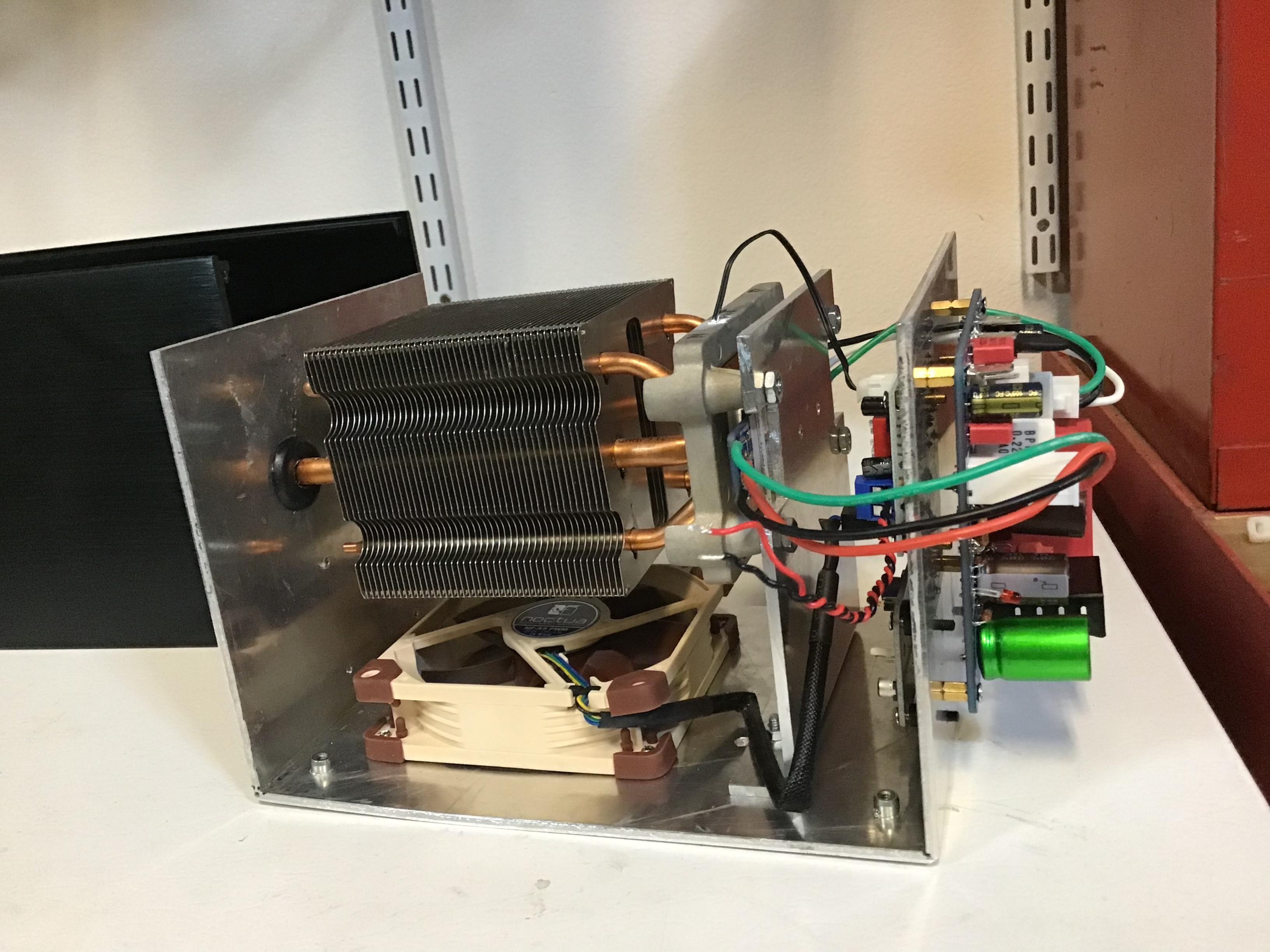

The Noctua’s are silent. Really - you need to get the right ones though. The ones I use, have all sorts of aerodynamic tricks on the blades and housings. Sort of like F1 CAD design by CFD. It would not surprise me if Noctua’s are a subsidiary of RedBull F1 racing or started by one of their former aerodynamicist as both are in Austria. They have about 30 aerodynamic patents on the fans to make it silent. It’s all wind tunnel research and computational fluid dynamics (CFD).
To keep it truly silent, it needs to run at about 50% of its rated speed. So if it can’t cool the load at half speed the get a bigger unit or more fans. But with the PWM controller speed adjustment pot set to low and the dip switch set to not increase speed unless really hot. The claimed dB level on mine are typically 31dB and I believe it. With my ear 5 inches away I cannot tell it is spinning.

I just got the box out mine came model NF-A9 PWM without adapter 22.8 db with L.N.A16.3 db so 92mm not 80mm but good specs however the 40mm ones have a lot lower db rating again, would 2 40mm be quieter than1 92 ? in theory yes.
I just went to there website the NF-A4x10 FLX can get as low as "Acoustical noise with L.N.A.12,9 dB(A) "

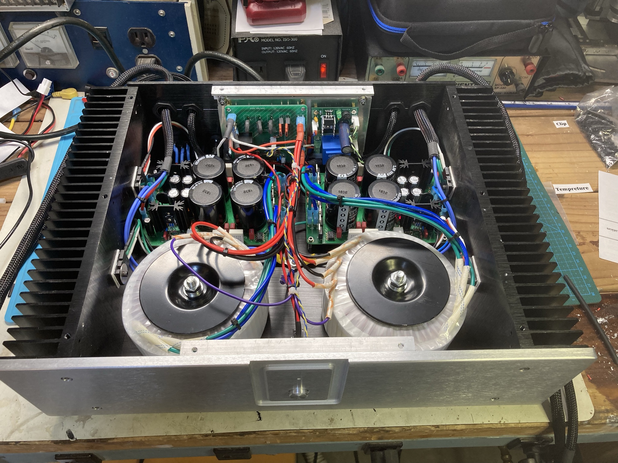

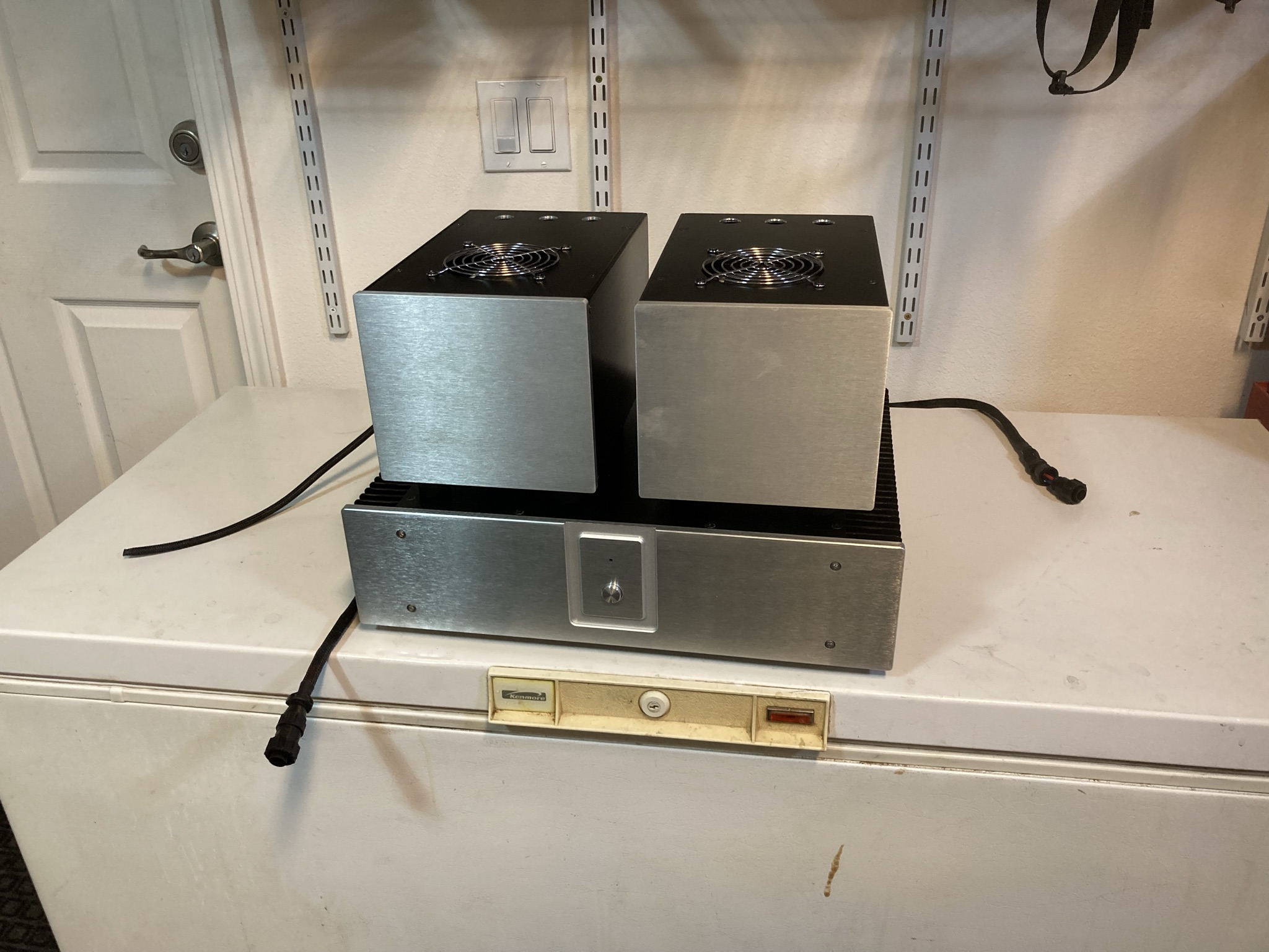

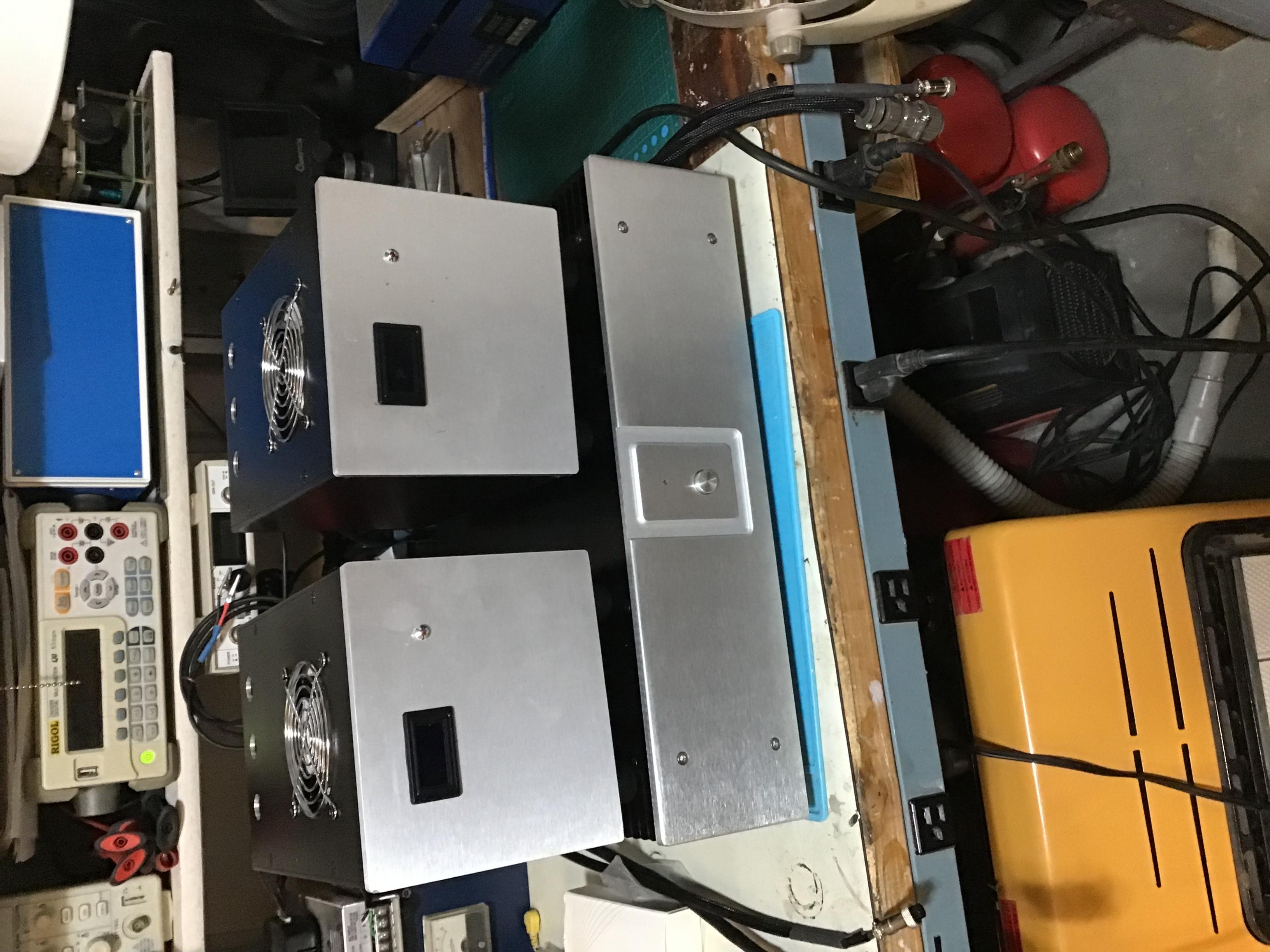

Almost done
Well I tried to print some decals but the laser printer would not accept the decal paper stock. So I will move these to the living room and begin test
wirewiggler,
Impressive work in getting everything well organized and executed. Like Hugh, I look forward to your listening impressions.
