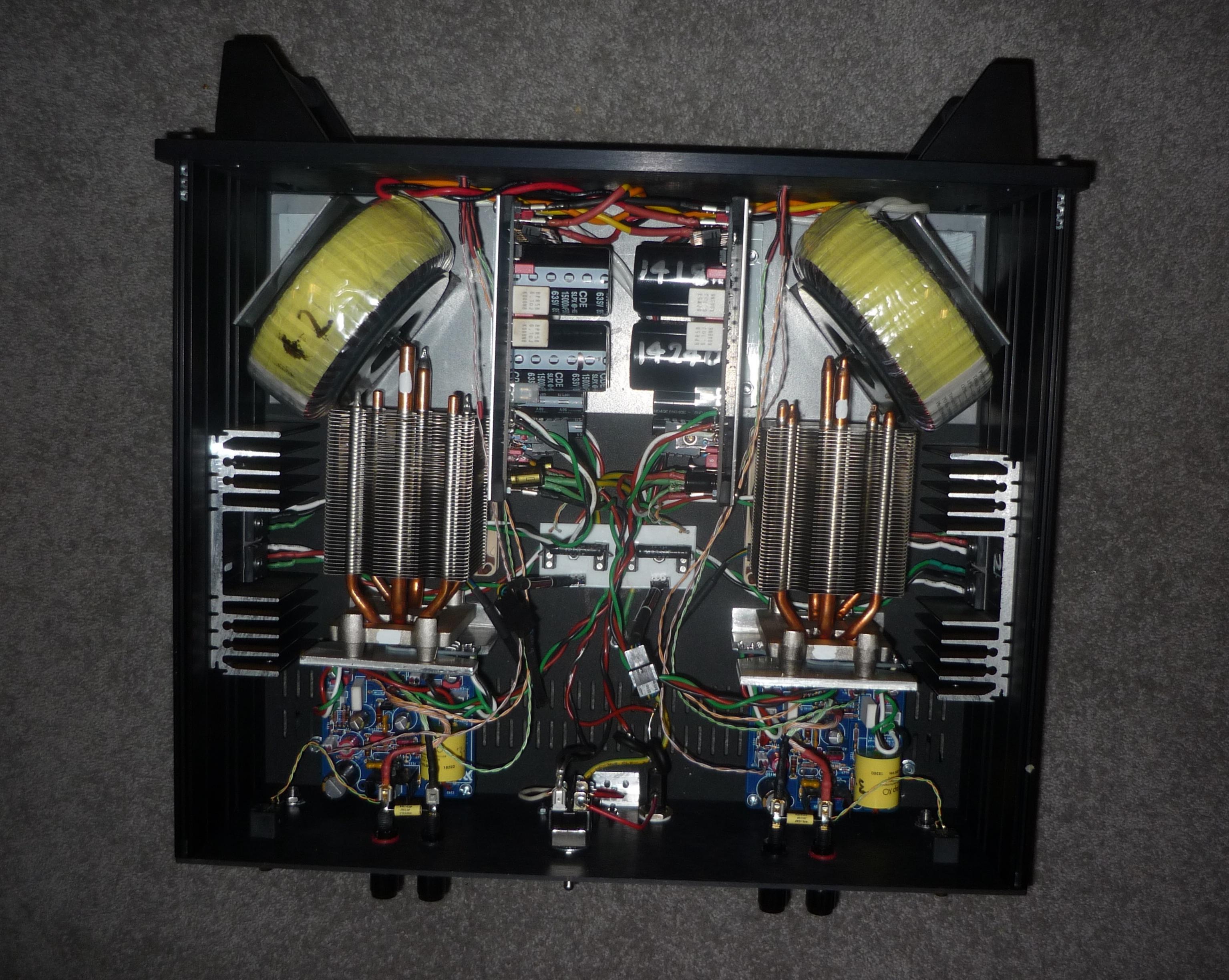

It is a cpu cooler, I have a pair of SLB power supplies in one case and the Alpha Nirvana’s in their own case - part of my dare to be stupid themes. I was surprised how quiet and effective the cpu coolers are, garage was 93 degrees f and cpu coolers 45 c hanging just below full speed.

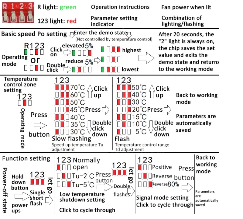

I wonder how many degrees you have set the fan control board for starting and if your PWM fans stopped after the lowest temperature value..

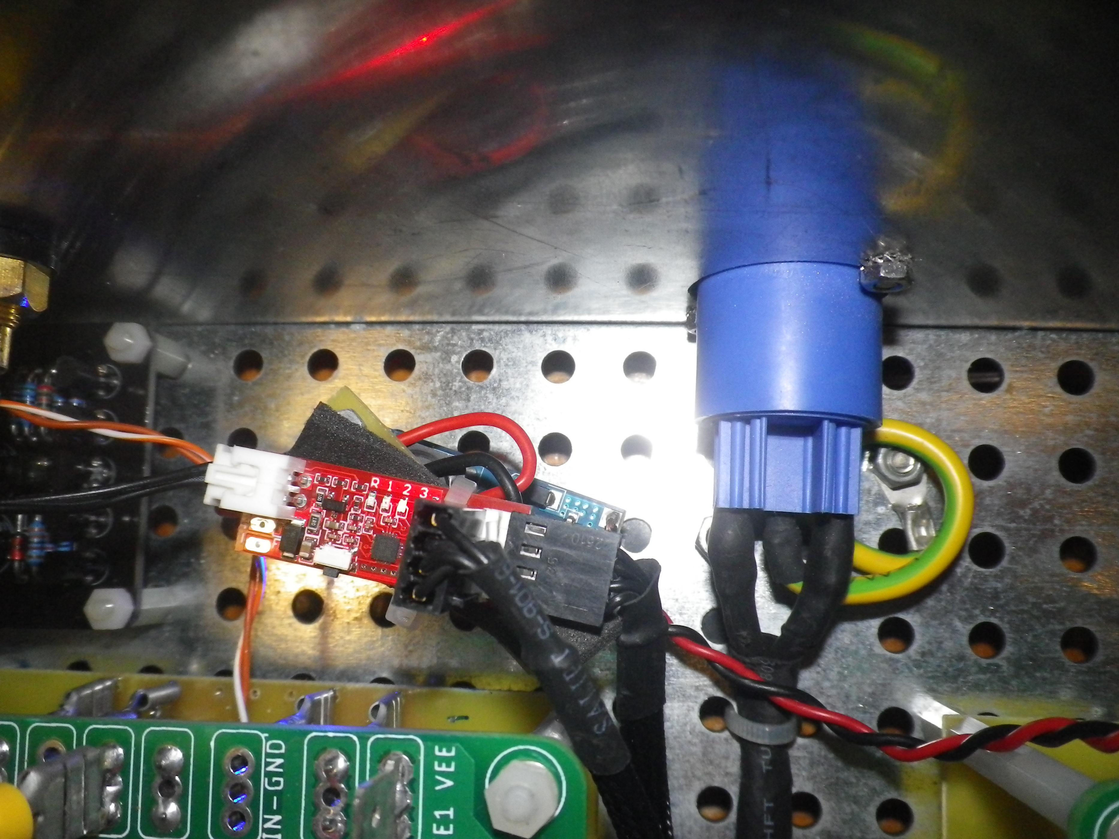

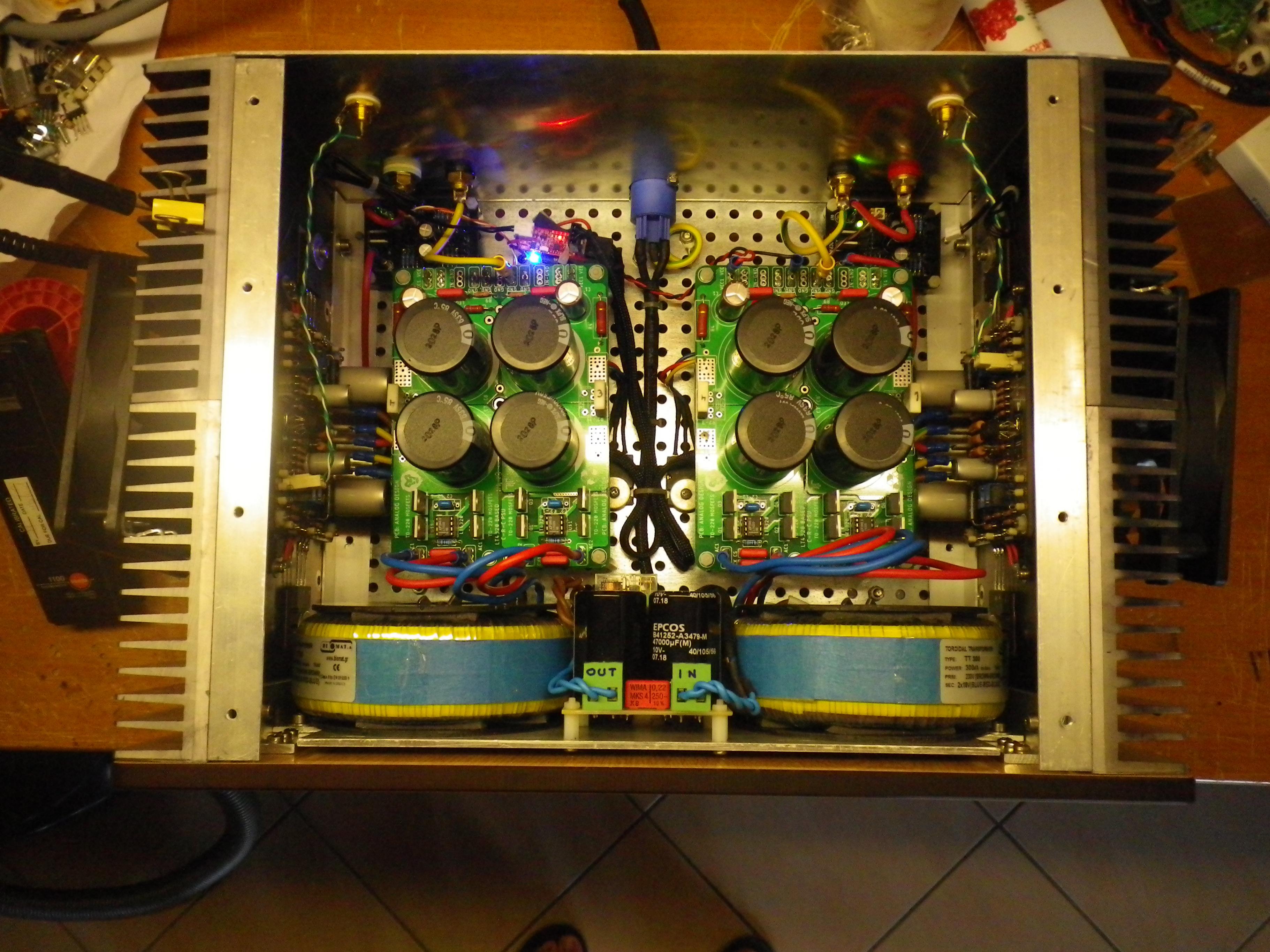

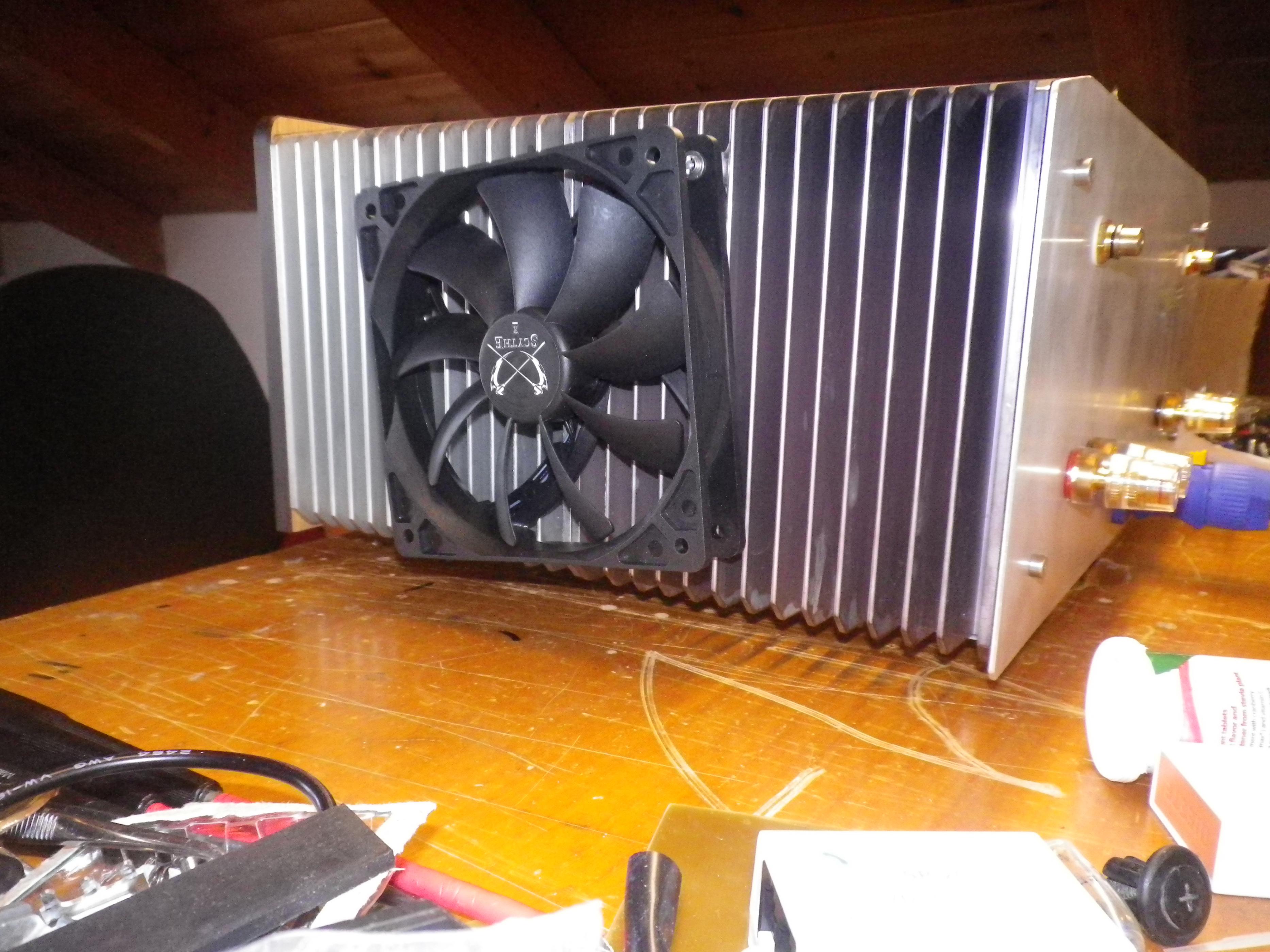

Ιn my amplifier the USSA 5.0 that works in 1.3A , i have applied with great success two PWM fans outside the heatsinks that are controlled by this
DC 5V 12V PWM Speed Controller Fan Speed governor 2 3 4 Wires Computer Temperature control Switch for PC CPU Cooler Fan Alarm|Switches| - AliExpress
My fans stopped if the temp go lower than -2 or -5 C degrees from starting fans temp 40 C
Regards Nikos

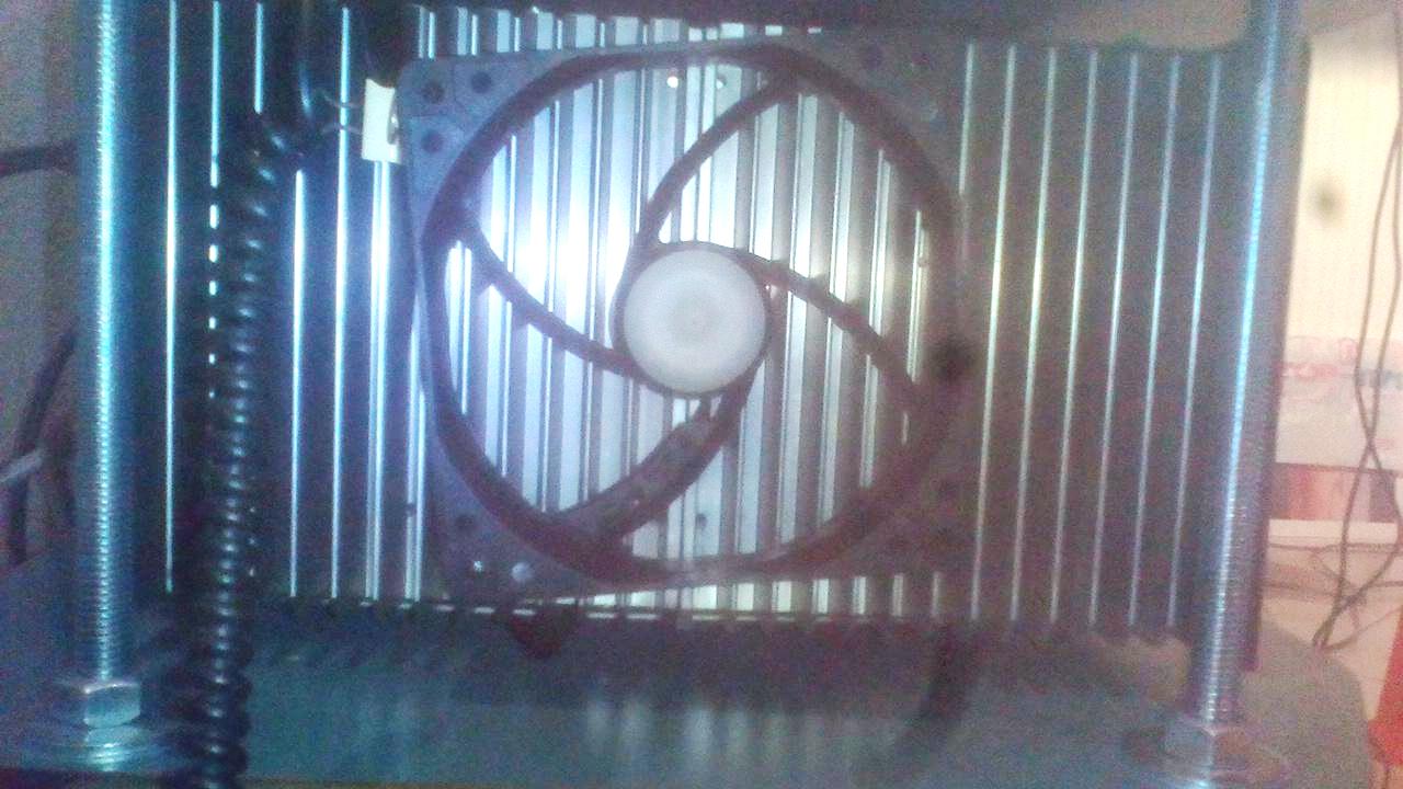

Ιf you mean the noise from the fans is very very quiet(only PWM fans) you can also adjust the rotation force to 10 levels I use this...
Slip Stream 120 PWM - Scythe EU GmbH : Scythe EU GmbH

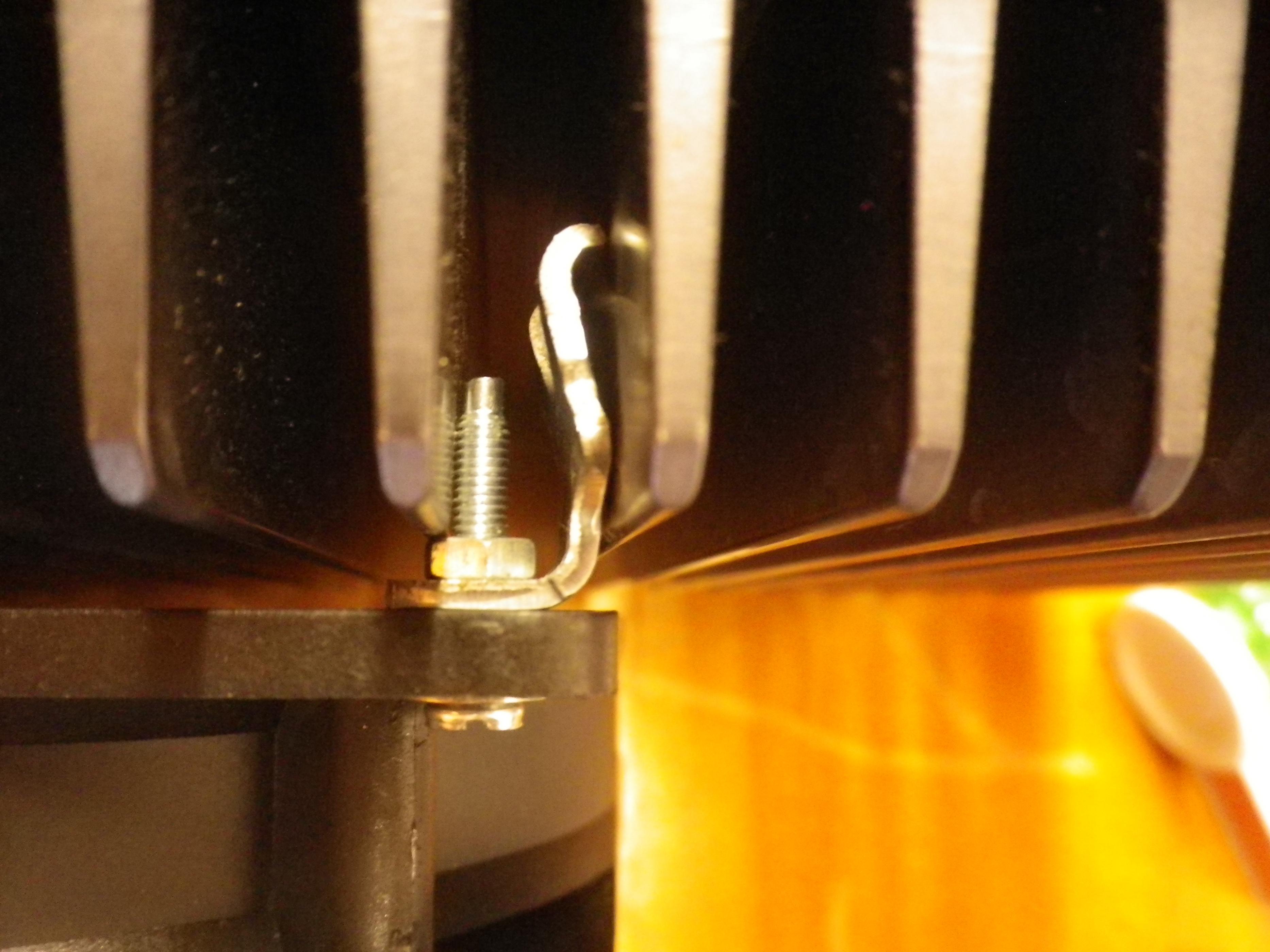

I use Dell FD411s in my 3RU Modushop Slimline case - 350mm deep - with an 80mm Slimline Noctua fan underneath each CPU Cooler (and holes cut in the base panel).
Works very well in terms of heat but, even though I'm using the additional cable which comes with each fan (which reduces the voltage getting to the fan and hence its speed) ... I am still annoyed by the fan noise. 🙁

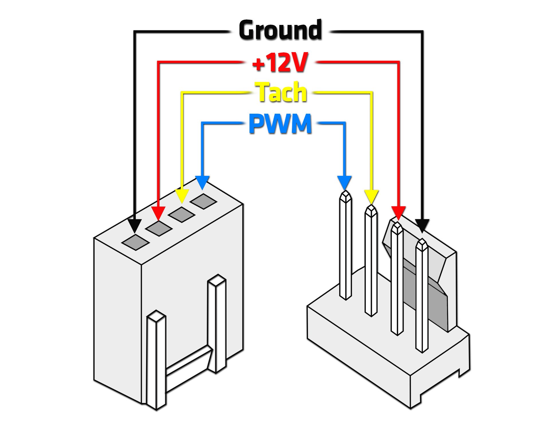

Do you use the capability of pwm fans 4 cables by controller board? or use the fans simple use two cables?
#andyr
Do you use the capability of pwm fans 4 cables or use the fans simple use two cables?
The fans are PWM capable (having 4 wires) but I am just using 2 wires - given the ancillary cable already cuts down the voltage going to the fans.

the noise from the fans is very very quiet (only PWM fans) you can also adjust the rotation force to 10 levels I use this...

i set force in 5 level this force this is enough for me to turn my temperature heatsink from 40C degrees to 38C the time the fans turn on is about 3 minutes. my temperature room about 30-32 C . Ιn truth nothing is heard.
@Andy PWM fan inside has a chip maybe you use all cables by controller..when i use the PWM fan with two cables make a noise at start or at low turns..

The dB rating on the Noctua 92mm NF-A9x14 PWM 2200RPM Fans (14mm thickness) when using the 'LNA' (Low Noise Adapter) cable is 13.5dB. This reduces fan speed from 2200rpm to 1700rpm.
Even so, I can hear the 2 fans in each case when standing above them. 😱
Andy, is there not enough space for, say, 120 mm fans?
OTBE, 50% bigger fans, as a rough rule, might be ~ bit over twice the cooling …
Allowing much lower fan speeds

Υes indeed...Βut mine bias for USSA 5.0 is 1.3A I dont know for Alpha Nirvana ...i think more...i wil post pictures with all respect for this thread..
That's a very interesting concept Otto. 🙂
I had not thought about using a much larger fan - to be able to lower the fan speed (and therefore noise!).

1. Is a 120mm Noctua fan available in the same Slim Line depth I have with the 80mm fan?
I will have to investigate.
and
2. If the fan diameter is so much greater than the area of the CPU cooler fins ... is that of any benefit, in terms of cooling efficiency?

It is a little early in the game to gauge the noise. I have to assume mine are running about 50% at 90 degrees f ambient. I will give you better idea when I get some batteries for my optical tachometer and find my db meter and also completely boxed up. I am running the PWM controller Vunce and X used with the Dell fd841. The fans are the Notuca NF-a9. My bias is 1.63 with the 22 ohm resistor offset is 4mv and 10mv it just is not worth try to chase it any better than that as far as I am concerned.
