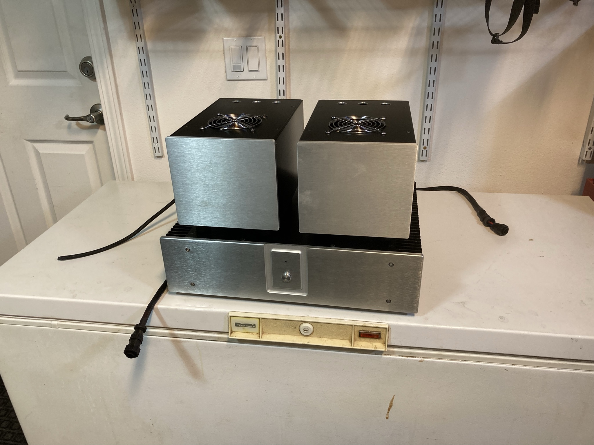

Very superb work there, Wirewiggler! You got the full SLB and SFP treatment in a separate chassis going on. That allows you to change amps later if you want. What are you using for power supply interconnect to the amp module?
Those were amp plugs in that picture and I could not get them to work with the 16 gauge silicone wire. I would have used the powercon ones you recommended but they were only available in 3 prong and I wanted 4 to include tying the chassis grounds to each other. I ended using a Uxcel 25A aviation plug from Amazon. I have been avoiding the 107 degree days hiding out in my place in the mountains. Will leave the wife here tomorrow and go home and move these into the living room and when she gets home beg for forgiveness. The plan moving forward is to build my power supplies into separate chassis, I am almost ready to place order with Sami for a pair of his SMPS and cap boards . Will place cap boards in amp chassis with sissysitR3 crossing fingers will not have start issues.

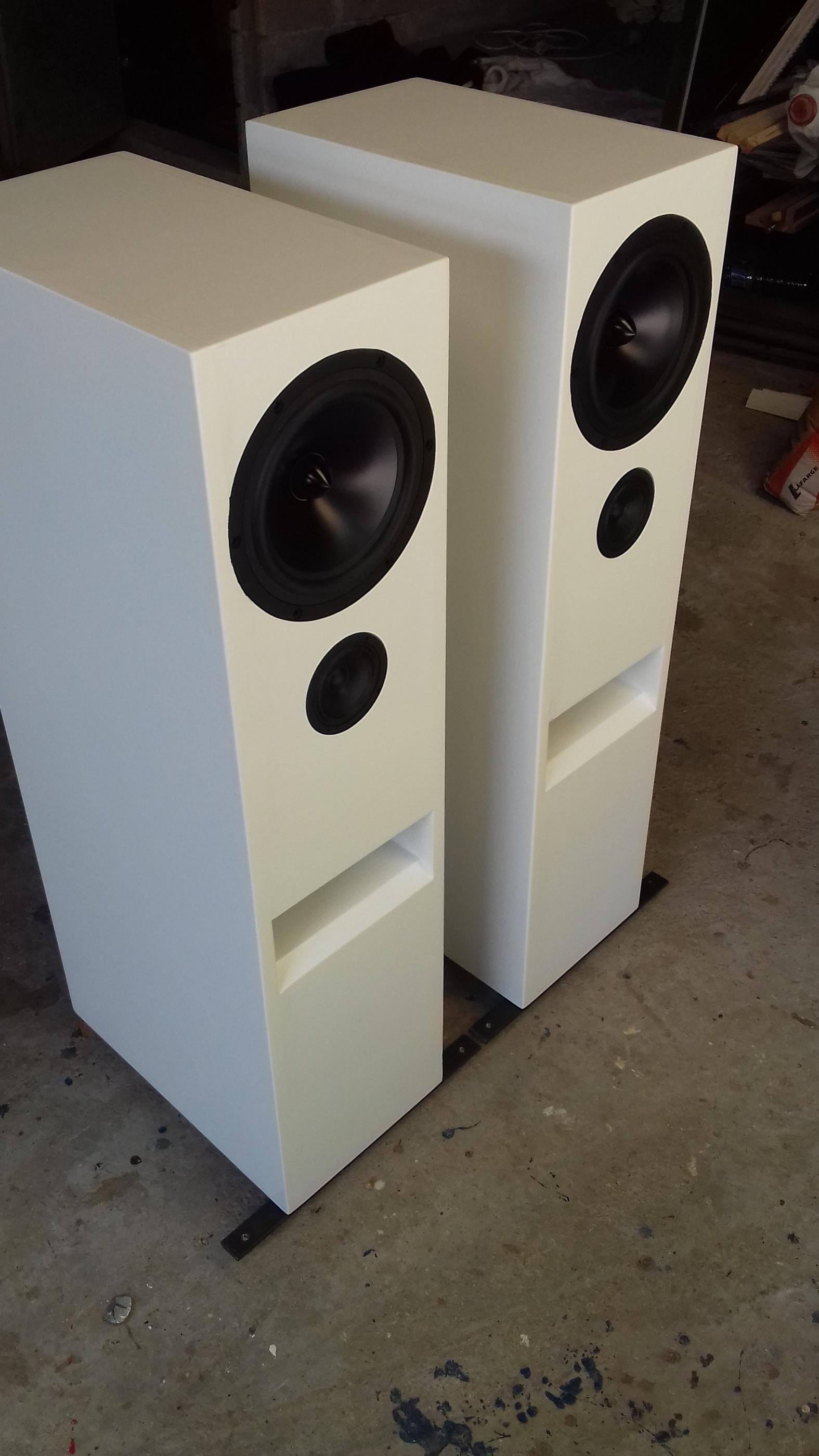

Are you interested in a DIY speaker that I can gurantee you, sounds superb? About $600 to $750 in parts and materials (depending on choice XO caps and wood finsih) if you make the TL cabinets yourself. I have heard a lot of speakers and these are up there with the top 3 I have heard.
The TL is the one that will beat most $12k to $15k speakers in sound quality with superb imaging, naturalness, deep bass, smooth midrange, and timing accuracy (being 1st order transient perfect XO).
10F/8424 & RS225-8 FAST / WAW Ref Monitor
Plans:
826339d1584679921-10f-8424-rs225-8-fast-waw-ref-monitor-rs225-tl-0-75inply-v2-jpg
XO:
656203d1515700364-10f-8424-rs225-8-fast-ref-monitor-xrk971-10f-rs225-fast-schematic-jpg
A modern implementation by Moutik:
956993d1622710562-10f-8424-rs225-8-fast-waw-ref-monitor-20210601_151535-jpg

Hi Bill,
Congratulations on your sweet pair of Alpha Nirvana monoblocks!! You did a great job neatly fitting everything required for forced cooling in a small sized chassis. The dual SLB psu unit rocks, Well done 😉
Enjoy your setup!!

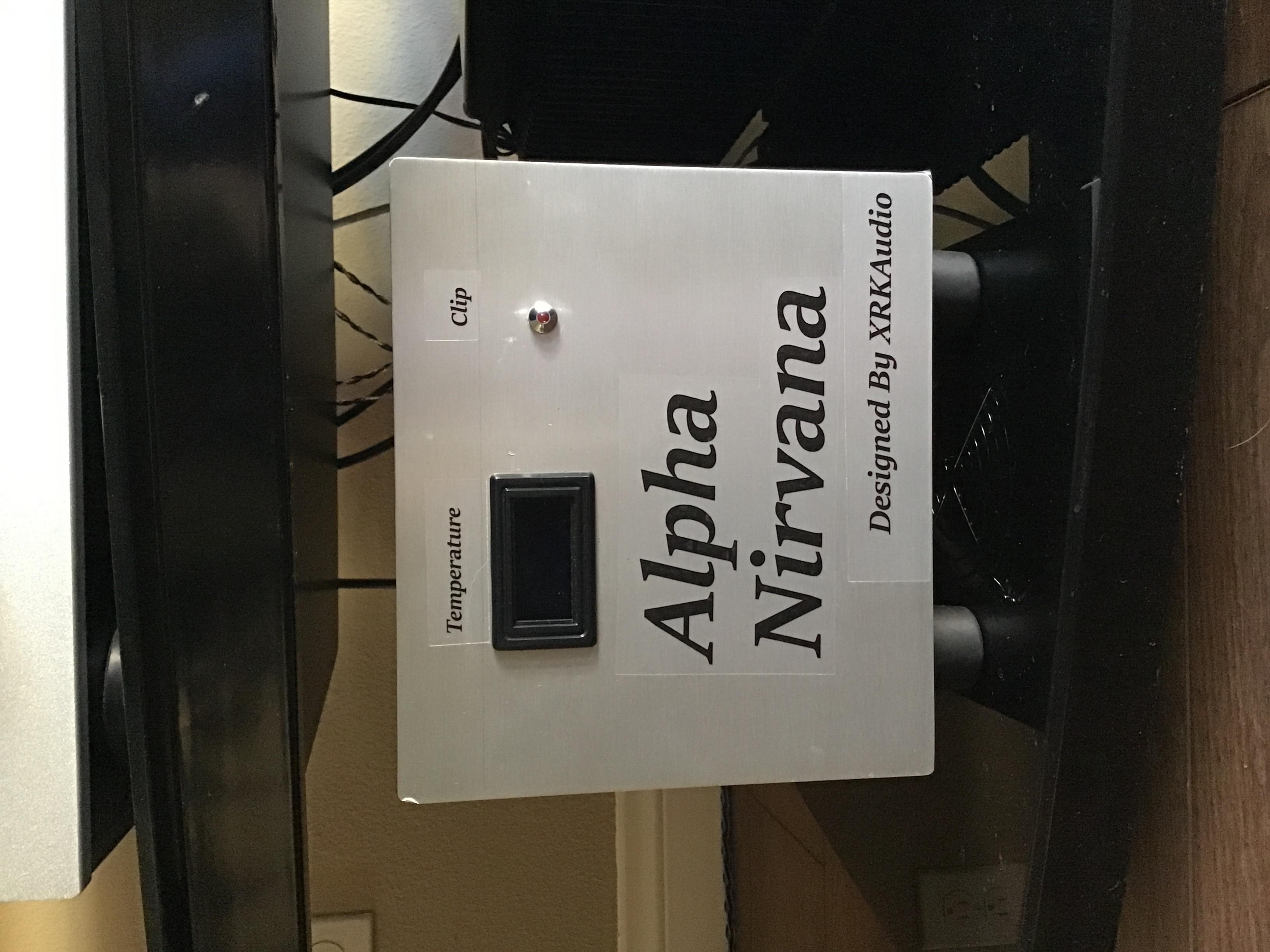

Here is a shot in my system. I tried the water slide decals printed on laser printer not real happy, I am just going to have to break down and do screen printing. X the fast system interest me wish I were closer to audition. Funny thing on my first listen the male vocals were off a hair but came pretty well after a little burn in time , the rest of the resolution was not lost by the amp but by my Dac. I played my new HiBy R6 and it was resolving vocal details much better. Wow I posted this picture 4 times 3 times it was upside down this one on its side I give up.

Hi Wirewiggler,
Here is the trick I use with photos taken on your phone. Take a screenshot of your photo (this shrinks the pixels down to a reasonable size). Use the crop and rotate tool to rotate the image properly right side up. Save it. Now post the image from your phone. It will be correct and properly scaled and sized circa 1200 pixels wide.
You can use a label maker to print the temp and clip light labels. Neat feature to have temp. Maybe have it tied to auto shutdown if exceeded?
