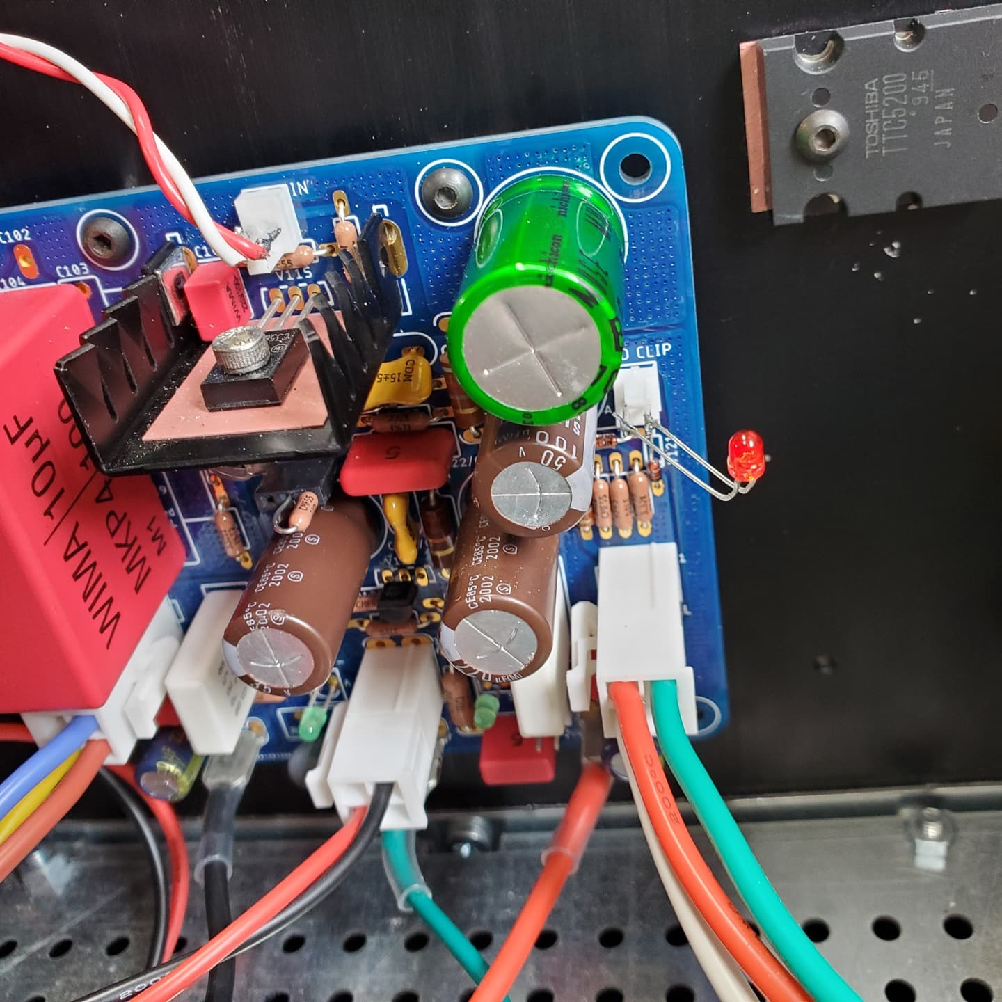

Well darn looks like i honestly have to say I no longer know what I'm doing.
I have a dual rail SMB running at 32v with a single AN.
On the output side low distorted audio and the large transistors stay cool to the touch.
let me know if someone can help.

It’s not biasing properly if the MOSFETs are cool. Please measure voltages at all transistor legs and redline the schematic. Take a photo and post here. That’s the best way for us to diagnose remotely. It’s like a full blood test and X-rays and vitals ordered by an emergency room physician when they don’t know what is causing a patient to be sick. It’s work to collect that, but worth it as the fault can be precisely pin pointed.
At minimum, voltages (with respect to GND) at all pins of output MOSFETs and across the source resistors. Generally when the amp is not biasing properly with the circa 1.3A current - a cold solder joint, loose connection, or incorrect resistor is loaded. Sometimes it is a bad electrolytic cap.
I can see nothing amiss, but I might miss something.......
You should use some heatshrink on all the wire/semi connections, particularly near the heatsinks.
I'd suggest you switch off, then trace all the wire from semis back to the intended point pcb; if your outputs are not producing heat it indicates either a connection is open OR the current sensor across base/emitter on the output resistors is miswired or even the wrong gender.
There is no easy to way fixing these issues and they happen even with seasoned pros. You can't see, smell or hear electricity, you need to check all the connections with a meter.

UP AND WORKING!!!!
I have a test 12in coaxial Wharfedale speaker thumping with high clarity.
I cleaned up some wiring and check the values of every single component.
I found a cold solder joint on the one of the legs on the KSA992.

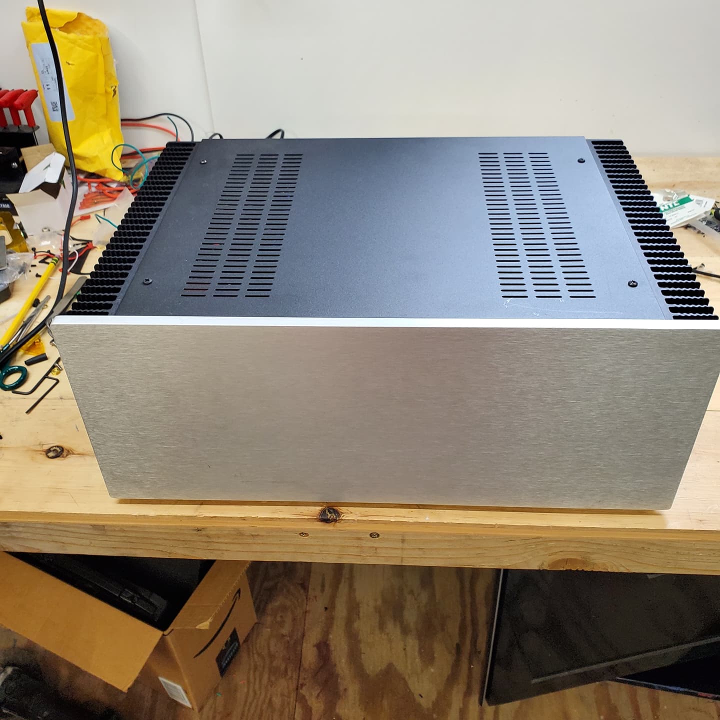

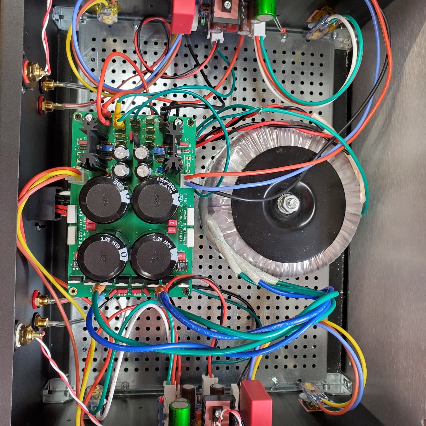

The amp is now 100% completed.
At the time of troubleshooting i did not want to power up both channels in hopes to minimize damage.
Yeah they sure do give off a good amount of heat but that's the price we pay for class A.... its worth it!
Id like to think of this as a simpler build.
I need to do some wire management (don't judge me to harshly)

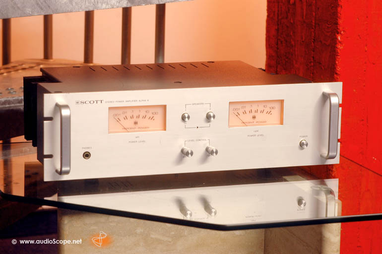

I'm toying with the idea of adding 2 VU meters and power switches for each side, something looking like the HH Scott alpha line.
sadly I haven't found any meters that have blown me away.

Ha, I have a pair of those vu meters, was going to put them in my Alpha Nirvana but just could not make them fit in my case.
What's the obsession with VU meters? 😕 The AN already incorporates a very useful red 'clip LED' in each channel. If this never flickers on when you're playing music ... you ain't clipping! 🙂 So who cares whether you're actually outputting 3w ... or 23w!
