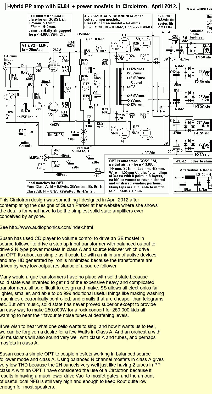

A very clever PP A Class
It is well biased and the constant current is a neat idea but, it does seem to run in Push Pull mode, and therefore not strictly SECA design.
A Neat idea.
I saw something similar in the early 1970, one done by Sir Clive Sinclair and a version by Linsey Hood,
The Mr Hood one was published in WW or PE.
Yes, PP Class A
Daanve, it is indeed push pull, but Class A of course because neither device turns off.
X can be given credit for the clever Hawksford Cascode which maintains constant voltage across the LU power jfet, and setting the bias with ground potential on the gate relies on depletion biasing of jfets, using the DCR of the dual inductor to achieve the 3A quiescent.
It really is a new version of an old idea and proposed on this forum with Susan Parker a long time ago. She did a beautiful amplfier with an absurd low parts count.
HD
Susan Parker - Patrick Turner
And don't forget the late Aussie Patrick Turner:
