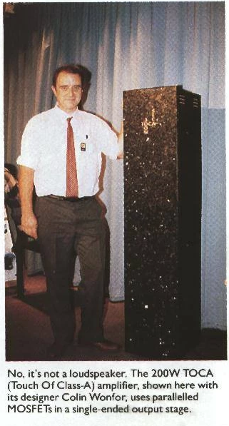

On the subject of high power Class A amps, some years back Colin Wonfer designed and built a 300 wpc pure SE Class A amp. You can find pictures of it on internet - its a tower a metre or more high. Colin is a remarkable man and I’m privileged to own his M100TS amp. It is the best amp I’ve ever heard.
Looks like that amp caught fire 😀
Well I believe it broke the local electricity Grid when Colin turned it on😀. The face plate was granite I think, hence the unusual appearance. The caption says 200w but to the best of my knowledge it was 300wpc.
