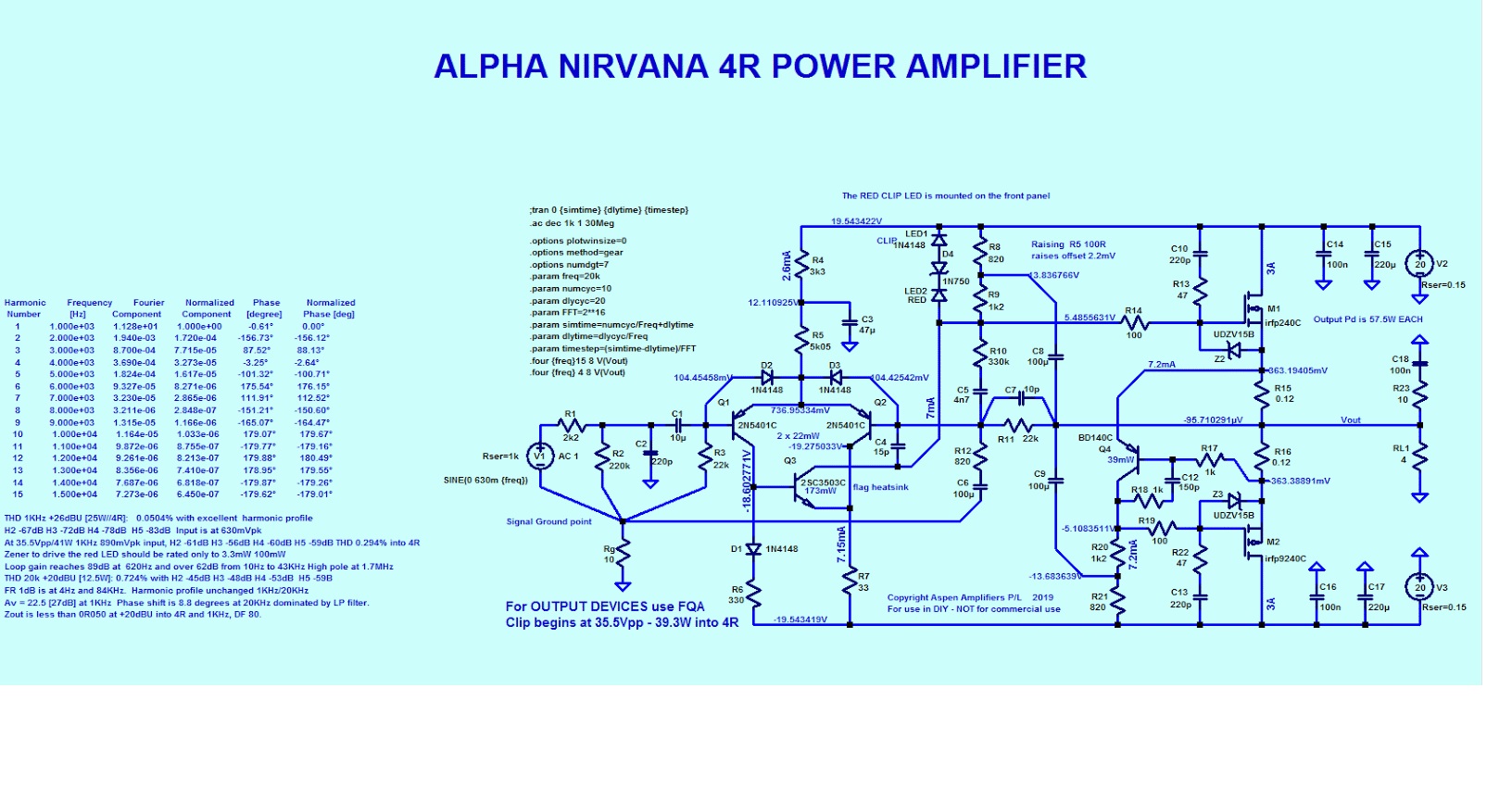

On the amp schematic, V131 emitter is connected to Drain of V141 through R136 (4R7), but on Hugh 4 Ohms schematic, this resistor seems to be omitted. Should I put it on the PCB or jumper it for the 4 Ohms version?

If you refer to a component number please post the schematic with it. I don’t have these things memorized. 🙂

Here it is

It appears to be optional. I’ll let Hugh answer but 4.7ohms and plain wire is about the same for small signal stuff?
No requirement for R136 Do. R17, R18 and C12 ensure that the sensing transistor is well damped and will not oscillate.
That 4.7r resistor was further insurance that the transistor (which is selected for slow speed) would not oscillate with signal.

Sorry - have only just seen this.
If you look at the s/sheet I sent you, you will see that, yes, R136 on the AN 8R schematic does not appear on Hugh's AN 4R schematic. That's why there's a '-' in Col B.
On Hugh's advice, I included this resistor ... as there is space for it on the PCB.
