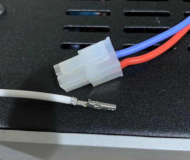

Wurth and Molex Minifit 4 pin are interchangeable. When properly crimped, they are a very reliable and easy to disconnect/reconnect option.
This is what a good crimp looks like (the wire is wrapped evenly and tightly with the metal pinch band, the wire part is tightly crimped with a cold weld.
Hi X,
I appreciate a good example of a properly crimped Molex connector. However, the problem for occasional users like myself is that there are too many types of these connectors and housings to know what to use, UNLESS the parts are explicitly indicated by designers/PCB makers.
I have carefully watched and read this thread in order to build Hugh’s Alpha Nirvana design, but after all this I’m still not sure that I have the right connectors and housings, as well as the right crimp tools to make it happen.

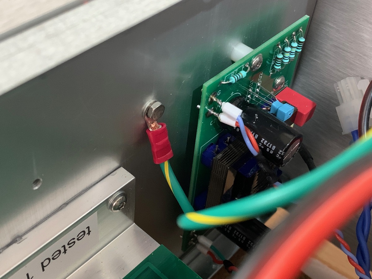

Hi WW,
Glad you are getting the hang of crimped connectors. That’s why in automotive applications, solder is not allowed on connectors. It turns a flexible wire into a stiff solid wire due to the solder wicking into the wire.
If you must solder a wire to a PCB, use a pin crimp tube to isolate the wire from the solder joint and this provides strain relief.
Like this:
Like this:
