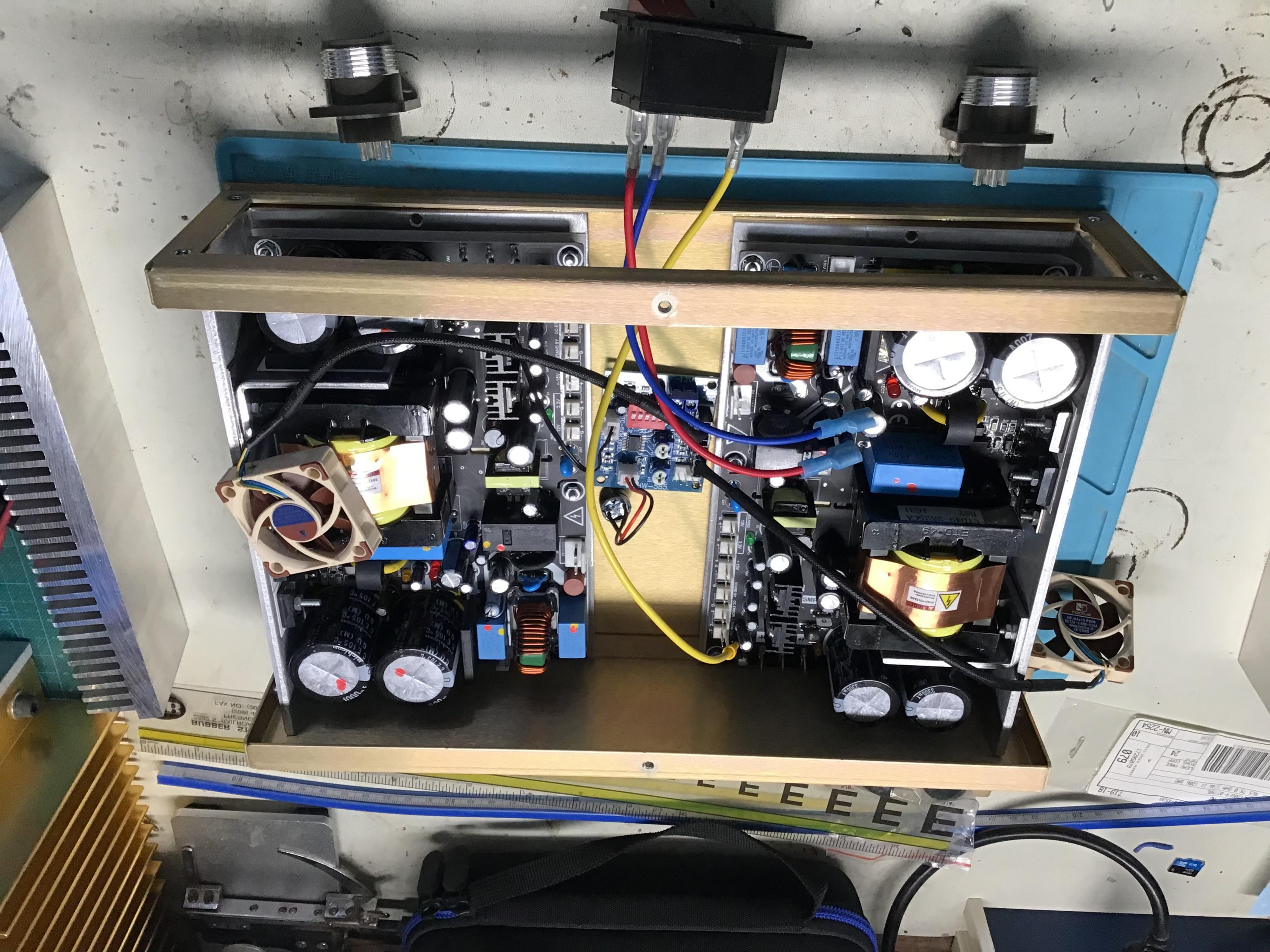

X, those cases look look pretty sweet, are you going to try and squeeze a power supply in with those? For my next project I will be putting a sit and mosfet on this, and this power supply.
Vunce,

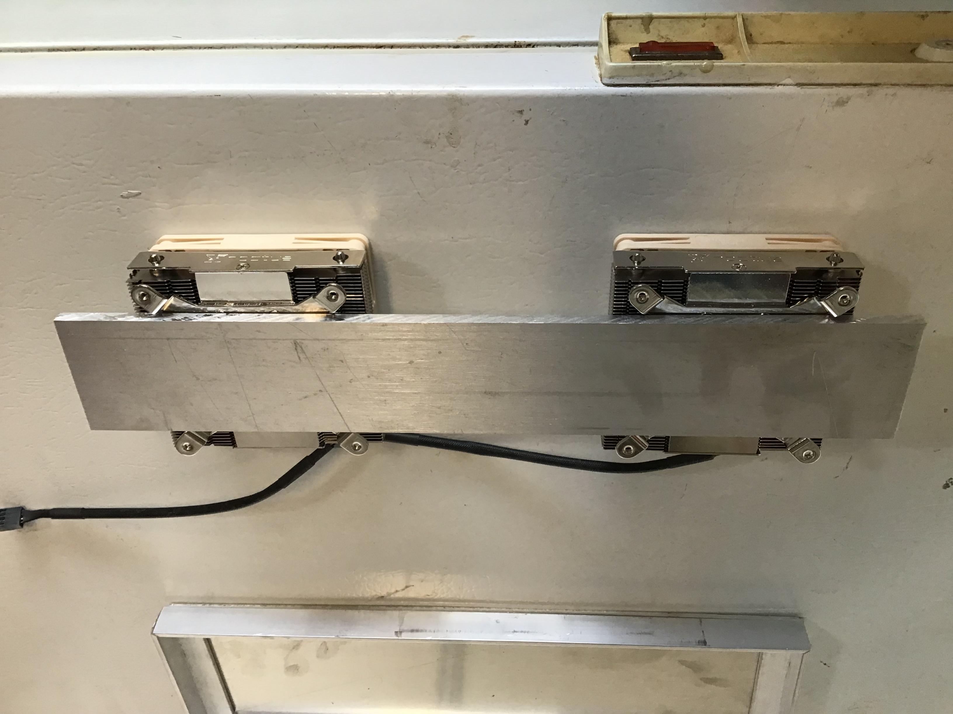

Thanks, this case and my Yarra preamp will be hand made with wood to match. The front panel will be machined from aluminum anodized red, with a headphone amp to match. X that is a par metal case, I cut those heat sinks down to fit in as well but it is so tight I think airflow would be so restricted, probably the thick frame Sami uses is plenty good. I wish he would put more holes in it.
Bill
Vunce,
Bill
In the future, there will be a nice black heatsink with holes underneath the heatsink for mounting.
Also, a future model will be a little bit bigger carrying 2 * 10000uF capacitors onboard
You don't need that much of airflow into your chassis, just low speed fan on top of the power devices to cool down the transformer mainly
Thanks!
Sami,
Nice to hear from you, they are some sweet looking power supplies. With them being in there own case I am glad the extra caps will be in the amp case. Now with a set of one linear (X’s SMLB) and this SMPS in their own cases I am done building power supplies for a while.
Bill
