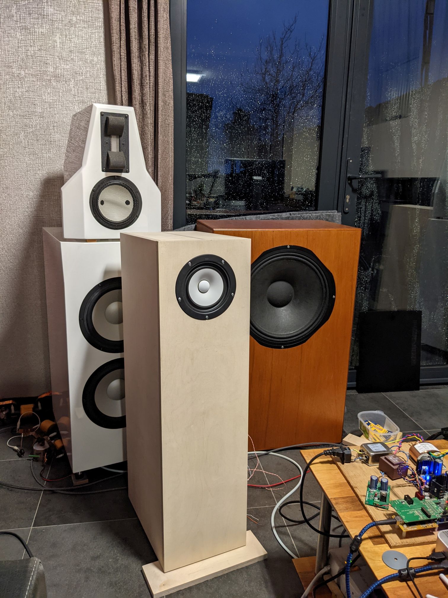

maybe i'm the only one who is listening van halen concerts on this driver in out- of-optimum box 60 liter, but i can say that is very enjoyable session, guitars and drums(snare) are so realistic and good!
They are still there but disconnected😉Very nice! Are the tweeters on top activated, or is it just there but disconnected?
I am enjoying them in these boxes until I pulled the trigger on a diy design (folded Water buffalo or tbd).
David between the Goliaths

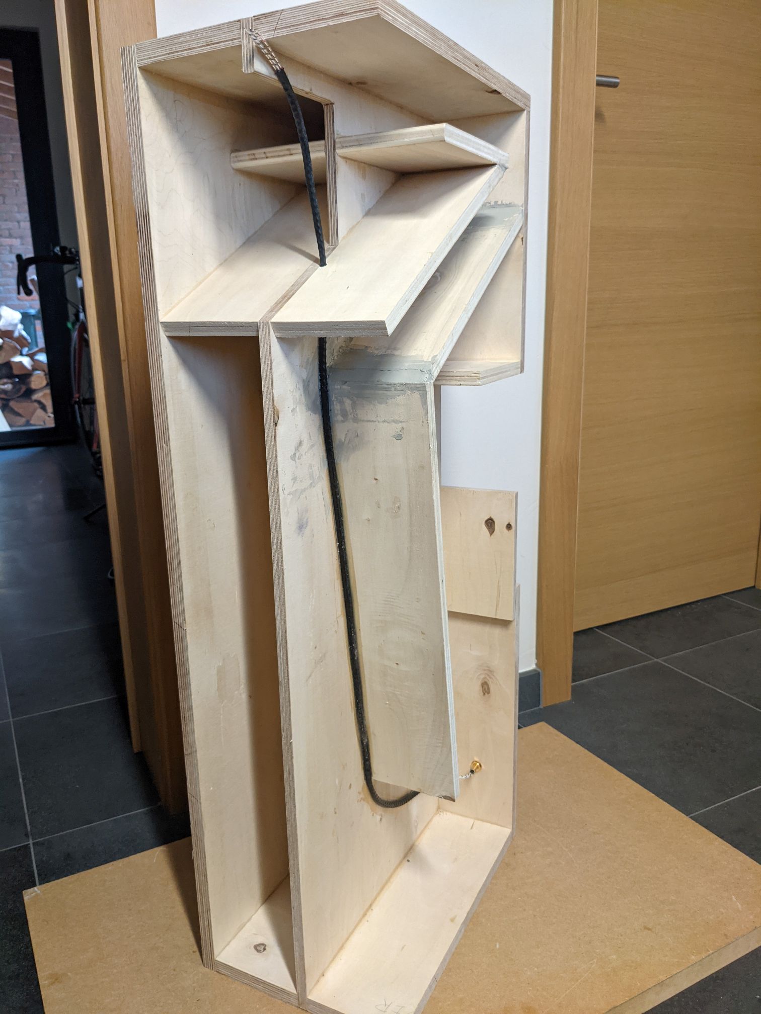

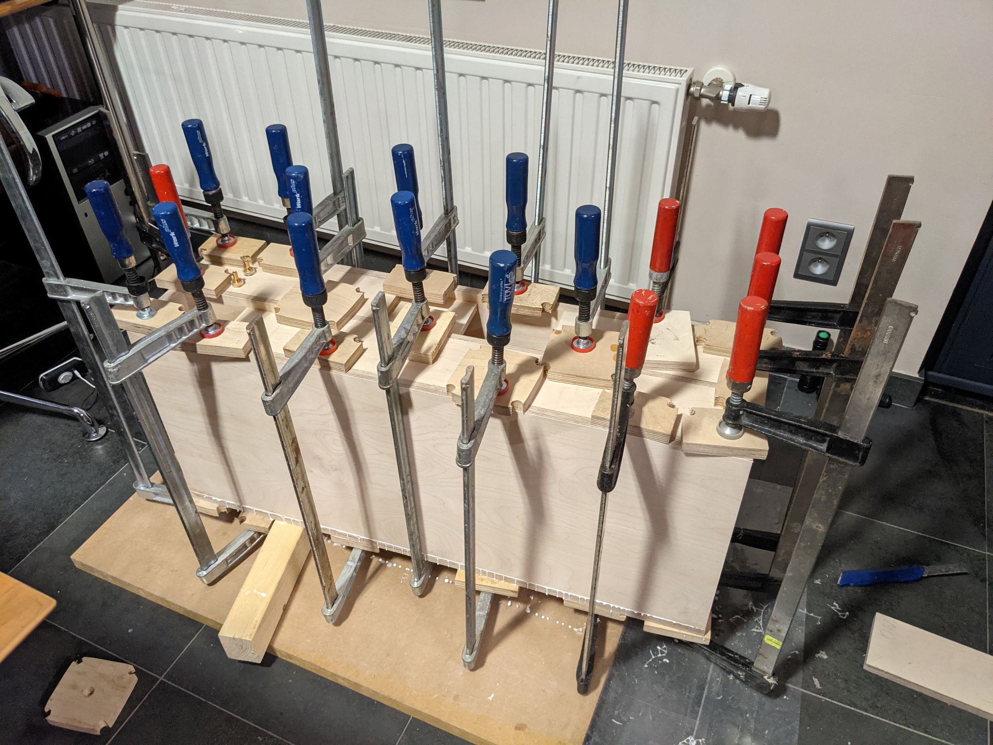

I just finished the built of the cabinets for the MAOP11.2 last weekend.
Now they're playing and they sound very good.
The bass on the cabinets turned out very good, a big plus for these SDDBH-T15.5R-AD cabinets is that you can tune the horn mouths with moveable ports.
Since there is no crossover to tweak, you do have the ports 🙂
Also some experimentation with damping materials in the chamber behind the driver needs be done.
So far I like them 🙂

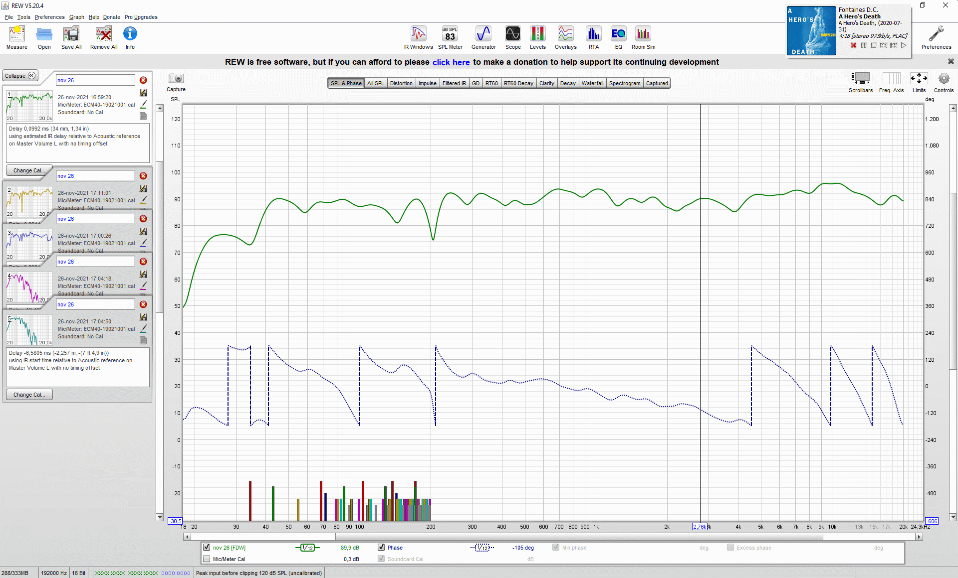

Here are some measurement at 0° and 30°
it's quite remarkable that such a small single driver can do the 40-20k this good
thanks danny_66 for measurements,
fantastic response for one driver!
need to remove some dB's from 600- 1kHz to be perfect line, i still didnt measure mine but ill do
Yes, I think I can remove those dbs by adding some damping material (basotect) in the chamber and making the port openings a little smaller
