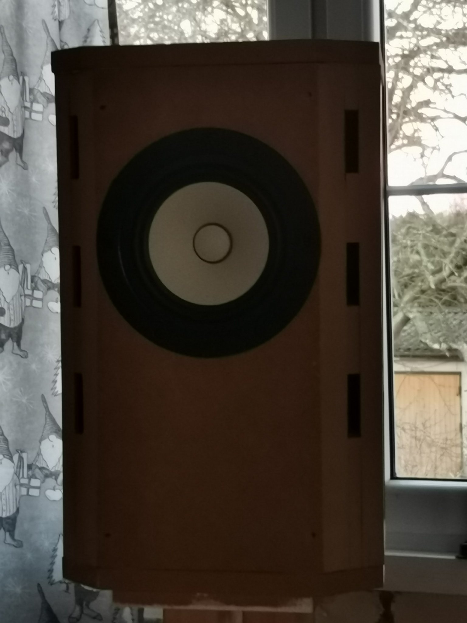

@LeifB60
you have made it in mdf?
@Vix
it make change the filter no? and the box no?
have you the maop10?

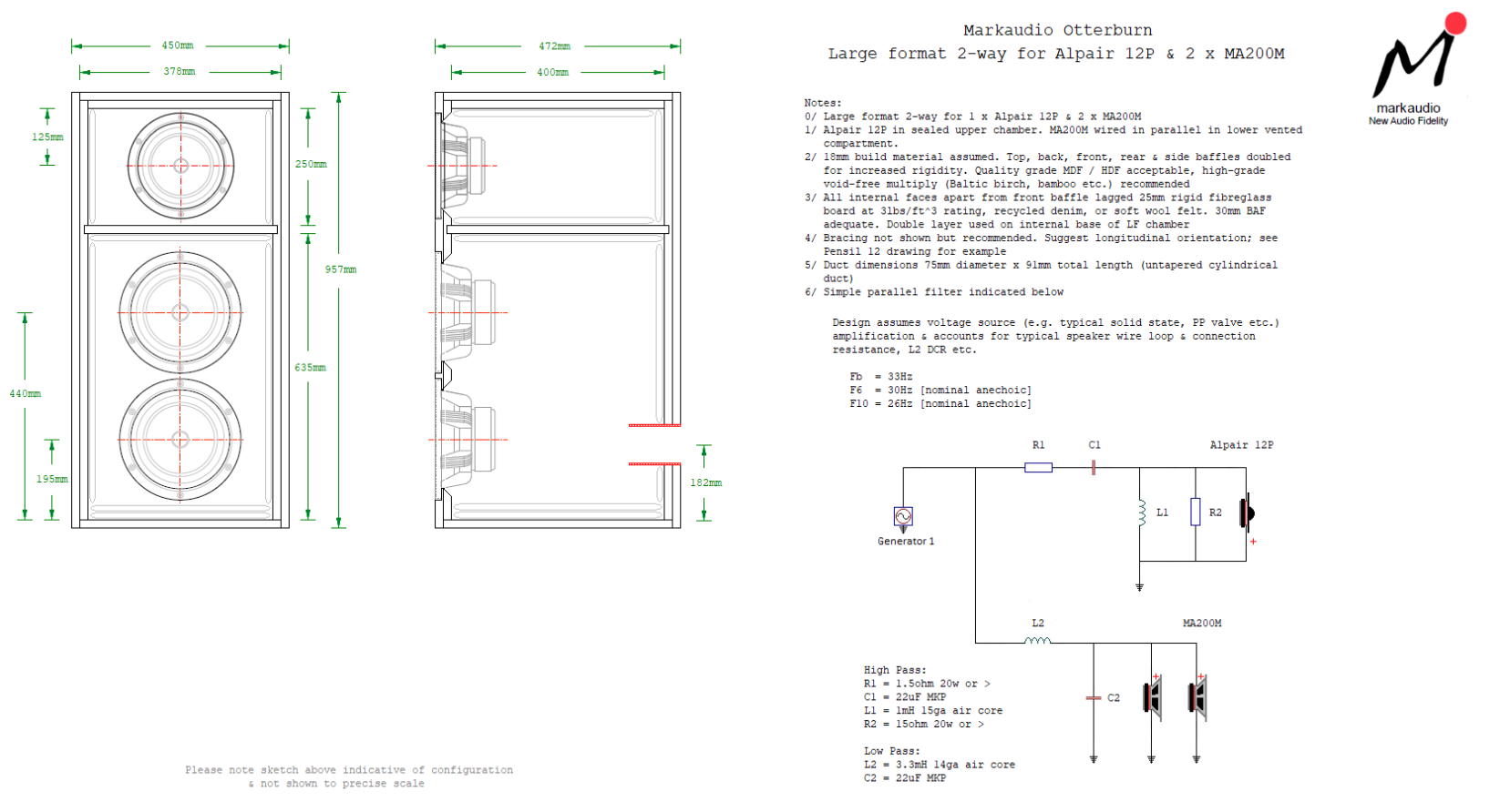

Yes, filter will probably need to be changed. If you really decide to do this (meaning that you will have to buy 4 MA200 driivers, so not the cheapest option) maybe Scott will design you a new filter. The lower part will most probably be the same, the upper one, not so different I guess.
I don't have the maop 10, but I have the Alpair 10.3. I experimented with it, fullrange, as a Waw..etc. That said, there is always a beauty in running it fullrange, but then...
If you want clean bass in sufficient quantities, better run separate woofers. One is good, a pair is better. Once relieved of the low notes bass, every fullrange driver will sound better, cleaner...
But, it is a bit more complex to build and more expensive.
So, no free lunch...
