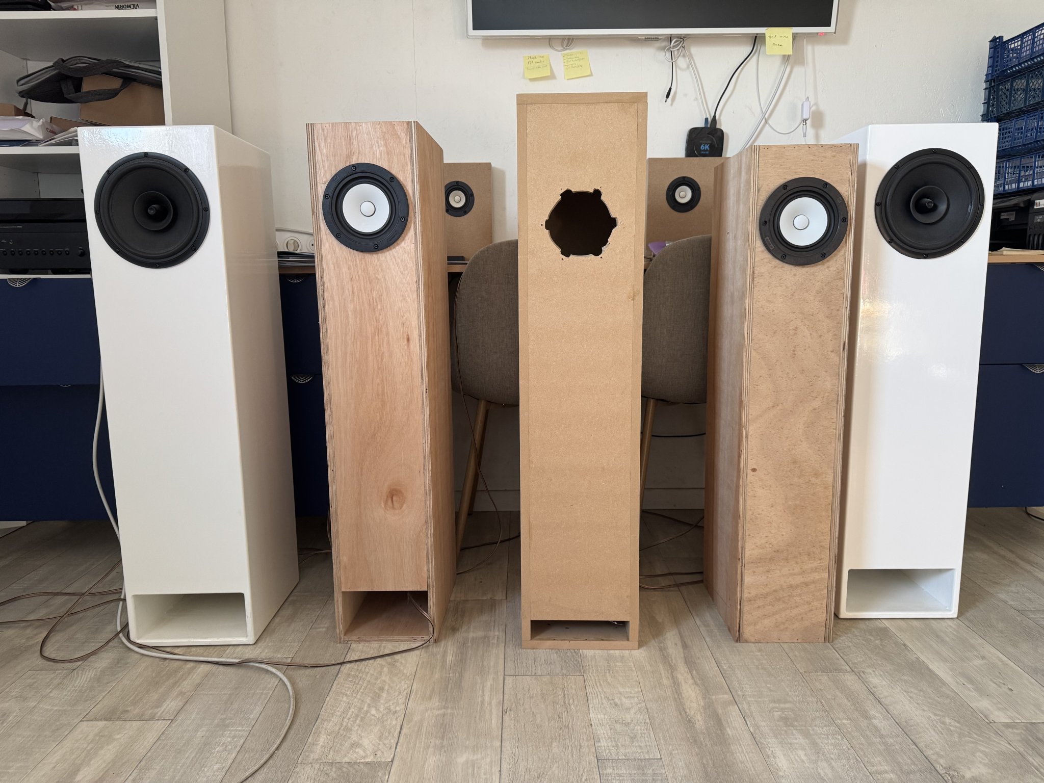

It's not the speaker that disappoints me.
i can feel that maop10is much acurate than the others I have (chr70, chn-50p, sb20) but I think that the boxes I built: pensil, DDVP-15
TWTD-13.5. I have the impression that the search for the lowest possible low-frequency cutoff disturbs the overall response of the speaker.
Frugel horn xl is not possible for me due placement contraint.
I'm wondering today if there are boxes that have a more precise sound rendering, a better definition, "a better 3D effect" even if it means sacrificing a little low frequencies response. In any case, I was thinking of using a subwoofer.
The speaker does almost everything well, but making it go too low makes it "neglect" the rest. It may be that I am becoming too demanding with age... 😉or that I have also taken the time to build several boxes for a single speaker to see these differences

By the way, we'd like to see some of the boxes that you built. Don't be shy if they are not so beautiful and shiny; I built some really ugly (but working) creations 😀

Here is a quick photo, there are functional but not aesthetic achievements.

Nice builds!there are functional but not aesthetic achievements.
Not sure what effect this might have on the bass reproduction and such, but looks like possibly low number of plys in wood and some voids… resonance? Leaks? Then of course there’s room size, shape and placement. And of course, the amplifier and source. So many variables when it comes to bass. I’m sure you’re already aware of these things given your prolific building…likely you are more knowledgeable than I am, but worth a mention. Always good to look at the fundamentals before moving on to entirely new designs.
