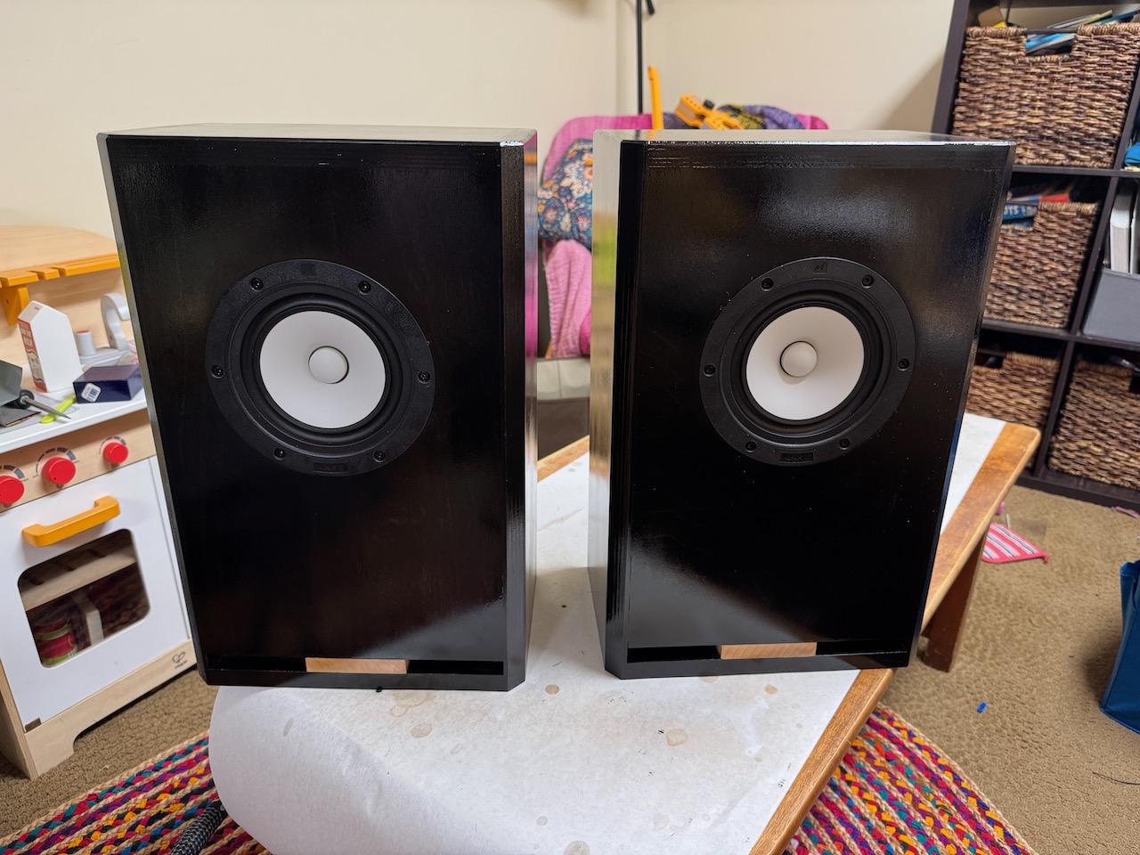

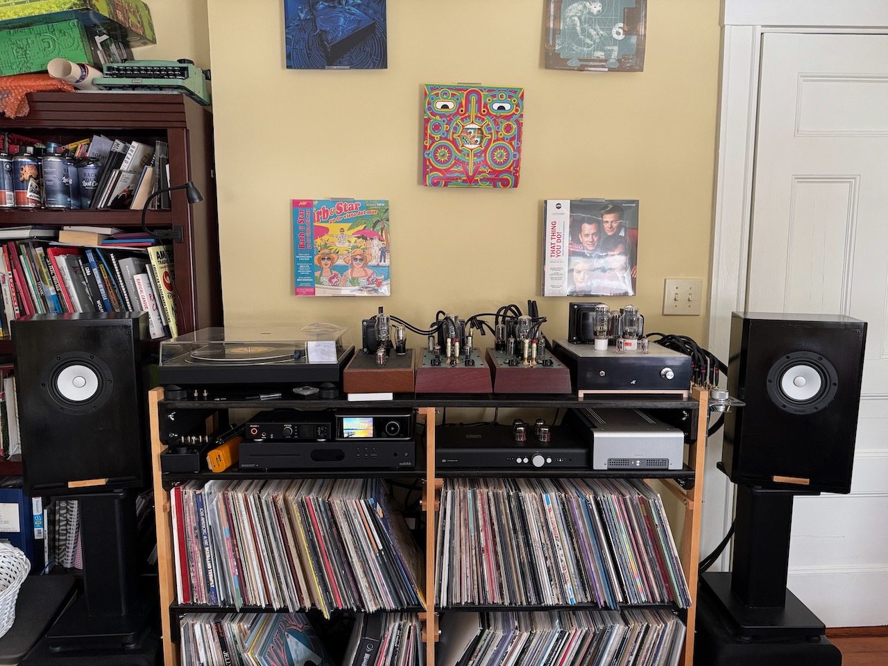

I finally finished! I had to do the finish in my basement in less-than-ideal conditions so it's not my best work (shellac over ebony stain, I wanted the stain lighter and to do the shellac better, but it is what it is, I redid it once, didn't have it in me to redo it again... I bought these drivers in September... 2021, so at this point I just needed them done). On the plus side, they sound fantastic! I had built a simple reflex box with a pair of the regular Alpair 10.2, the MAOP in the Classic Golden Ratio Mar-ken is a definite step up. Thanks everyone for the questions answered/advice!Thanks so much, really helpful! I'll be sure to post some pictures when I'm done!
