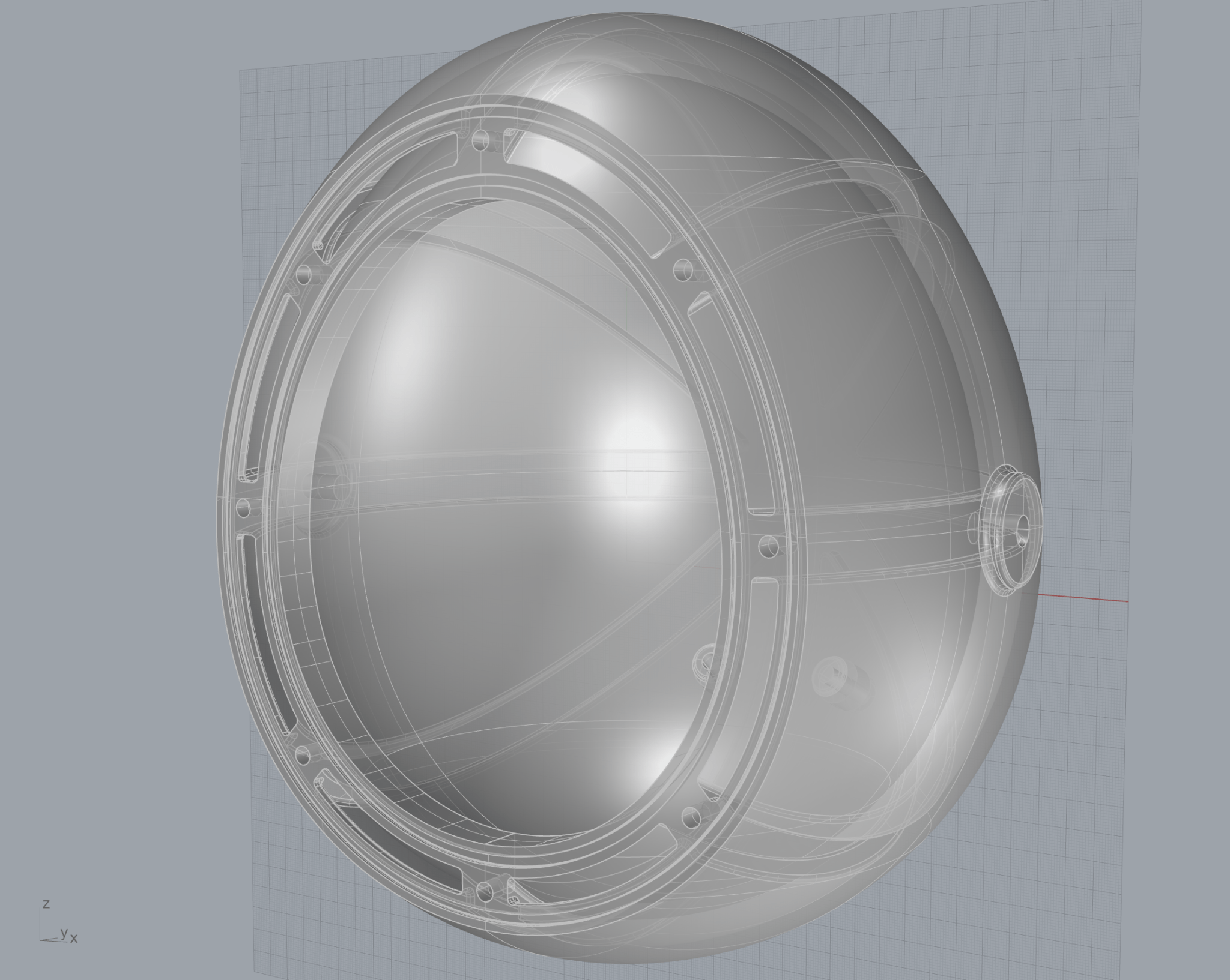

1) Double shell enclosure (3D printed with carbon reinforced plastic) joined by internal ribs with cavities to be filled with composite in epoxy resin and fiberglass. The 3D printing possibility are truly amazing.

Your image is a render? How big is it?
dave
Yes, it is a shaded view of the model in the 3D modeling software I am using. I am waiting for the holidays to start the 3D printing of the enclosures. With my printer it will take about 8/9 days for the two housings. The front baffle will be made of layers of solid olive wood reinforced inside by layers of fiberglass. The dimensions are about 36x30cm for an internal volume of about 12l. The cavity will be filled with epoxy resin thickened with glass microspheres to reinforce the container as much as possible. I was not aware of the Apple project, it all started from scratch. Below I've attached a true rendering of the project, initially designed for an alpair 11MS (as depicted in the rendering) and then switched to a MAOP 10.2.

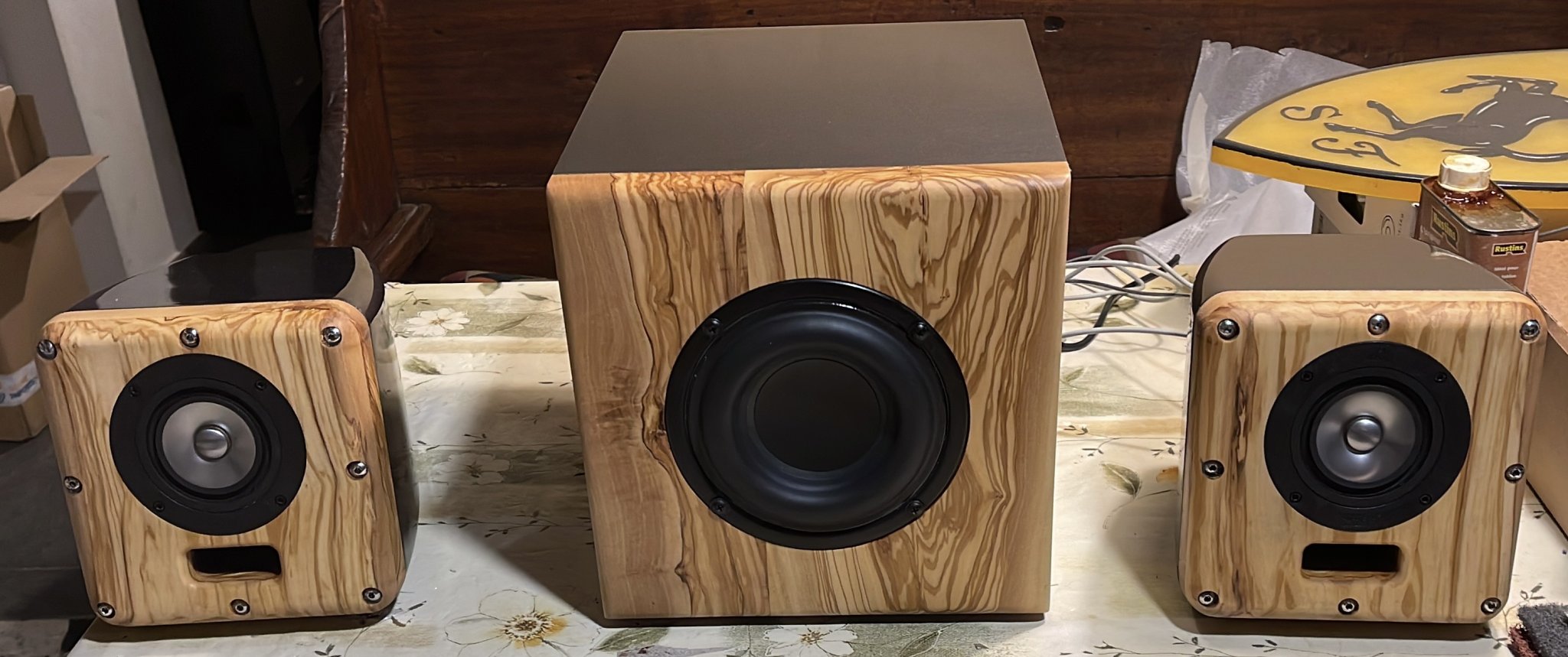

This is my previous project using the alpair 5.3 in two 3D printed satellite speakers accompanied by a passive reflex subwoofer using a TB W5-1138SW sub and it sounds incredible for its size! I have already built 3 of these and another 2 are almost ready to be assembled.
