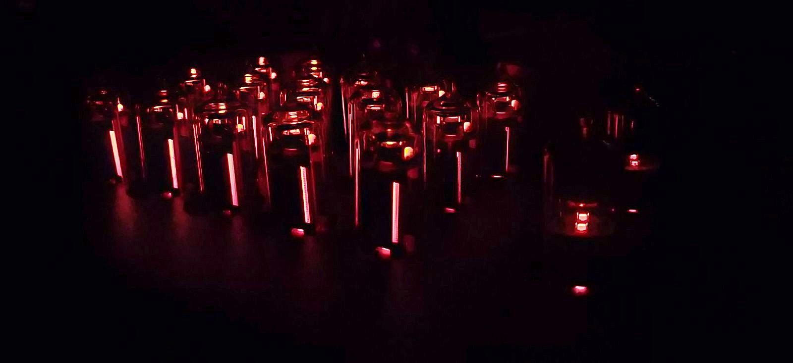

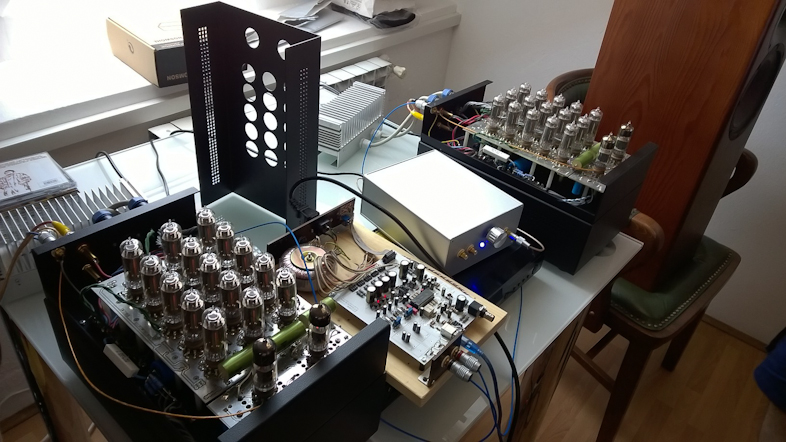

upgraded amplification to OTL with 34 tubes ,
1MHz of bandwidth, single ended ( single ended, with 15 parallel output tubes), class A..
I started construction in 2011 and I finished 2015 (very long story) 😀
using it only in special occasions like this one.
now this driver absolutely shines, pure magic
hehe it is a nice heater! in front there is a wall of heat! + electric consumption is like a boiler! 😀
but waf factor is stretched to the limit and i would need to return it to the conservation, build smaller amp . but for the experience, this is it, squezed tube currents directly to the speaker, wining formula.
i will see if VFET will sound similar.....

OTLs have big potential, but one is trading brute force vrs a set of OPTs. And they have strange (as in different from usual) and typically increase power as impedance increases like a current amp, but maker stalk about a reasonably high damping (ie low Rout) which is not a charateristic of a current amp.
So speaker matching might get a bit tricky, and done in the field. I expect., like a current amp, a flattish impedance is desirable (largely the case with a good FR).
