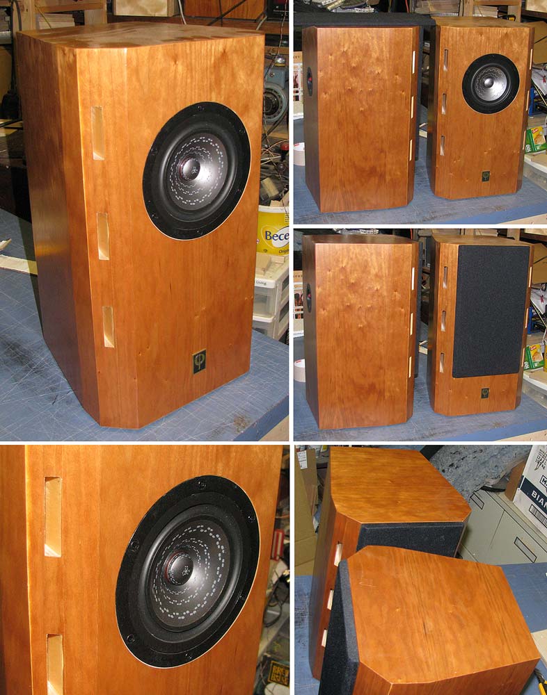

Now I have installed A10.2 Maop in my new boxes. Dave's construction mini Onken. About 11 liters with 3 channels per side.
Dire Strait "Brothers in arms" became the first CD to testing these.
The elements are completely new. No recording of drivers at all.
Here is my first listening impression:
There is nothing to complain about when it comes to the sound.
1. The bass is good. Detailed.
2. Intermediate register good. Detailed. Silksren.
3. Treble good. Silksren.
If I compare with A11MS, everything is better ..
More pleasant to listen to throughout the register.
They need to be recorded for a while, I think. But I do not know if it is needed. They sound great from the start. I do not know how much the construction of the boxes affects but the bass is very well articulated.
Thanks Dave !!!
Brilliant job.
I will come back when I have "recorded" them more.
Regards / Leif
Can you elaborate what you mean by this? Also, what kind of amplification are you using? Thanks!
Quote:
Look on picture on side 3.
I have a tube amplifier.
