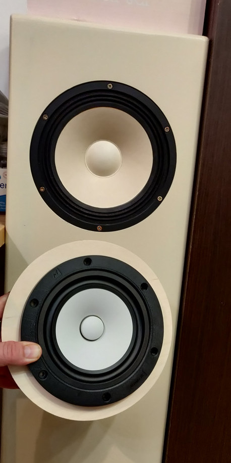

Getitng the woofer to bleand with the FR is sometimes the hardest part… and 1 woofer and 2 sts means you have to get a certain extention out of the bookshelves. And against the wall one needs to be concerned with how the box rects to th eclose proimity of the wall… given that means making sure the bass response has a smooth, steady, fairly slow roll-off.

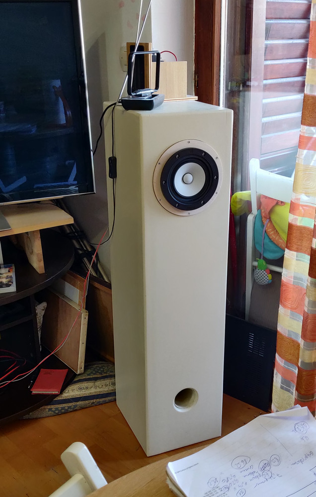

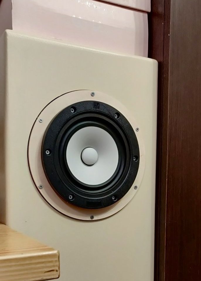

MAOP 10.2 mounted in BR 60 liter (previously used with Sonido alnico driver),
today is the first day of powering on, after 14 hours of normal and very loud listening just before the clipping (i dont care for this nonsense about 100000 hours of break-in, speaker is made for playing the music) , my impressions
- bass is so strong, speaker is delivering too much of bass, i never have in my life this situation with fullrange 😀 i will modify the box to reduce the bass output, maybe i will transfer to MLTL.. i need to do some calc...
- middle and treble are normal, no fatigue there, very relaxed presentation
- speaker is deliver soo good loud music that this is unbeleivable for small driver, you can make night club atmosphere in the room, full of quality bass and there is no fatiguing distortions on loud levels
- speaker is playing good rock, hard rock, jazz, blues, techno with the same quality , only on electronic music on some kind of sintetic bass (dub) bass is very plastic, enhanced in wrong way, but this is due to my box i believe so not a critic actually
- imaging is great , 3D is present
minus for the moment is that i would like some freshness in the sound, total balance is in the bass side, so sound is too relaxed, i need 10 percent more highs and this would fit better.. maybe when i cut some bass, top side will be more balanced..
for the first day, great performance, and potential!
The driver is not designed to be broken in this way. It will never reach its potential now. It ia likw you say you took your brand new car and ran it aat close to reline for 14 startigh hours (ignoring that you would run out of gas)
your box is not a reflex, it is an ML-TL already (whether designed that way or not)
dave
i have cca 30+ speakers at home, mixed hi-fi/ guitar.. good speaker is good from the start, after 10-50h.. only in MA is stated 100.000hours for break -in, and silent music which is in opposite with the break in process IMO 😀. bad speaker will never sound good like in Alpair 12 case.The driver is not designed to be broken in this way. It will never reach its potential now. It ia likw you say you took your brand new car and ran it aat close to reline for 14 startigh hours (ignoring that you would run out of gas)
dave
box is BR calculation from official Sonido site tuned 40 Hz for Sonido driver.. now i need to remove all the damping and do the process again..
