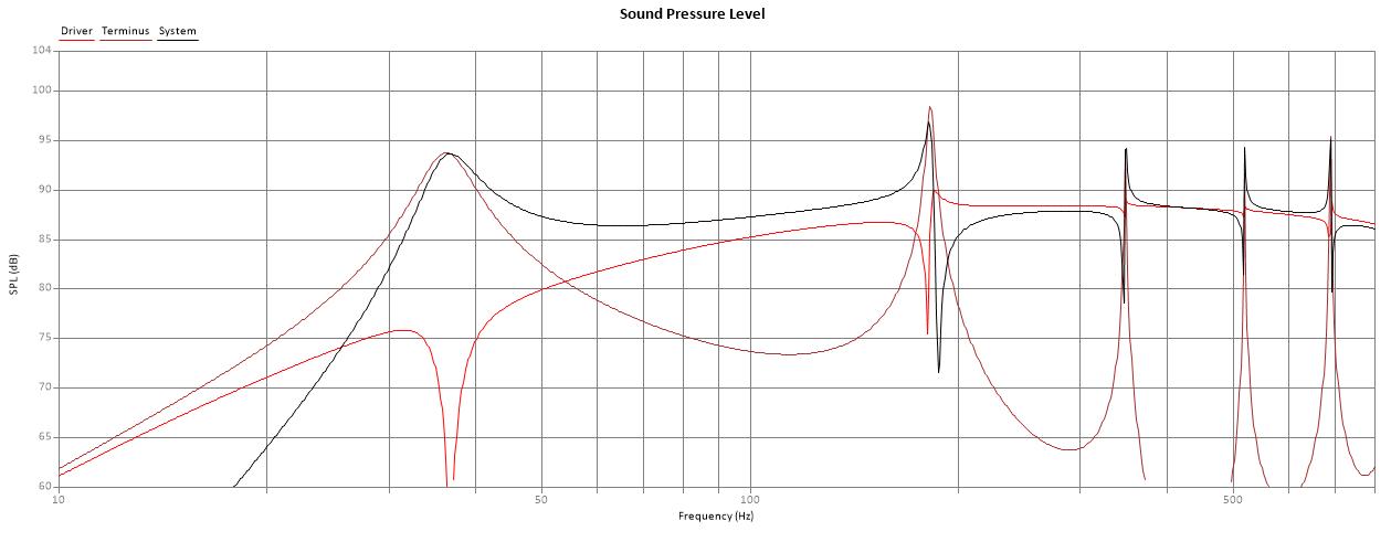

maybe is useful for the others,

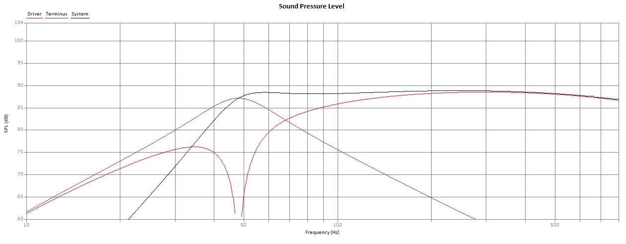

here is sim for 65 liter box where i have driver mounted, / the previous page, 65lit , port size fi 7cm 8cm long, internal height of the box is 99cm (it is a box for Sonido driver actually), volume is too big for this driver and it is seen bass boost what im hearing ..
and second picture sim is what would be the next box for Maop 10.2, 16 liter BR box (port fi 5cm x16cm long ), looks more linear..
next week i will transfer the driver to it and have some listening session 🙂
also i have in plan to build two special amplifiers for this driver.. VFET S.E. 16W and PP EL34 for ensure some fun in the next couple of years 🙂

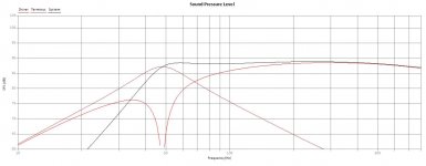

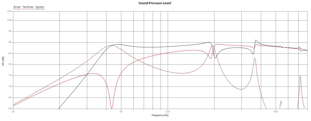

back to topic, here is interesting sim for the MLTL MAOP 10.2
99 cm internal height remain, but now half volume- 28 liter,
port dimensions fi 5cm x 6.5 cm (length) gives some extension below 40 Hz
That is not a good looking alignment. I don’t like the sway-backed bit just before roll-off.
dave
dave

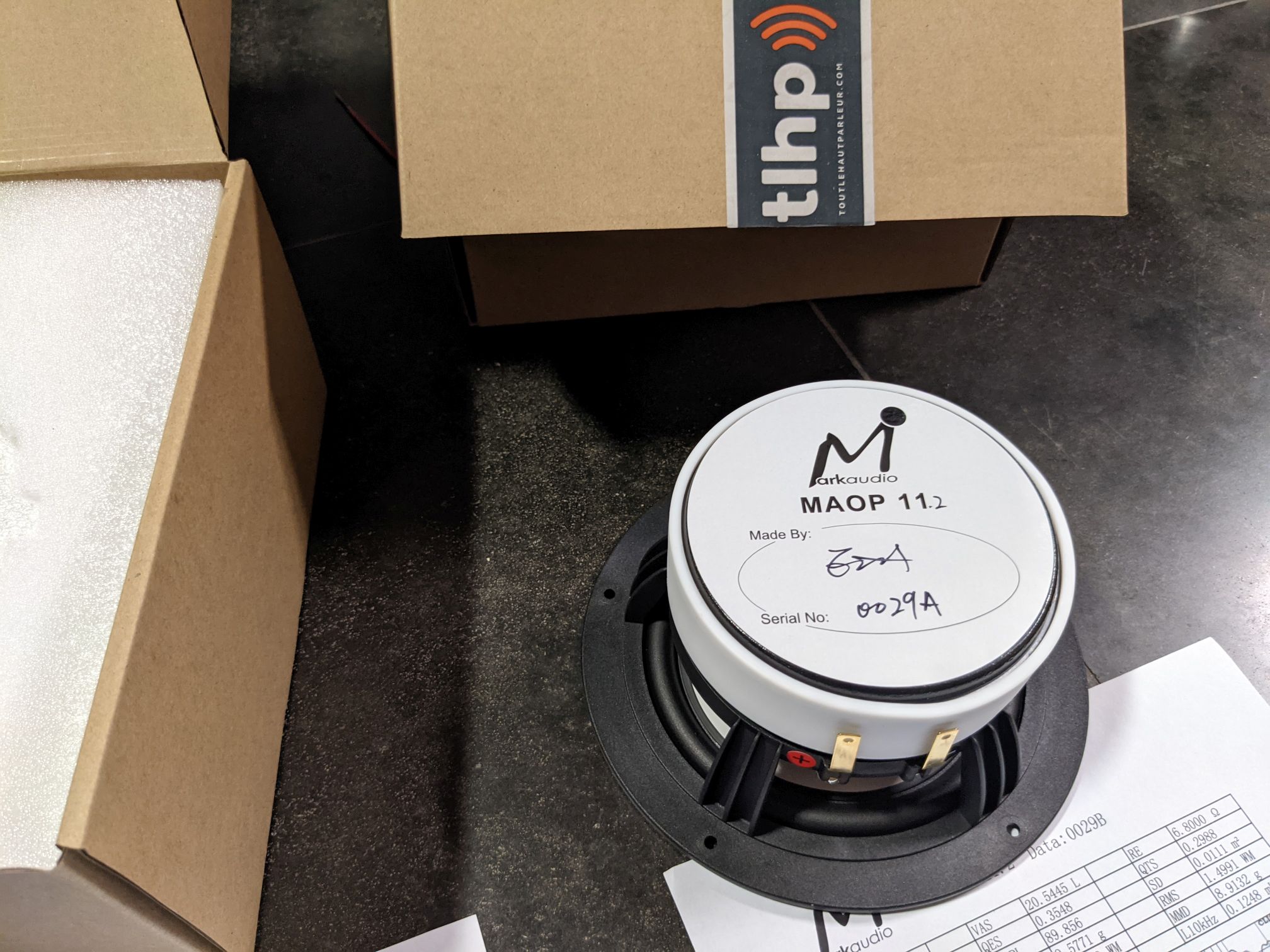

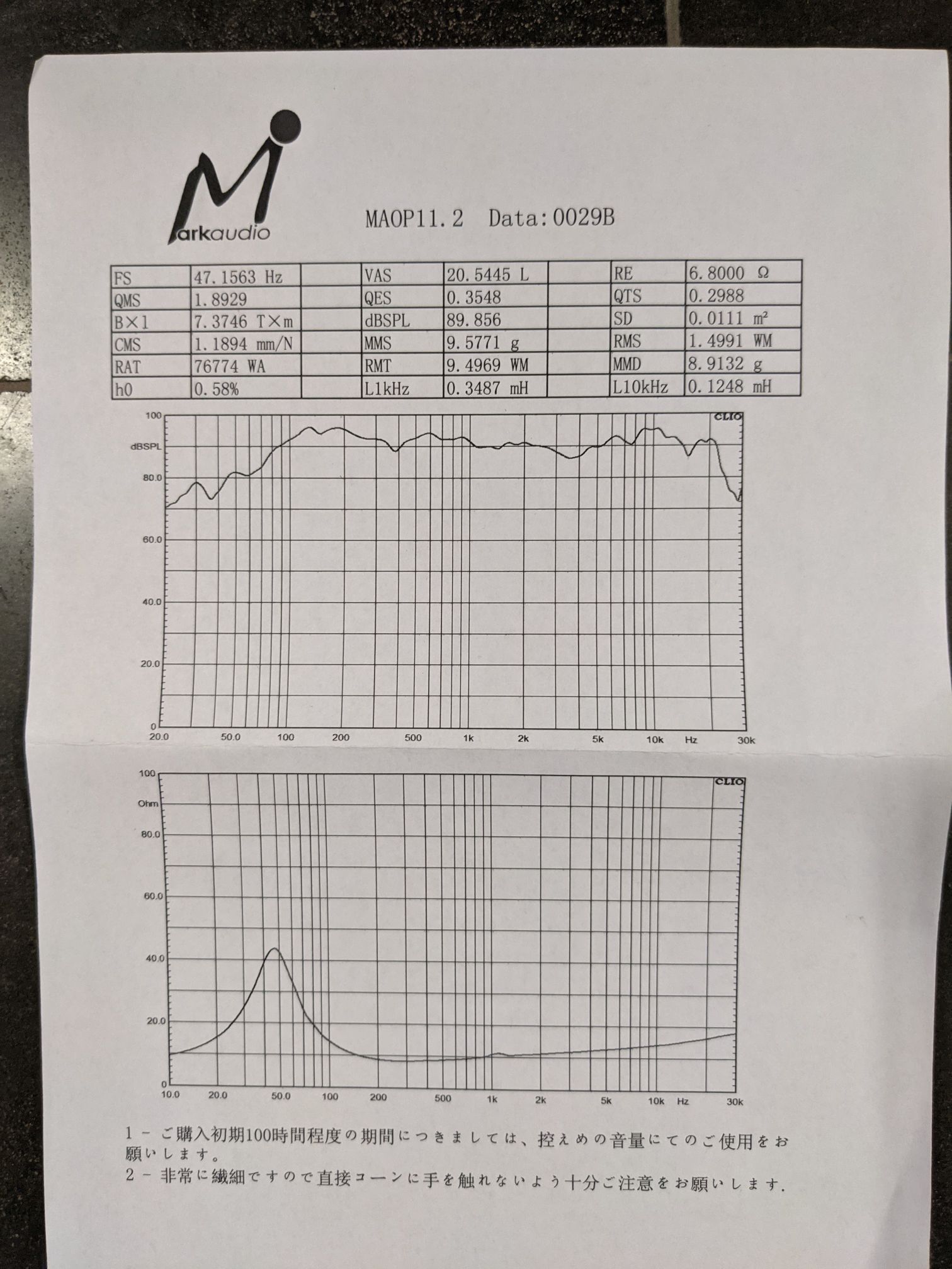

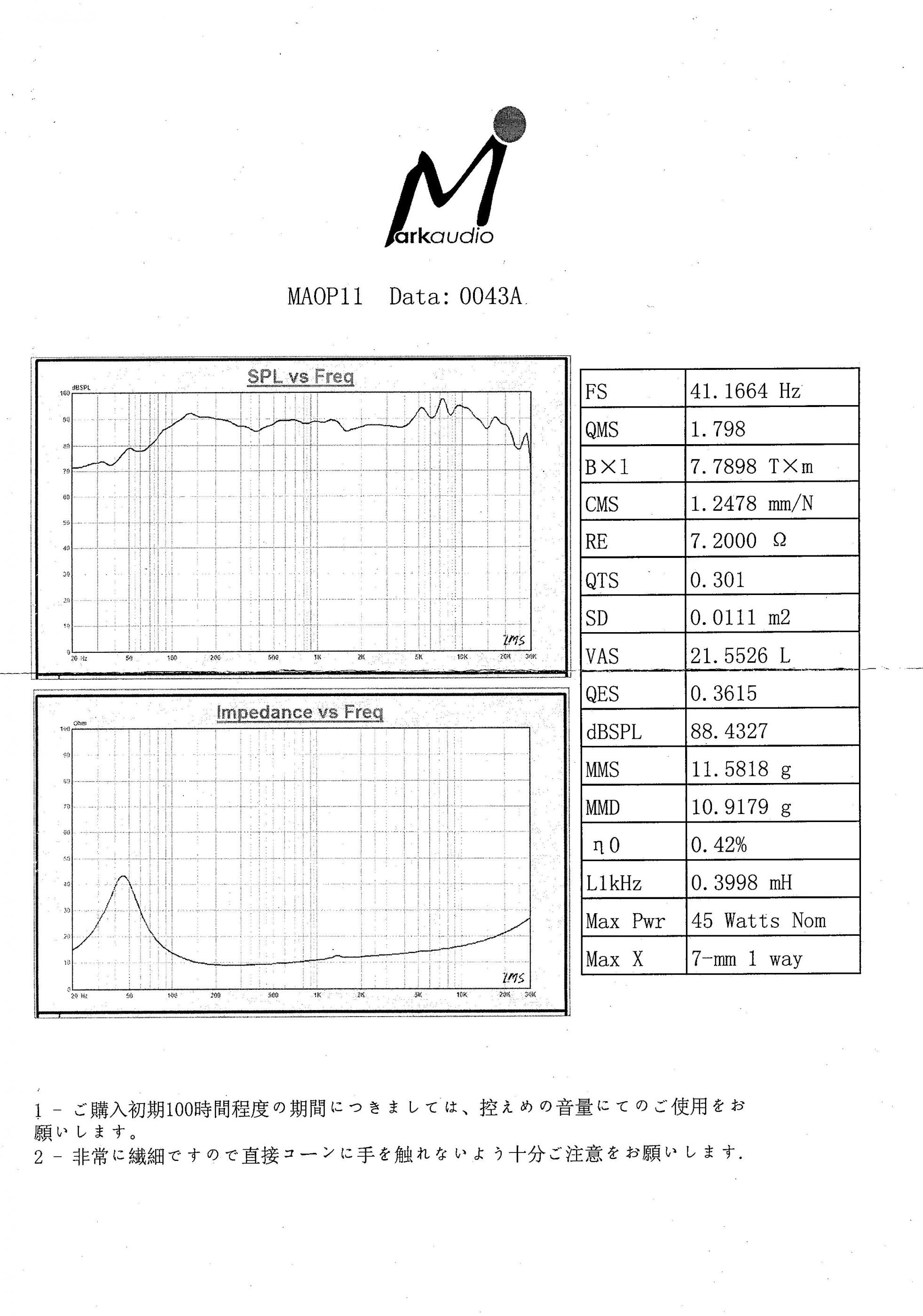

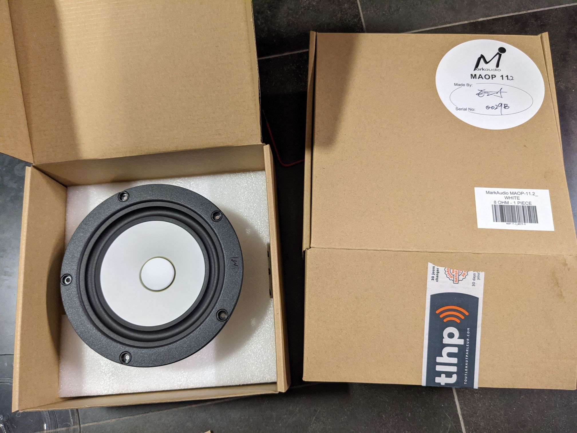

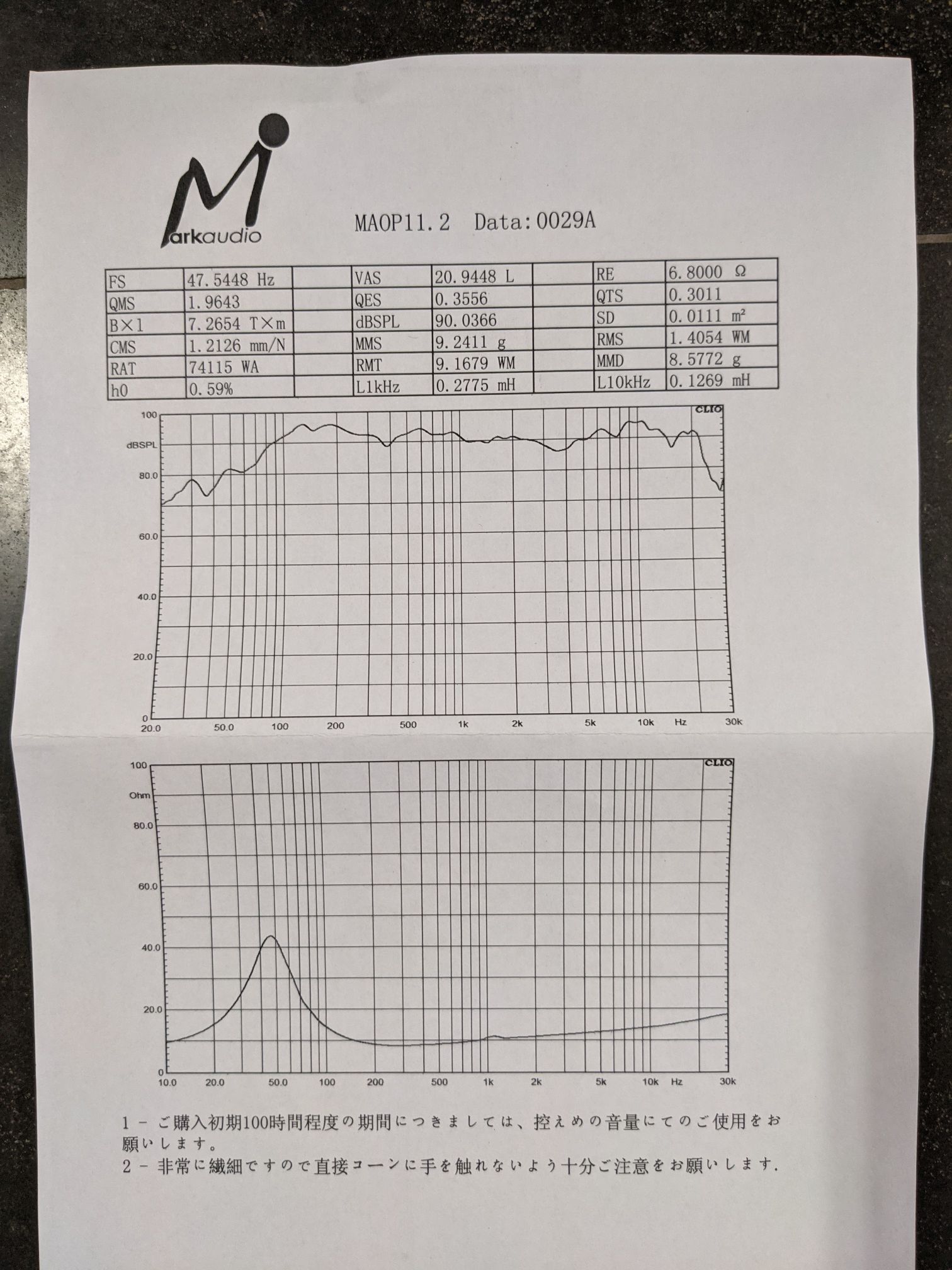

Dear danny_66,
My MAOP is 11 version 0.
The text at the bottom is in Japanese, and I translate English .
1. Please keep the volume at a low level for the first 100 hours of use.
2. Please be careful not to touch the cone directly as it is very delicate.

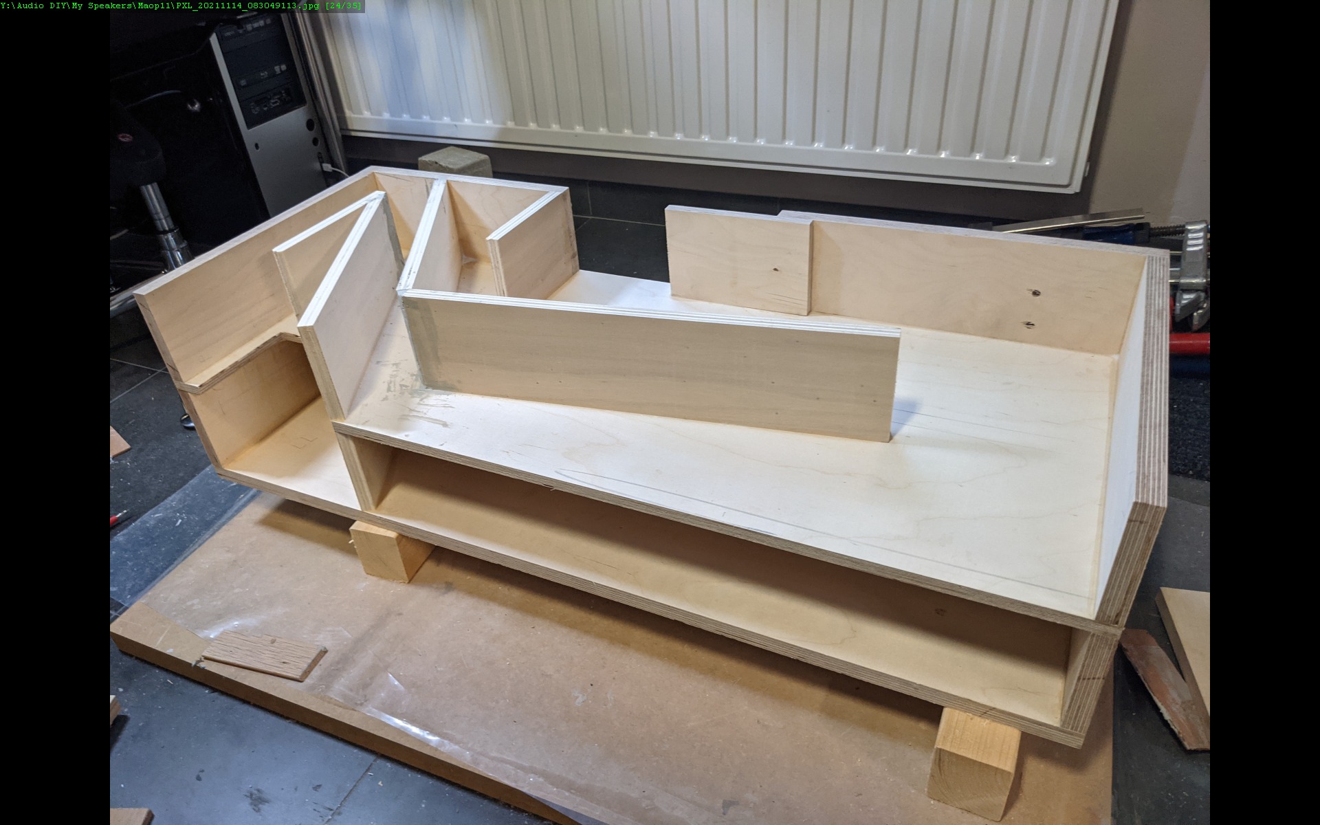

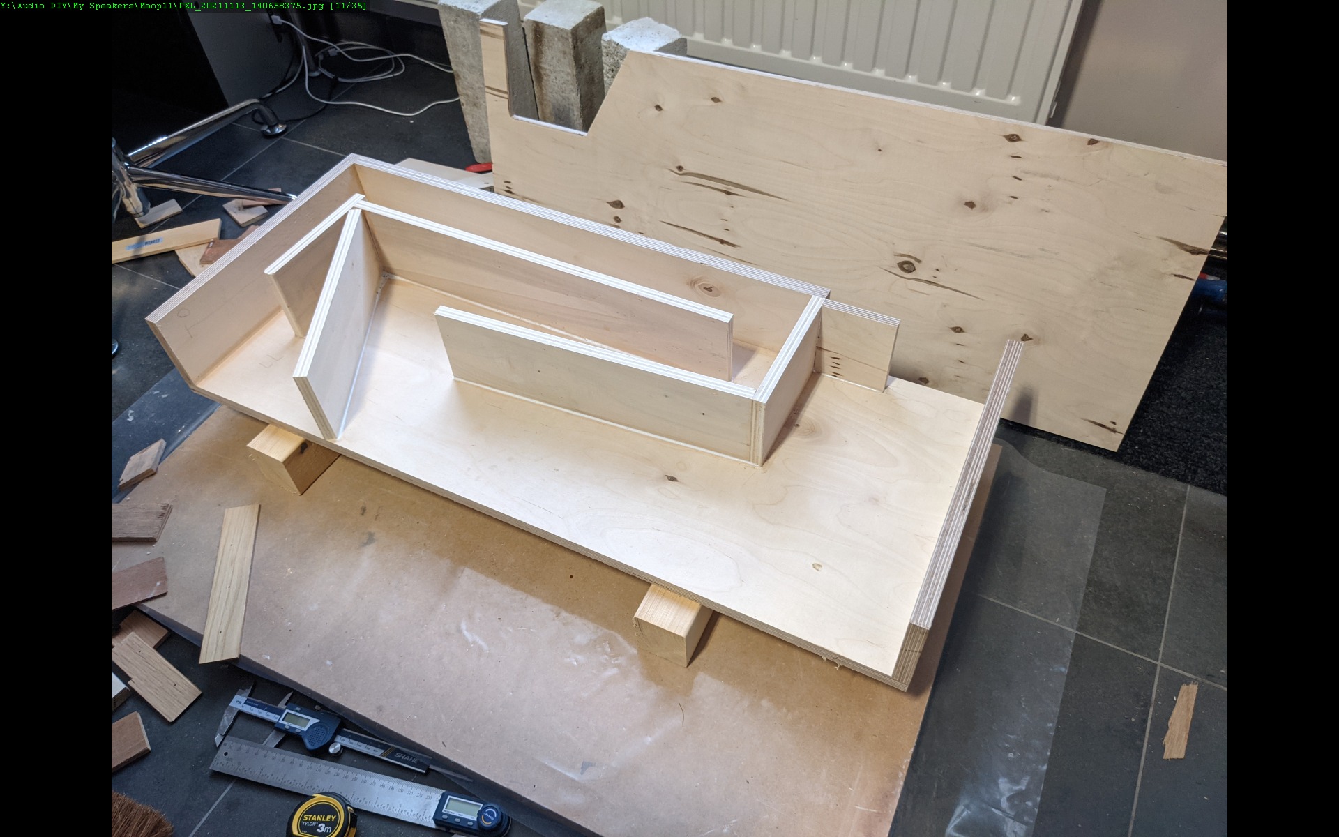

I started building your Adjustable-Duct Type SDDBH-T15.5R-AD.
It's some more work than a simple BR cabinet 😉
I will follow that advise.
Those oxidized MAOP cones look a lot like the Accuton ceramic cones,
I need to find a grill like those used on my Accuton mids, it's a very open grill.

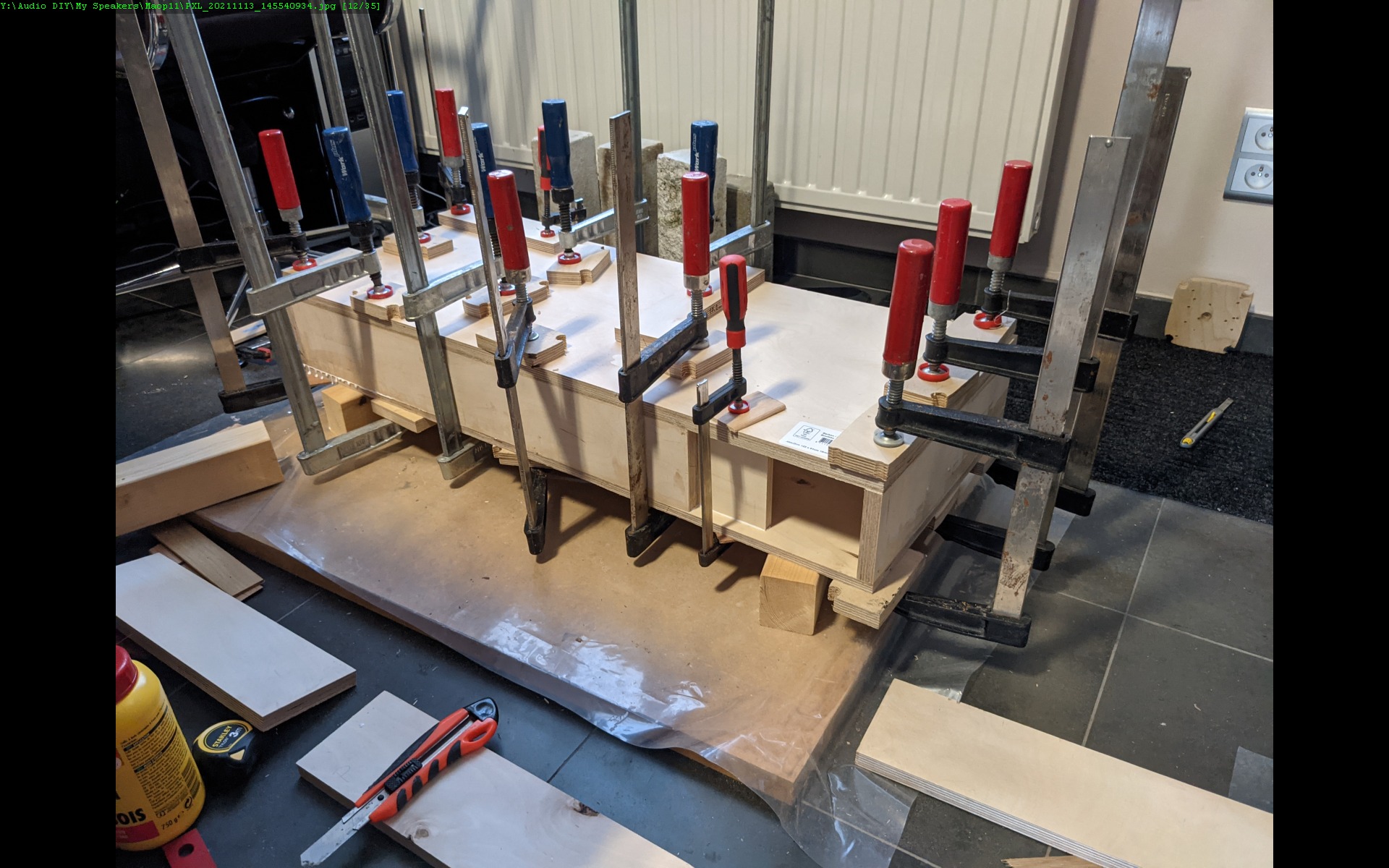

Dear danny_66,
Excellent!!!
You are using a good quality plywood (9 layers?).
I hope you get the sound you like.
Excellent!!!
Thanks!
It's a combination of wood I could find here locally.
Outside is 18mm 12 layer birch
Inside big middle panel is 12mm 8 layer birch
Inside horn shape panels are 15mm 7 layer poplar
I like the design because of being able to tune both horns with the moveable output port and also the size of the chamber.
