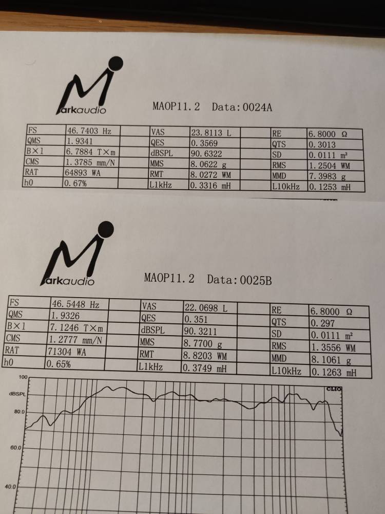

Here are parameters:
MAOP10.2 260A
FS 43.70
VAS 18.9370
QMS 1.6972
QES 0.447
QTS 0.3538
SD 90cm2
CMS 1.6772
MMS 7,556 g
RMS 1.2506 WM
RAT 74193 WA
RMT 5.9990 WM
MMD 7.0734 g
h0 0.36%
L.1kHz 1.2949 mH
L10kHz 0.0961 mH
RE 7.2000 ohm
MAOP10.2 260B
FS 43.44
VAS 18.7973
QMS 1.6583
QES 0.4458
QTS 0.3514
SD 90 cm2
CMS 1.6649
MMS 7.8030 g
RMS 1.3270 WM
RAT 77456 WA
RMT 6.2628 WM
MMD 7.3204 g
h0 0.35%
L1kHz 1.2588 mH
L10kHz 0.0989 mH
RE 7.2000 ohm
MAOP10.2 260A
FS 43.70
VAS 18.9370
QMS 1.6972
QES 0.447
QTS 0.3538
SD 90cm2
CMS 1.6772
MMS 7,556 g
RMS 1.2506 WM
RAT 74193 WA
RMT 5.9990 WM
MMD 7.0734 g
h0 0.36%
L.1kHz 1.2949 mH
L10kHz 0.0961 mH
RE 7.2000 ohm
MAOP10.2 260B
FS 43.44
VAS 18.7973
QMS 1.6583
QES 0.4458
QTS 0.3514
SD 90 cm2
CMS 1.6649
MMS 7.8030 g
RMS 1.3270 WM
RAT 77456 WA
RMT 6.2628 WM
MMD 7.3204 g
h0 0.35%
L1kHz 1.2588 mH
L10kHz 0.0989 mH
RE 7.2000 ohm

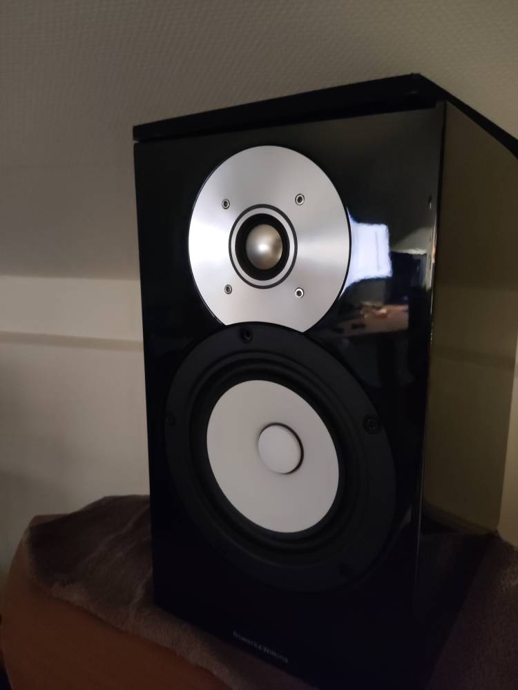

They look great IRL. Currently testing in 12L BR. Tomorrow I will resume listening but so far it sounds really promising!
(Tweeters are from original B&W CM5 but disconnected).
One thing I noticed is an excess of bass. Cabinet is lined and stuffed made from plywood with a 15 cm port. Modelling in WINISD (f3 52 Hz) proposes a nice response though. I might need to move them further in the room?
I've never stuffed a BR. Maybe pull out the stuffing and see if that helps the excess bass.

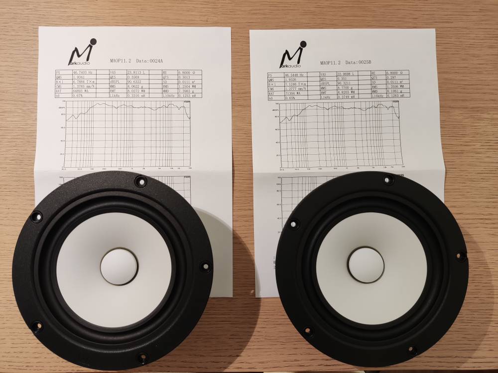

You must have very high standards for pair matching, because according to that data, those drivers are rather close.
The three critical for bass alignment (the first two dominating) and the variation:
Fs variation: 0.2Hz
Qt variation: 1.5%
Vas variation: 7.4%
As far as outout goes, rated SPL variation between them is 0.31dB.
Fs variation: 0.2Hz
Qt variation: 1.5%
Vas variation: 7.4%
