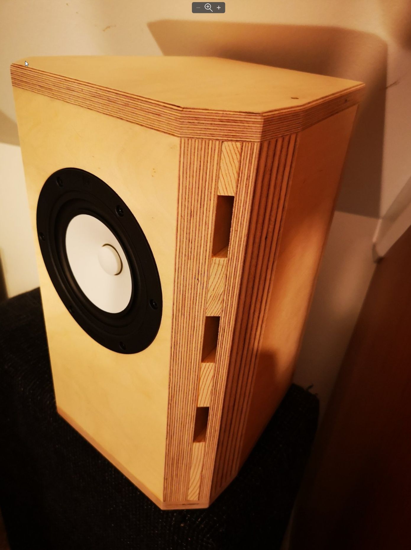

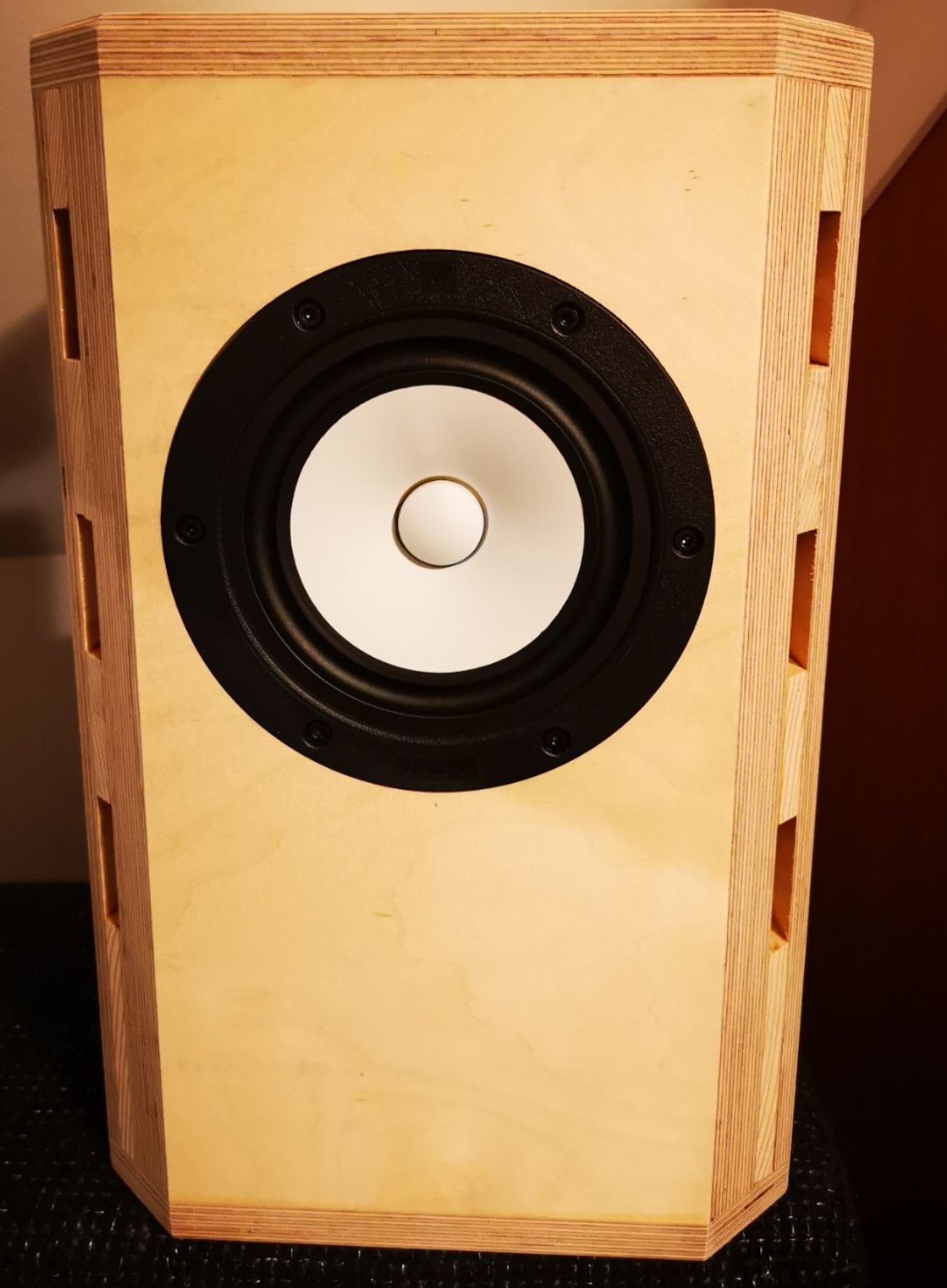

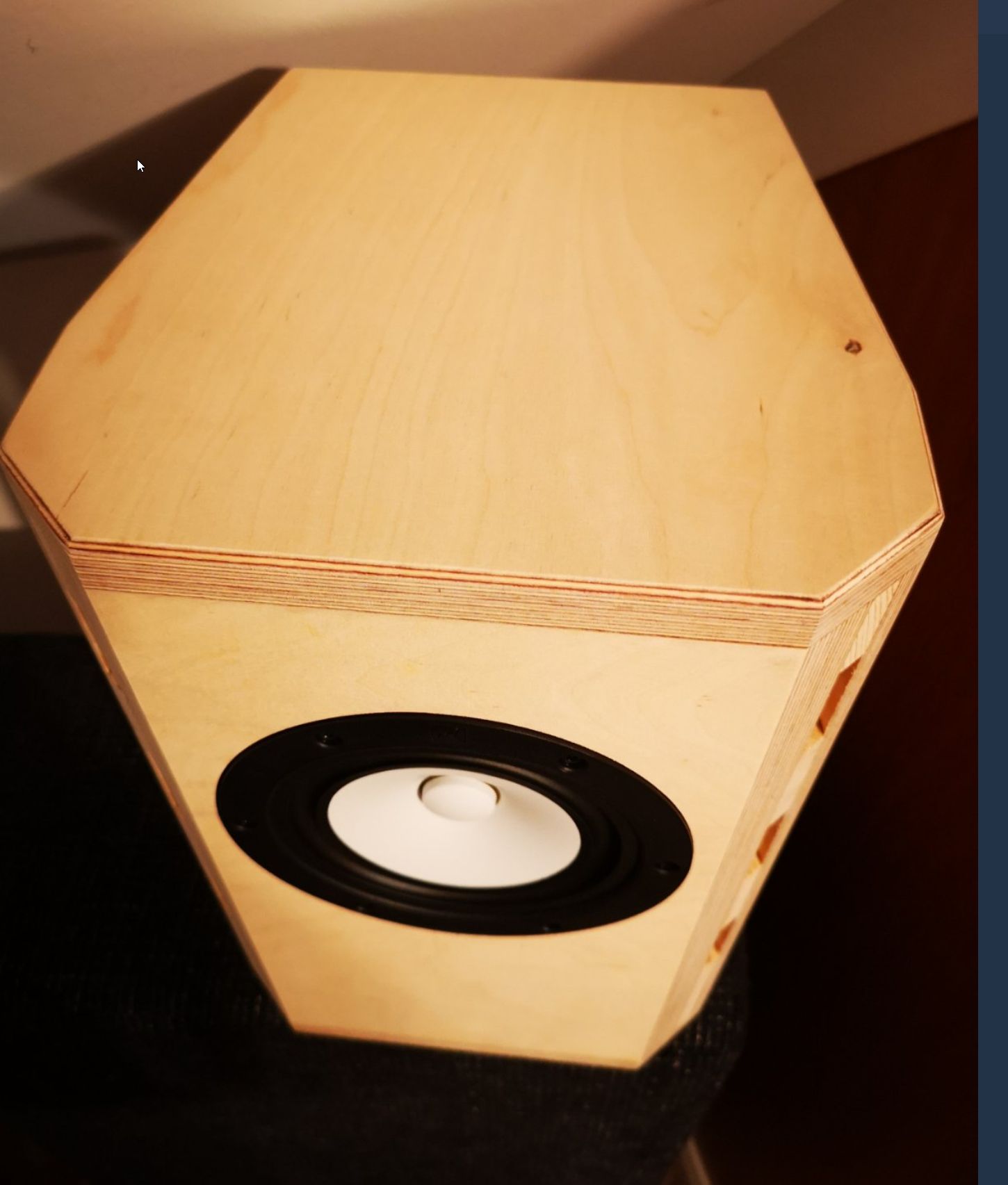

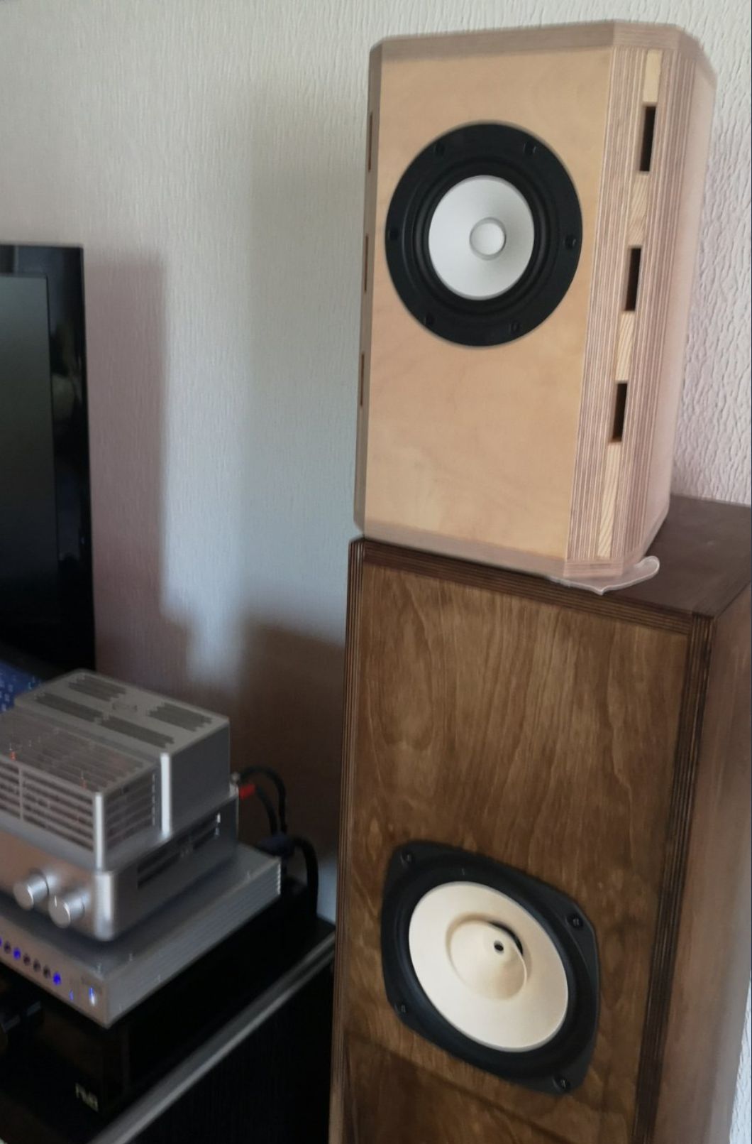

I finally finished my mini Onkens for MAOP.
Not sure yet how to paint them. I like the current raw look but some protection is probably required.
The initial sound quality is great, but before comparing them with other speakers, I believe it's essential to give them some time to settle and fully break in.
Here are some pictures ...

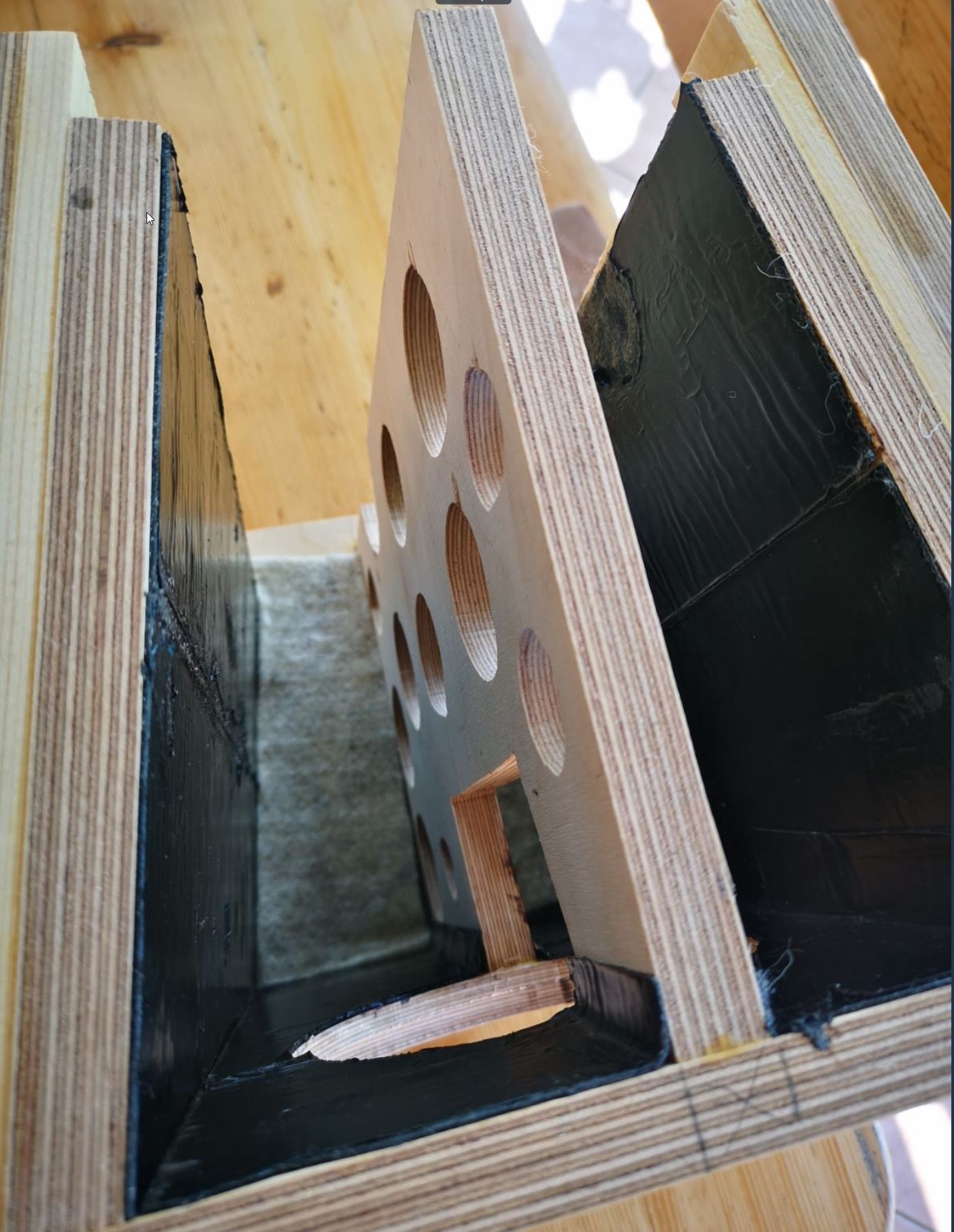

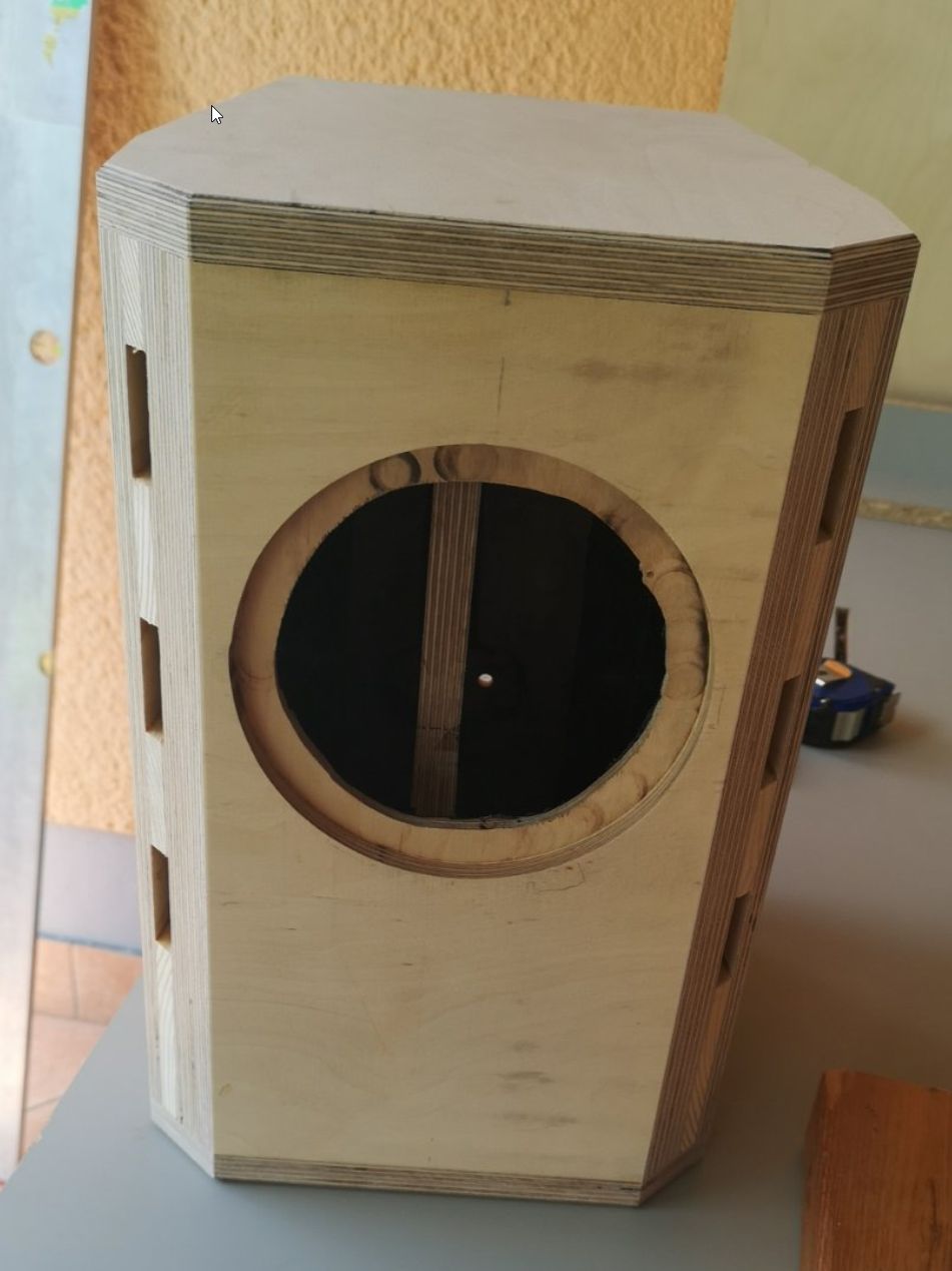

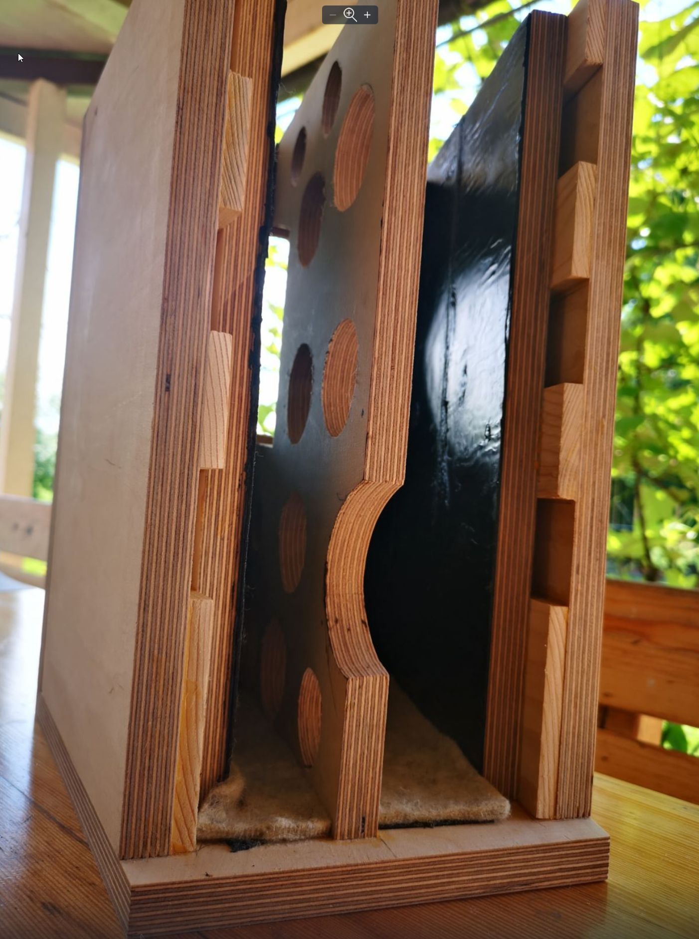

Very nice job. I'm in the process of building them too. May I ask what material did you use on the inside?

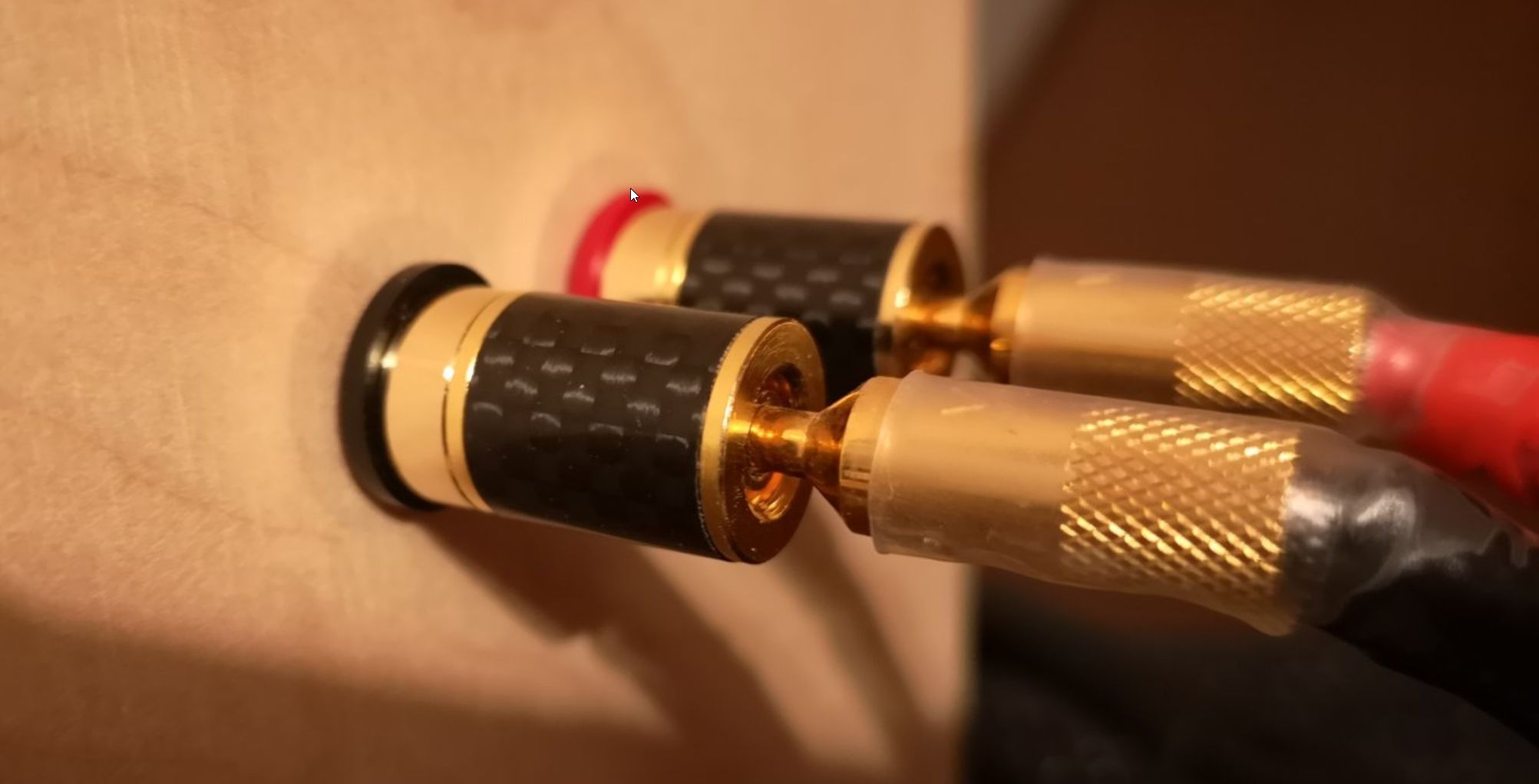

Nice work (i grabbed all the pictures). I just hope you never break a binding post or have to change the internal wiring.
dave
dave
Is it bitum inside?
Good observation Leif. That is not going to help, but it is thin enuff to have little impact.
dave
Yes, it's bitumen (for waterproofing). I also added wool (currently only top, bottom, back) where it's not easy to mount. Maybe I will add wool later L&R also.
It's not a problem to change internal wiring later - I assembled it when box was done.

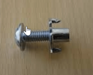

The screws of the speaker units do not hold well because there is only about half the thickness of the wood behind them. Did you experience the same?
How about changing default screws with something like this:
Non-opposing faces is generally a good default for damping, but follow Dave's guidelines. Large-scale bitumen lagging is counter-productive when using heavily braced void-free ply.* The object of the latter is to raise the box / individual panel Fs and Q to a point where there is little energy available to excite them. Extensively lagging them with bitumen just adds mass without any further increase in rigidity, lowering panel Fs and Q back down into the region where more energy is available.
*Exception are the BBC type thin-wall constructions, where it's part & parcel of the design approach -although ironically often skimped on by some (not all) modern commercial descendants.

You could glue in some small blocks of wood/plywood on the inside of the baffle where the existing screw holes are located, and then just drill the screw holes a bit deeper.The screws of the speaker units do not hold well because there is only about half the thickness of the wood behind them.

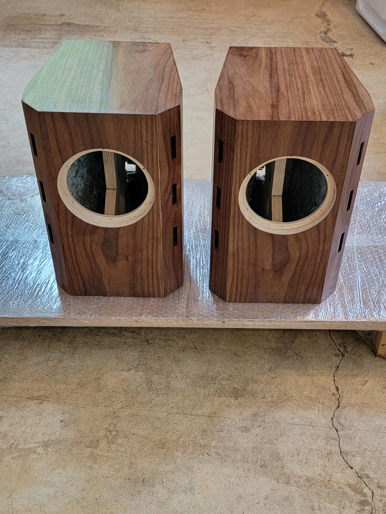

It's been a while since I posted anything about my MiniOnkens. Life has a way of getting in the way of these projects.
Here is a photo of their current state. I put on walnut veneer and am finishing them with Tung oil. I have to wait for the oil to dry. This is my first attempt at veneering, there are a few flaws in the veneer.
