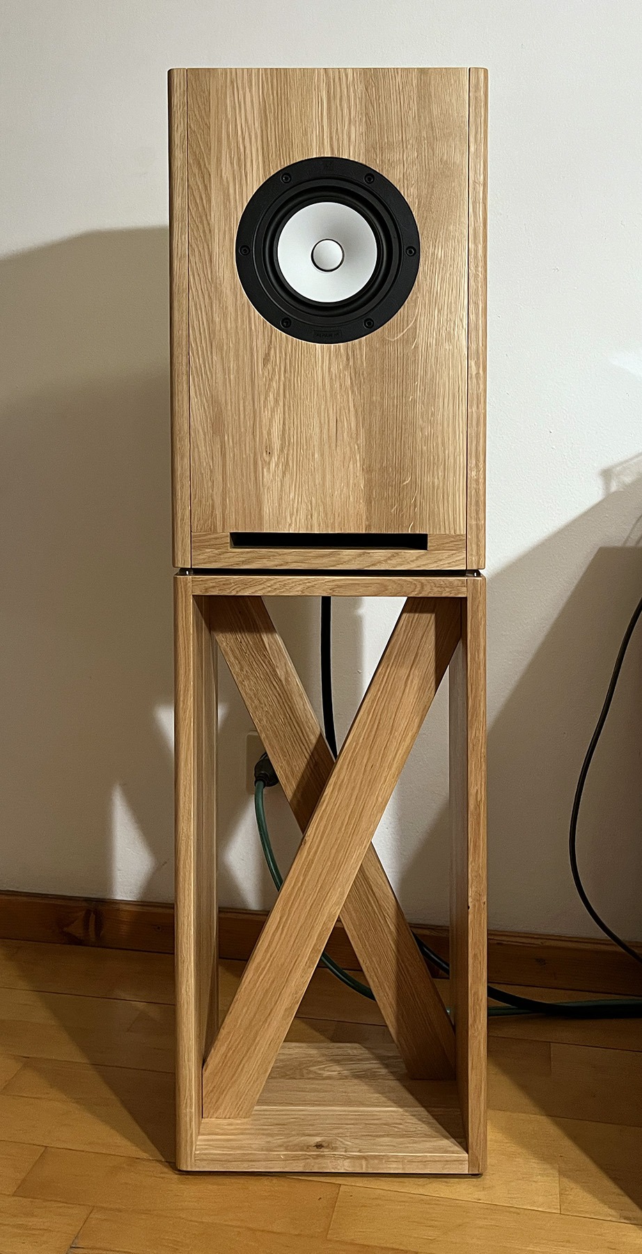

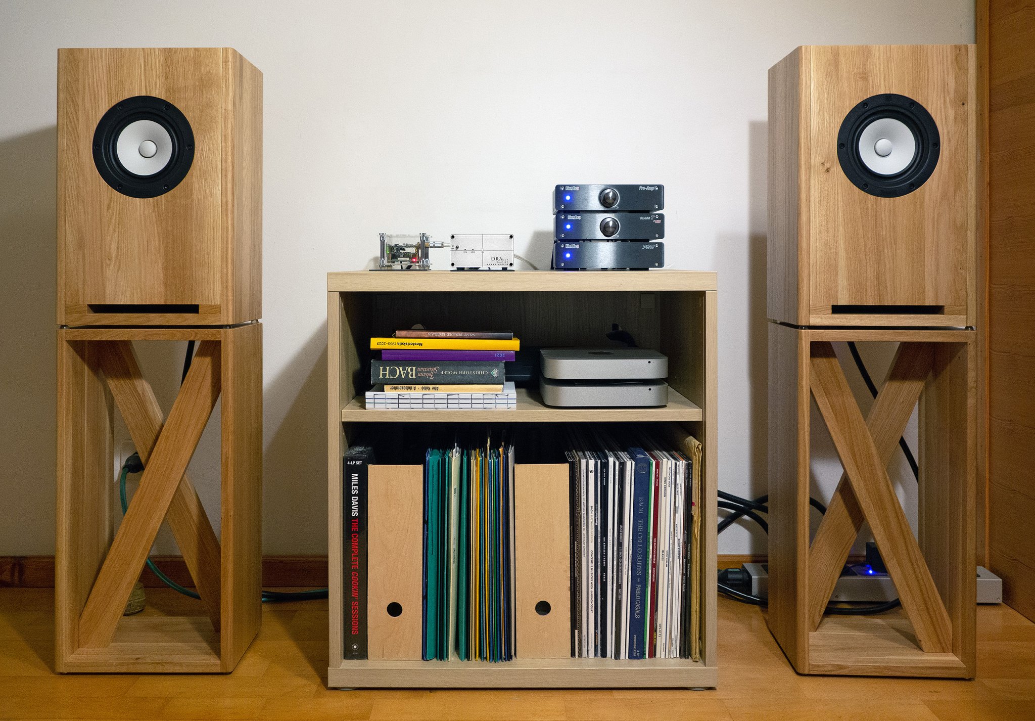

The MAOP 10.2 CGR box is ready. I have never made a DIY speaker, I am satisfied with my two-way speakers. Curiosity brought me to it, I never had a full-range speaker. I've listened to full-range speakers a few times elsewhere. My impressions were mixed.
It was a big surprise when my new speakers started playing. I've been listening for about 50 hours and I really like the sound throughout the range. The bass is particularly surprising.
Thanks to Dave for the plans and advice.
Very pretty.
At least another 50 hours of breakin needed. They will get better :^)
I'll report back after another 50 hours of listening to music. I will try it with several amplifiers.
