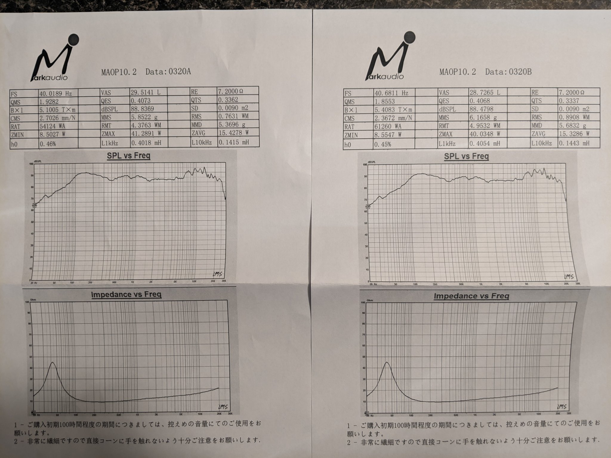

Hey all -- great thread here. After careful and long research, I recently decided to buy a pair of MAOP 10 drivers for a project. Thanks to all the active posters on this forum who regularly share new info!
I made a point to make absolutely sure the pair I was sent would be matched, after reading about a serial number mix-up with these same drivers in the past. My supplier did well -- we emailed back and forth as we verified everything, and eventually I ended up with a matched pair by serial number.
Today I opened the boxes to have a look, and the drivers made the overseas trip in perfect condition. However, when I compared the two printed measurement sheets, they seem a little further apart from each other than other matched pairs I can find (when googling around). I'll insert a side-by-side photo below.
I'm fairly certain I'm just lacking the knowledge to properly understand what a ".5% tolerance" match means... Perhaps someone can enlighten me?
Another member on this forum (maybe even in this thread) said that the .5% refers to the FS values... In which case, my pair would seem to have a considerably larger deviation. Ehh, not sure -- how do these numbers look? Thanks for any insight.
