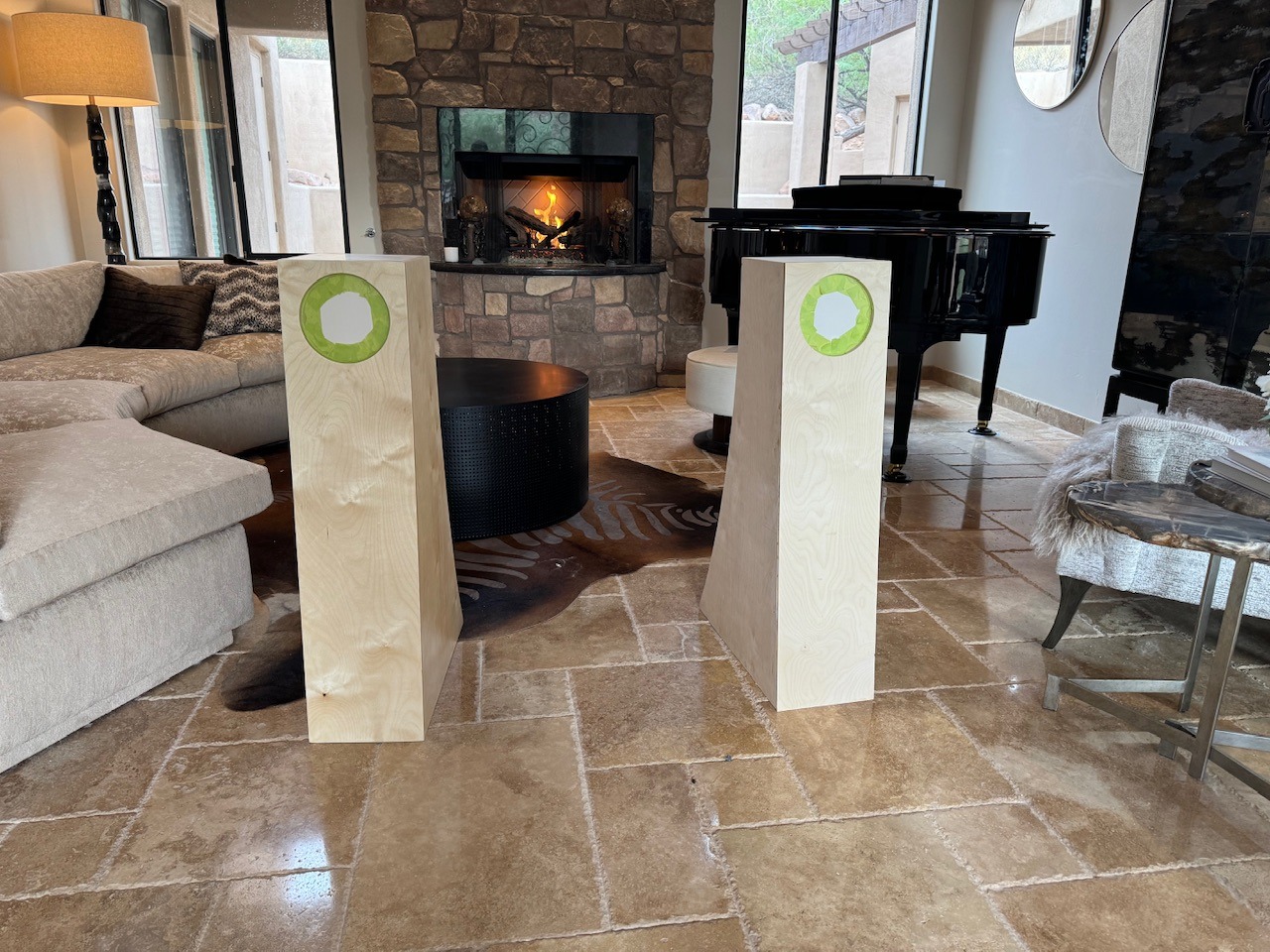

^Thanks. No, it is actually wood backed. I used heat lock glue to iron the veneer on.

I was out of town all last week so I didn't get to finish the speaker until today. They are not set up correctly as yet, I just put them on stands next to my Frugel horns. So far I was only able to listen to a few tracks. It's like @LeifB60 says, the speaker just disappear. I hope to be able to have a good listening session this weekend.

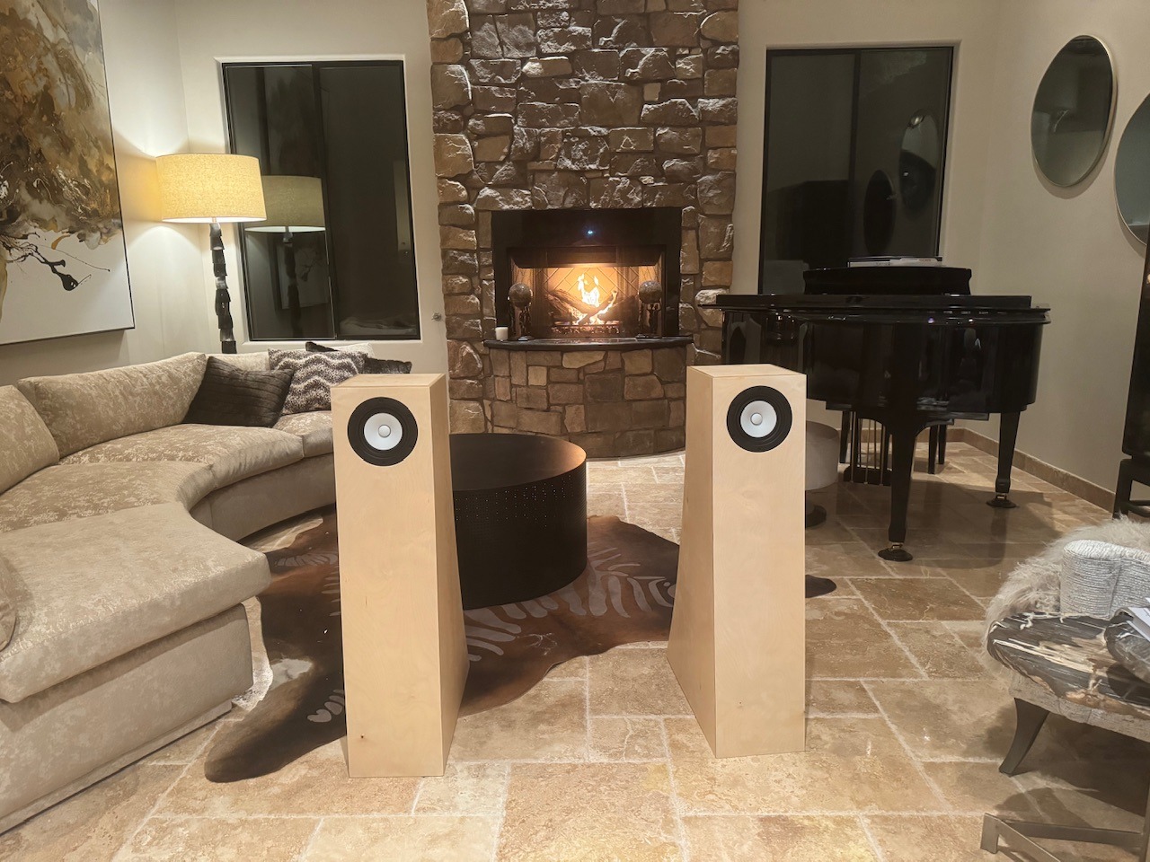

Frugel XLs w/MOAP 10s up and running. Thanks Bob at Big Wood studios for the kit and working with me.
A word of caution: The recess for the driver is perfect to a fault! The fit is so tight, with the flush mounted drivers, it would be nearly impossible to remove the driver after assembly. Before any assembly sanding around the speaker opening and test fitting the driver until it will drop out with a tap or two on baffle is essential!
Glamour shots:
Finished vs unfinished
Drivers installed. Flat lighting doesn’t show the grain pop.
Off to the “stereo room” with them for sound evaluation…Sadly wife wont allow in living room

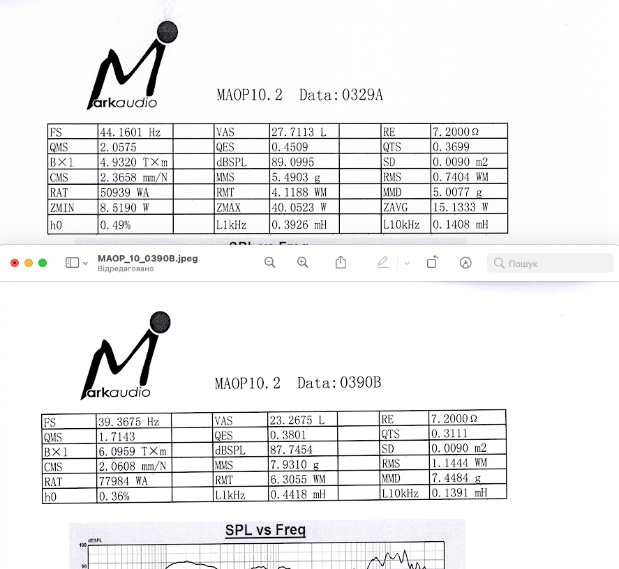

Disaster!Today i have received the two units of MAOP 10.2 from Soundimports. Unfortunately they are from different pairs and with huge diference in parameters. 🙁
Not acceptable. One of the points of the MAOP series is that they are factory-matched into pairs. If Soundimports is sending out examples they've pulled off the shelf as though they are generics (even though the drivers are clearly numbered) then they need to go back, with a polite reminder that they are supplied in matched pairs, labelled so there should be no mistake.
Part of the mail I received from them:
"Thank you for your message.
I'm sorry to hear that you have received a non-matching pair of the MAOP-10.2 drivers.
We did have some issues when it came to matching these drivers earlier on last week.
You can send the non-matching drivers back to our warehouse using attached pre-paid return label. We will make sure to send a new, matching pair of drivers to your address as soon as the package is on it's way back to our warehouse.

Dispetcher,
Good to know that the store has found the matching unit. Hopefully you return/exchange process will go smoothly and you will have a matched pair in your hands soon.
