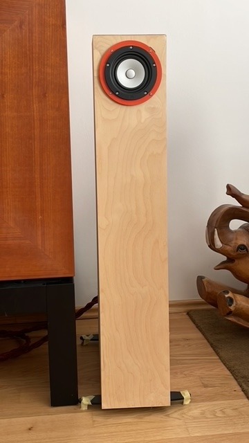

I'm looking at various cabinet options from FH XL flatpacks, to finished FH XL's when more will be made in The Netherlands sometime next year to recommissioning an existing speaker cabinet. Are the back loaded horn designs really the best for these FR drivers? Would I be sacrificing significant low end by installing them in a large bookshelf speaker cabinet? The one I'm considering was designed for a FR driver and is ported with a venturi inducing plenum between the upper and lower halves.
I have already built a FH3 with MAOP 7.2 drivers and I love the sound these little guys produce. So I'm familiar with the sound signature.

The alignment used for miniOnkens is such that one gets very elegant, refined, defined bass, but only go as low as they go.
In terms of bass extension, FHXL>Pensil>>Scott’s simple reflex>Mar-Ken10.

In hindsight I should have kept these KCS speakers and evaluated the sound with the MAOP 10.2's
Looks lik eit based on the same kind of horn as the BKs. Small mouth size limits bass extenion and i have yet to see a well modeled one that stretch teh TL response to push response lower.
IN FHXl the wall behind effectively multiplies teh mouth size by 4x, of in a corner by 8x, and Scott used all sorts of tricks to flesh out the bass response.
Silbury is a chamber loaded horn like the above KCS, but is more optimized, and uses the back wall or corner behind. They go even lower, and have enuff gain that it sometimes has to be damped down.

Those Silbury's are a commitment. I'm guessing they rate pretty low on the WAF scale. I built a Sachiko cabinet for the FE126 and that was huge.
Where would the poplar go on this list?
Given wall placement it likely goes lower than Pensil.
