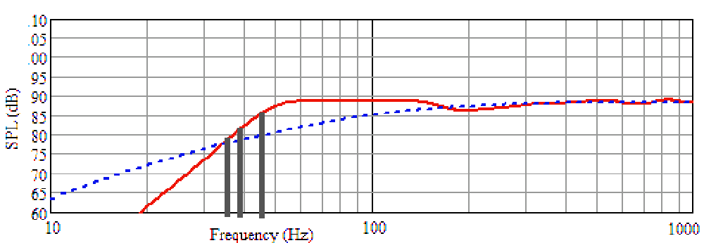

One of the rules i follow that i feel is important to the quality of the bass is;
The derivative of the simulated FR does not cross zero more than once.
When a box becomes too big it does not adhere to this rule.

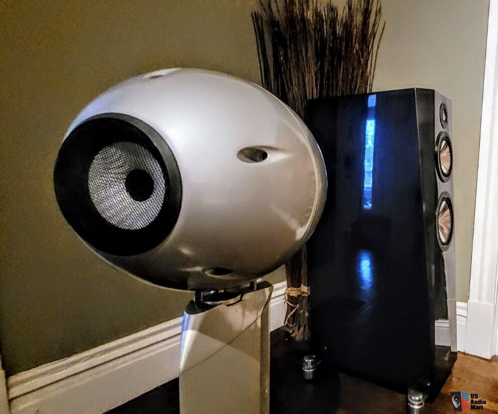

Not in the direction Pierrick, but an example of a Pensil that is not a rectangular box. Uses teh same form to create the curved panels for Ellipsa.

Here is the sim from the Pensil10.3 (,y mark-up of the anechoic extension)
In any quarter-wave the ripple higher up can be ignored as far as this ruke applies. One of th eadditional degrees of freedom of a quarter-wave/TL design.

Are these Pluvia 7HDs? They look great!Not in the direction Pierrick, but an example of a Pensil ...
i was thinking it was the front part of the box wich permit to improve diffraction definition and all that it makes mini onken a good desingn, i see you show me a pensil with curved panels?
Pierrick59,
Dave posted that picture as example of a Pensil that is built differently vs the standard design - but the difference is the curved sides and boat hull shaped cabinet.
You can work on some changes to the front baffle as long as the other parameters are maintained. 🙂
Post 553 is the anechoic sim of the Prnsil 10.3 which is what you woukd pout A10 MAOP into.
