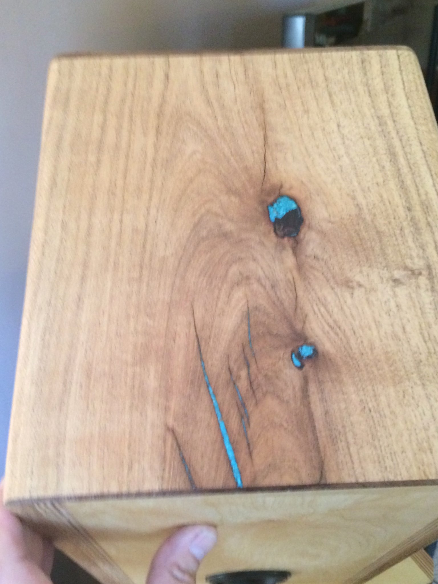

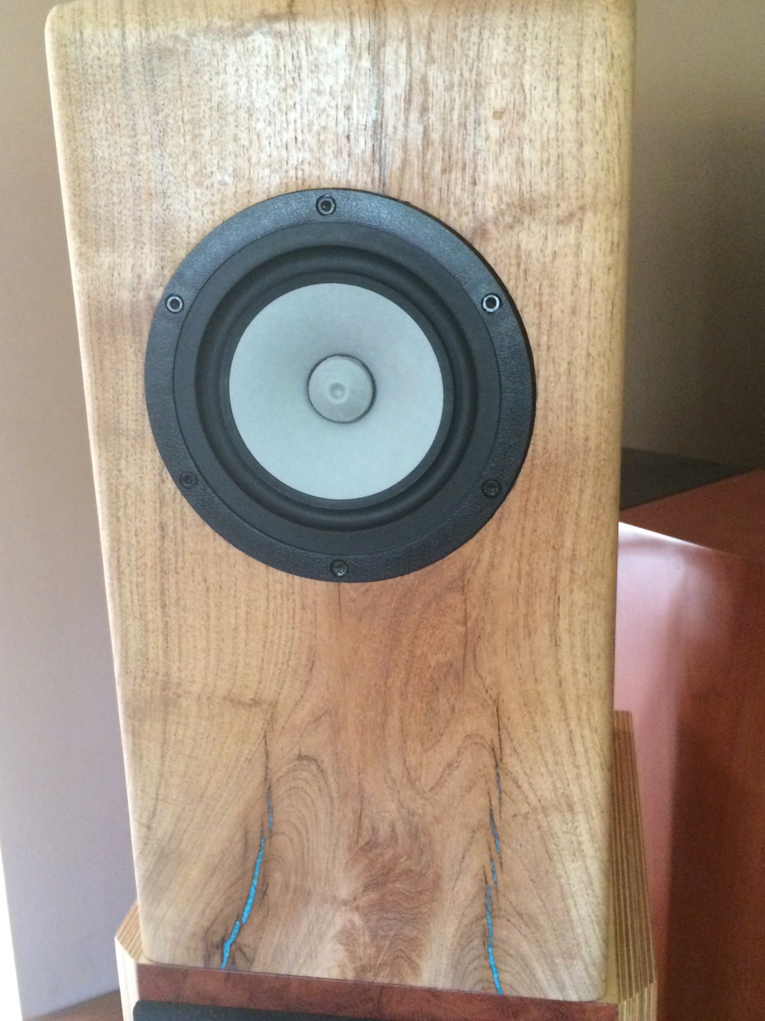

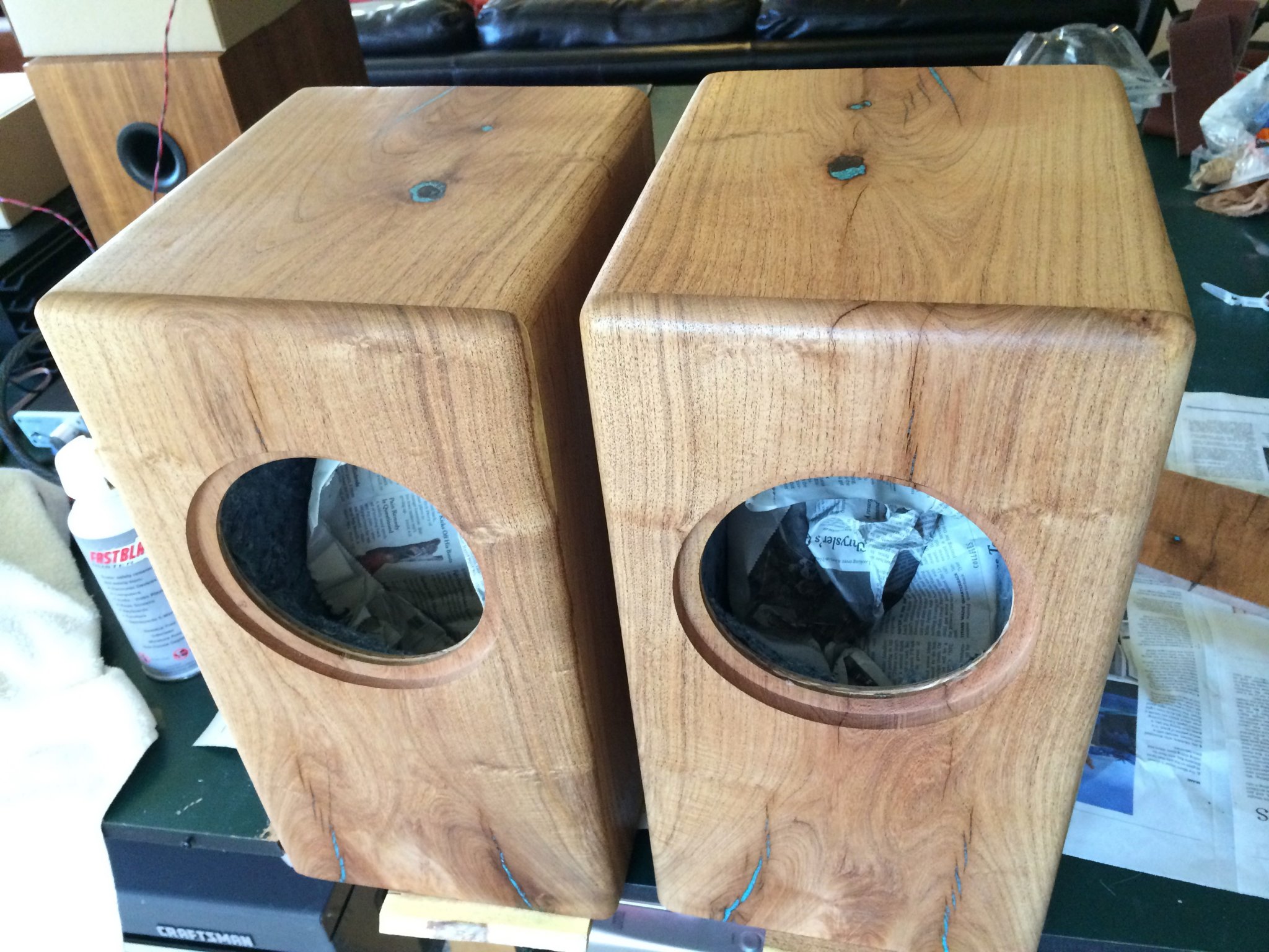

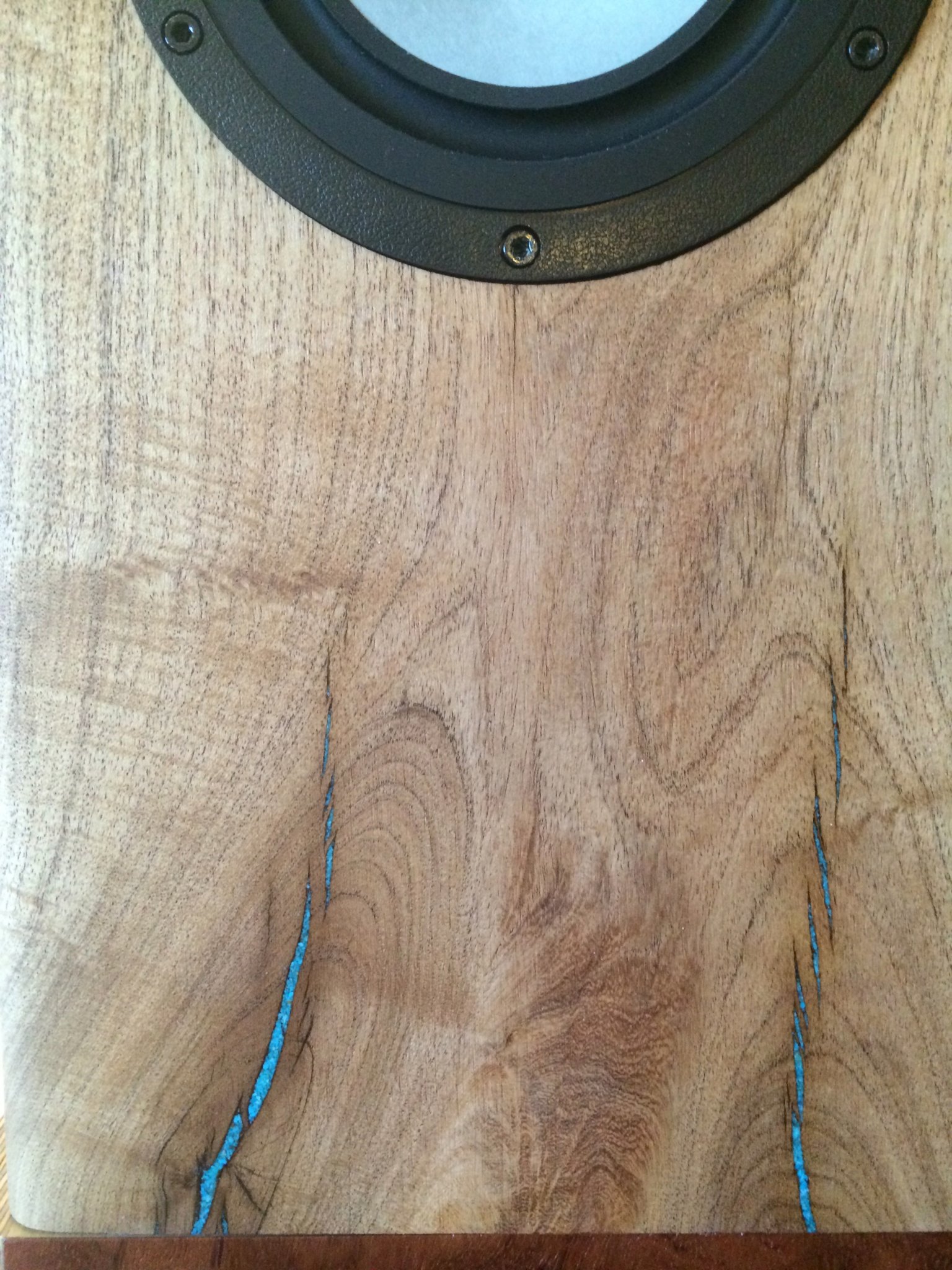

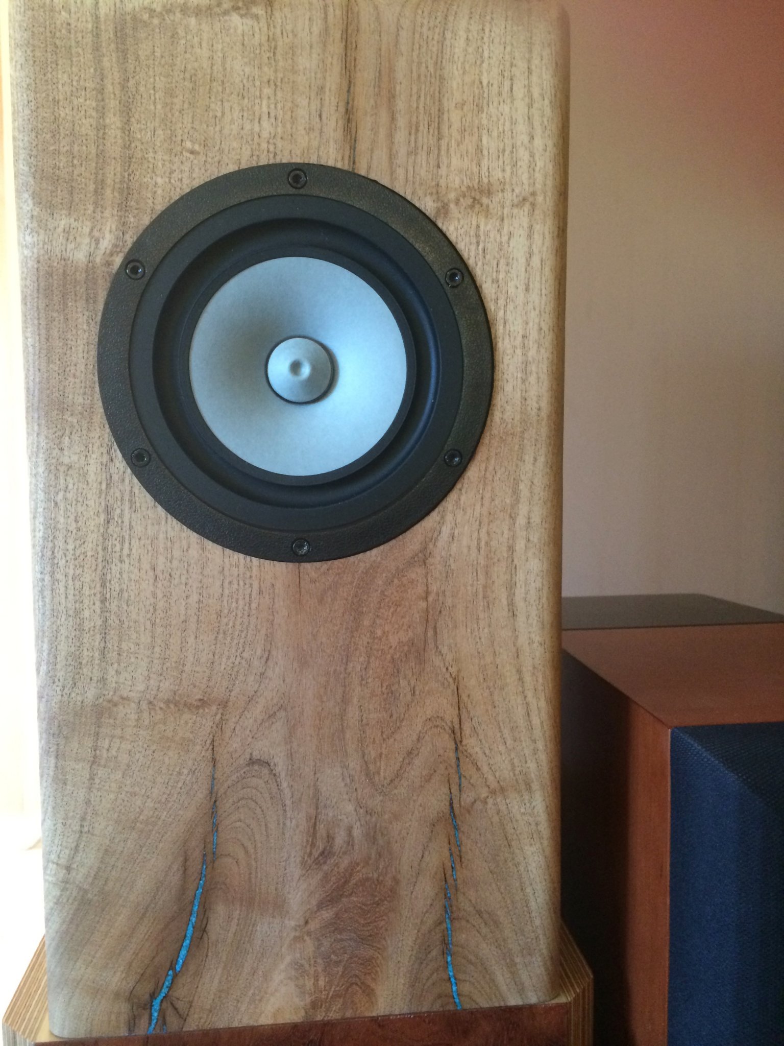

Thanks Zman,
I think I'll keep my A10 mesquite cab that I did a little turquoise inlay on intact....I did swap out the 10P for the 10.3m yesterday when I discovered the MAOP wouldn't fit and decided that I like the m better than the p. While the m is a bit more cruel on recordings with grating highs, overall I like it better...not by a ton, but better none the less. The margin of improvement, though to me isn't as much as swapping a 7P for a 7M (which I've done on my 2-ways).
When my back gets better and woodshop waitlist eases, I'd like to build another floor compact for the MAOP..
Mario
Here you go Dave...I think I posted this but it was many years ago: a Bob Brines bookshelf cab design for A10P or A10M. I bought the flatpac from him, assembled and then glued mesquite panels that were ripped, cut and planer'd down to 3/8". The "cracks" in the mesquite were inlayed with crushed turquoise mixed with apoxy....I think they look better now with the copper colored A10.3m and will eventually take pics of that.
Mario
