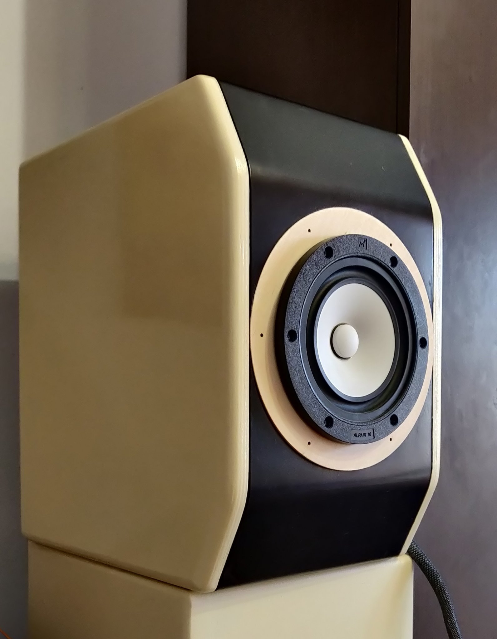

after long time listening in 60liter cab, i have shifted Maop to the small BR enclosure 16lit.
Maop earned more +++, because sound is great and there is plenty of bass and highs are still nice.
I was worried to loose all that bass from 60lit but still is there, enough of it 😁

I've been listening for a few hours tonight.
Maop10.2 sounds incredibly good. They are fast in the miniOnken. The base is detailed, homogeneous and sits in a screw anvil.
When you close your eyes and listen, you can't believe that such a small driver can add such weight to the bass. Reptile fast and accurate. They grow with time.

Yes. Note that the CGR, rectangular miniOnken and trapezoid miniOnken all have the same tuning, just different shapes. As the build get smore difficult, the diffraction signature of the box decreases. It is much more likely for a trapezoidal miniOnken to “disappear”.
dave
Yes, mine disappear completely.
In the sound stage.
They provide excellent detailed bass, in the wonderful midrange and treble they are completely approved.
In the sound stage.

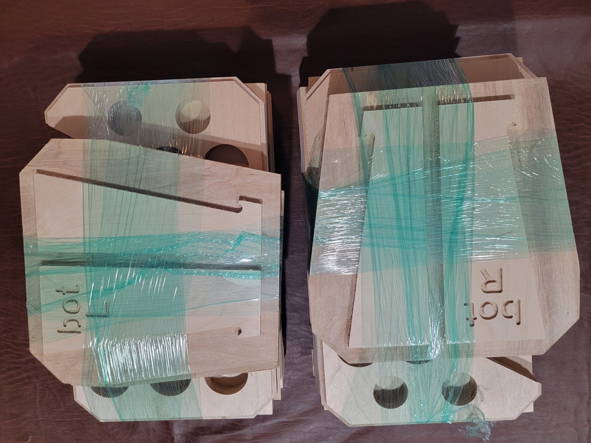

Picked up my MiniOnken flat pack from Bob Berner today.
- Full Range
- Alpair MAOP 10.2
