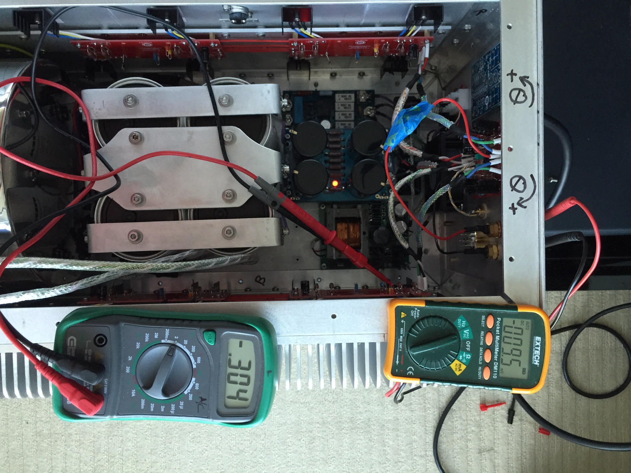

Well I guess I was closer to finishing the left channel amp than I thought, took 7 hours🙂
Performed the same start up sequence as the Right channel, no issues along the way.
Cooking right now, been about 30 mins.
No access to the borrowed Fluke dmm today, and the one I ordered hasn't arrived. So moving leads back and forth. Easier now that I know what to look for.
-313, +319, with -007.6mv offset right now. Closer than the right channel

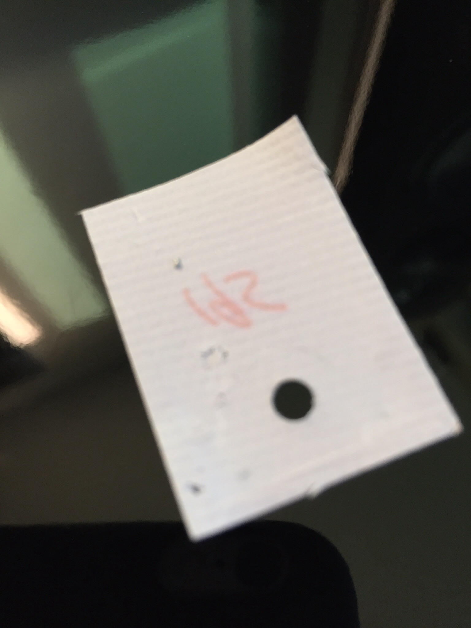

So to my problem (resolved BTW), a visual inspection showed no loose wire strands or any obvious issue. So I unscrewed the P channel heatsink, luckily I left a little extra length on the connecting wires, and started unbolting the transistors one by one with Dmm connected to show short. Thought I was wasting my time, until the last one (naturally). As soon as I loosened it just an 1/8" of a turn the meter cleared. Pulled the transitor completely loose and found this tiny piece of aluminum trash
Put back together with a new pad of Keratherm on now all is good!

That happened to me too: I screwed the transistor to the case, measured, then gave it another twist without measuring. The second twist caused the swarf to pierce the keratherm. But, I did not have proper protection in place, so the transistors blew.

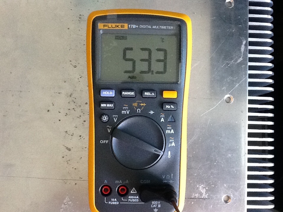

Been running as a system now for about 2 1/2 hours straight. Sounds really great. Plays loud enough and even at moderate level sounds full and not thin like most I've heard in my system.
Biased at 0.315 right now and hottest part of sink is 53.3C. Right in middle of design of 50-55C.

Funny how that happens. It is hard to diagnose sometimes too. Happened to BigE too. Goes to show, its very important to clean the surfaces before you install the FETs and diodes to the heatsink.
For good practice sake, I generally take an alcohol pad and wipe the two surfaces before installing anything to the heatsink.

Not sure what the ambient temperature is but at 53.3C, 0.315V bias is as high as I would dare take it. It should be plenty of power... about 100Wrms into 8 ohms.

Thanks for your comments and taking time to reply!Carefully place thermocouple on pin 2 of any Mosfet. Verify you are no hotter than 65C.
Your comment brings up a good question. In the Firstwatt paper about the F5's the heatsink temp is to be between 50-55C. Where is this measurement taken from? At the tip of the sink or the body part of the heatsink just behind the transistor?
I can't get to any of the pins as I have shrink wrap on them plus the little heatsinks.
Just got back from a long brunch with the family (still a fraidy cat to leave on when I'm away), I have the tip of the thermocouple to the tip of the screw holding the transistor to the heatsink. This is going to be the closest I can get to the transitor. After 20 mins it's showing 48.1 and slowing moving up still.
The 53.3C that I posted earlier was with the tip of the thermistor to the back body of the heatsink. At the tips the heatsinks measured around 47C

I just posted that I'm not sure where to measure the temp at on the heatsink. After I get more comfortable with how the amps react to change and know where to measure I can adjust accordingly. I still have the dmm's connected and so I can't completly close the lid. The top and bottom do not have ventilation, on purpose. The fan pushes outside air into the chassis and exits through the small slot between the upper and lower sink. With the lid on the air escaping through the top and not helping cool the heatsinks.
Measure the hottest part of the heatsink, it should be right next to the transistor.
As for transistor itself, try the plastic body if you don't want to peel back the heat shrink to test.

So am I correct that the 50-55C temp in the firstwatt paper refers to the outside edge of the heatsink? That's the only part you would be able to touch for 10 seconds.
And not exceed 60C on the body of the transistor? Why not go up to 175C?
You could drive on the highway in 2nd, at redline, but your car wouldn't last very long...
Same reason, longevity and reliability. To keep these things from failing often and expensively, it's best to run them conservatively, which is 65C max pin 2 and no more than about 1/3 max dissipation continuously.
And anyway, do you want your amp to be 350deg F to the touch??
