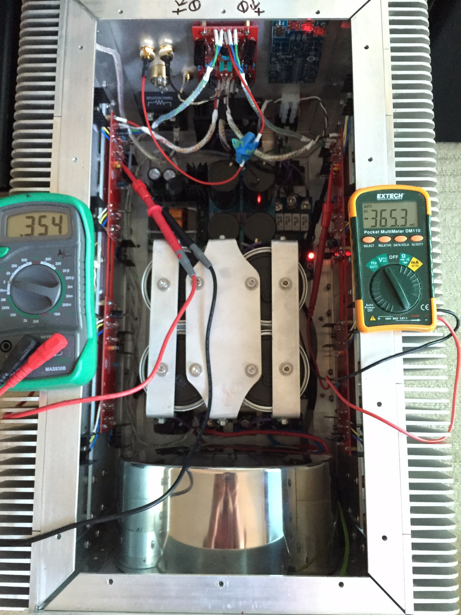

I had about 40 mins to try and rebalance the bias and offset before I had to run to the airport. After letting it run for about 20 mins to settle in I was able to get these numbers
I didn't have time to check the source resistors. Is the relationship between N and P to extreme, or tolerable? Now that I have zero offset.
Thanks!

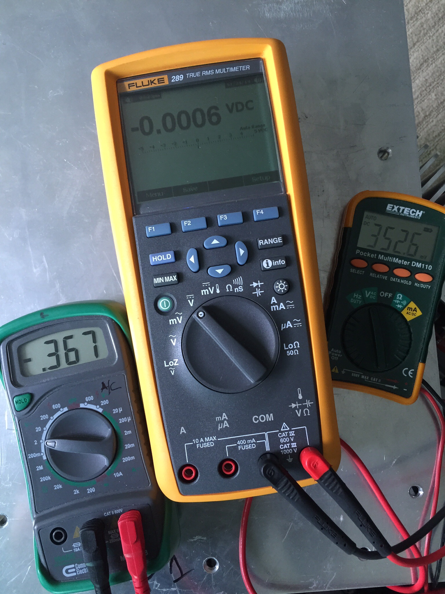

That looks a lot better, 6mV offset.
In my build I get a max of about 10mV difference from N and P channel bias.
As AndrewT says that could be the tolerance stack of jfets, MOSFETs, and source resistors, and perhaps even some of the other components .
I don't have a multimeter that can measure 1 ohm resistors with any great accuracy (ie. 0.001 ohm) and the probe resistance already measures 0.3 ohm so for me matching say 1% or less is kinda futile. So I tolerate the 10mV difference in bias voltage.
The difference in bias voltage is normal and is greatly effected by the difference in Vgs of the P vs. the N channel parts.
Don't worry about it. With thermal stability when warm and lid on, and zero offset, it's good. 🙂 🙂

Thanks all for the input and taking the time to read and answer my questions.
I guess now I'm ready to connect to a preamp and speaker? I haven't populated the speaker protection boards yet so I'll wait till the amp is up to temp and stabilized before connecting the speaker.
Any input on my temperature readings? On adjusting the bias, what is the indicator that I'm close? I understand 0.4 is max and 0.3 is a good starting point. My last numbers were .367 and .352, averaged 359.5, should I leave it there or??
Temp - can you keep your hand on the heatsinks for 10 or more seconds? If so, you're good.
Bias - Leave it where it is for awhile, it's about perfect.

I would run it at 0.3 volts first. It *will* drift, and you don't want it to drift to 0.4.... 0.3 is far enough away.
Remember, the temp will vary with the ambient temp of the room. You should ensure that it has enough space beneath it as well as above for good airflow.
