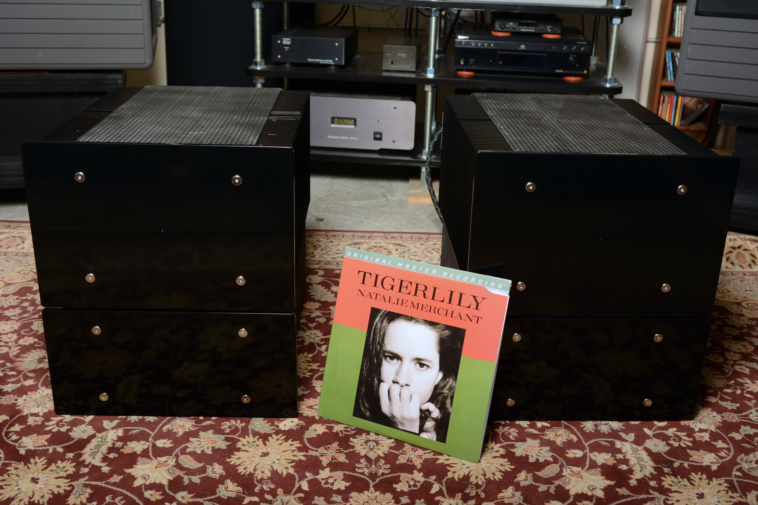

I've completed my appearance dress-up and input/output connector and wire upgrade. After listening for about 4 hours I can hear an improvement! As I upgraded some of the caps in my preamp while these were on the bench I could be hearing some of that also.
In comparing to my KT-150 fitted SST-70 monoblocks the F5 sounds more powerful and in listening to various music in digital and analog the overall presentation is more consistent. On good recordings I think the SST-70 has an advantage. On the F5 I feel like I'm missing a little of the detail the SST-70 brings, but then poorer recordings don't stand out as being so poor.
I need to close up some gaps between the aluminum chassis and the exterior to keep the airflow better directed to the heat sinks. As a first step to control temps. At 350 mV the heat sink temp at the diodes is at 55c. I have the fan running at the minimal speed of of 850rpms, absolutely no sound at this speed, even 6" away. If closing up some gaps doesn't work I'll need to change the resistor to the fan to allow more speed.
Other than looking nicer in my living room the best improvement is adding the power on/off control via my pre. So nice to have everything come on at once with a touch of the "on" button of the pre's remote!
Next up, to take on adjusting P3.
Anyway, here are some pics;
The sandblasted glass top is removable for access
Interior
Shot into mirror
Still need to paint the nylon standoff's and washers silver
The engraving on the logo plate is filled with a black fingernail polish with gold flakes to match the finish on my Koetsu Urushi Black cart.

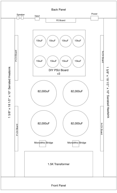

All the replacement parts are in hand, new power supply boards (each rail gets a pair of 33,000uF and a pair of Mundorf 22,000 caps), transformer (Anteck 800va, 25v), soft start, and my usual rhodium over copper binding posts and IEC input. I’m going to try CLC this time, 3.300 14 gauge. Took a bit of time fabricating the aluminum bits, drilling tapping. Then stripping all the old wiring off the boards. Now everything is ready for assembly and final wiring.
I’m using 1” aluminum angle to picture frame each side opening to attach the heatsinks two. One side is bolted on, the other side is set up to slide up and out for access. Total heatsink size is just a smidge larger than the store chassis, but since I take a hit on being vertical I’m also installing a fan. Half speed is virtually silent and should be enough.
It’s a little tight inside, going to have to strategically plan wiring and bolting in all the parts.

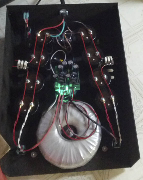

Some other projects taking most of my spare time, but here and there continuing the work on the “new” F5’s.
I’m determined this time to spend time learning how, and to what affect, adjusting P3. So for fun I’ve mounted the FE board to the outside for easy adjustment. I’ll work out an easily removed protective cover.
I’m tying out a little simpler way to power the amp off/on with a source supplied 5-12v trigger. Looks to be working on my first couple tests.
As mentioned earlier, this time I’m trying out CLC and a “stock” power supply. The transformers are Antek and since their rating is sometimes greater than the results, I ordered 25v instead of 24v. Without any connections the transformer put out 25.5v. Unloaded power to the FE board is 34.5v.
Anyone see any issues so far?

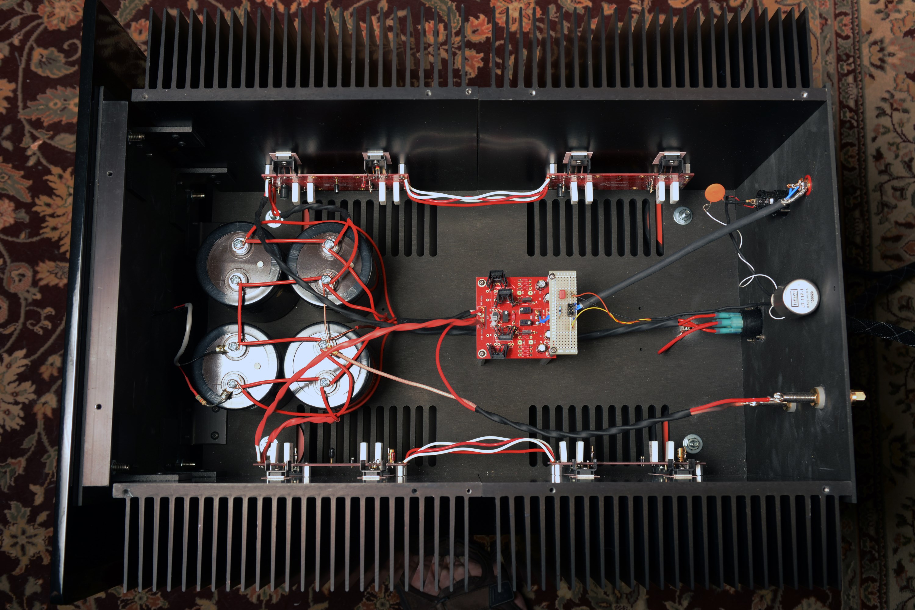

First Channel Running
Yesterday morning I completed the first mono block.
I had already checked the power supply to the FE board along with the pre-amp based trigger on/off system.
As per protocol I had zero’d out TP1 & 2 and centered TP3. Power up was pretty straight forward, doing the dance between TP1 and TP2 watching the meter on the binding posts.
Decided to run up close to 0.350v. Halfway between FAB and Fraidy Cat!
I used 2 short set’s of clippy leads connected to the output boards test point, one set for each N and P boards, dropped through the bottom vent holes, for testing. Really easy to adjust from the back panel without having to open anything up.
Voltage at the FE board, at operating temp, is 30.5 vdc. Seems like a little bigger drop than I had expected?
My little work room has no AC, outside temp is 27 degrees Celsius, inside temp is 28 degrees Celsius and the heatsink, measured at the base of the fins at the hottest point, measures 58 degrees Celsius.
Sounds good so far, no unwanted noises!
Comments welcome!

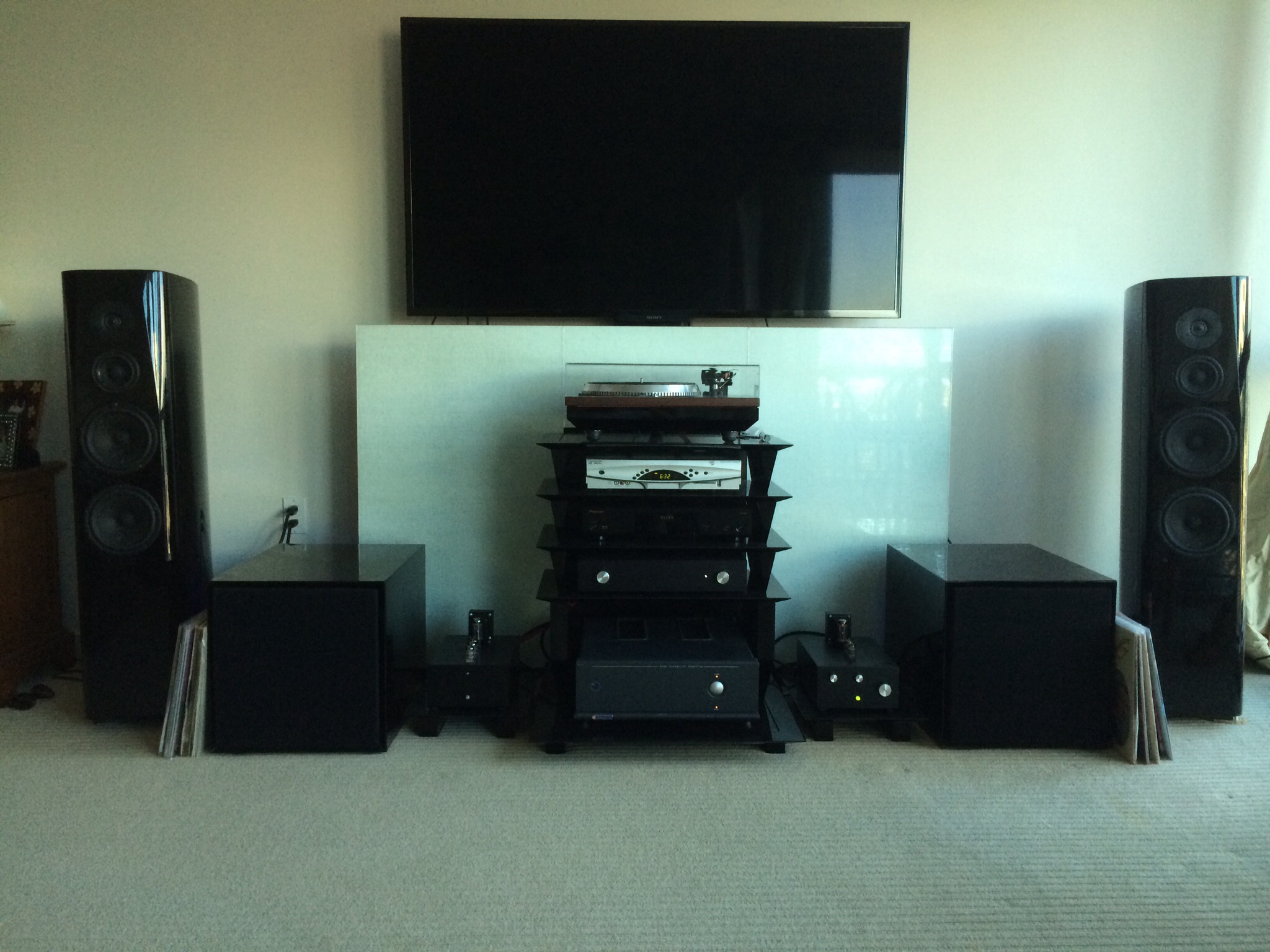

So my work room system is the two full range speakers I built, these F5’s, and the Bluesound Node 2.
I’ve mentioned before how much I like the Node 2. For $500 and a subscription to a streaming service (I use Tidal) you can listen to almost every recorded song, playlists, etc.
The amps I build do not have any power on switches. Both my Mac pre and this Node 2 have output triggers. So I use a simple Crydom solid state relay, that takes 5-15 trigger voltage to start the amps up.
The phone app for the Node 2 has pause, play, volume and other controls. So to play this system is as easy as opening up the app, pushing play, and everything comes on. After 15 minutes of pushing the pause button the trigger releases and shuts down the amps.
At less than 50% on the volume slider I’m getting almost 90db’s
