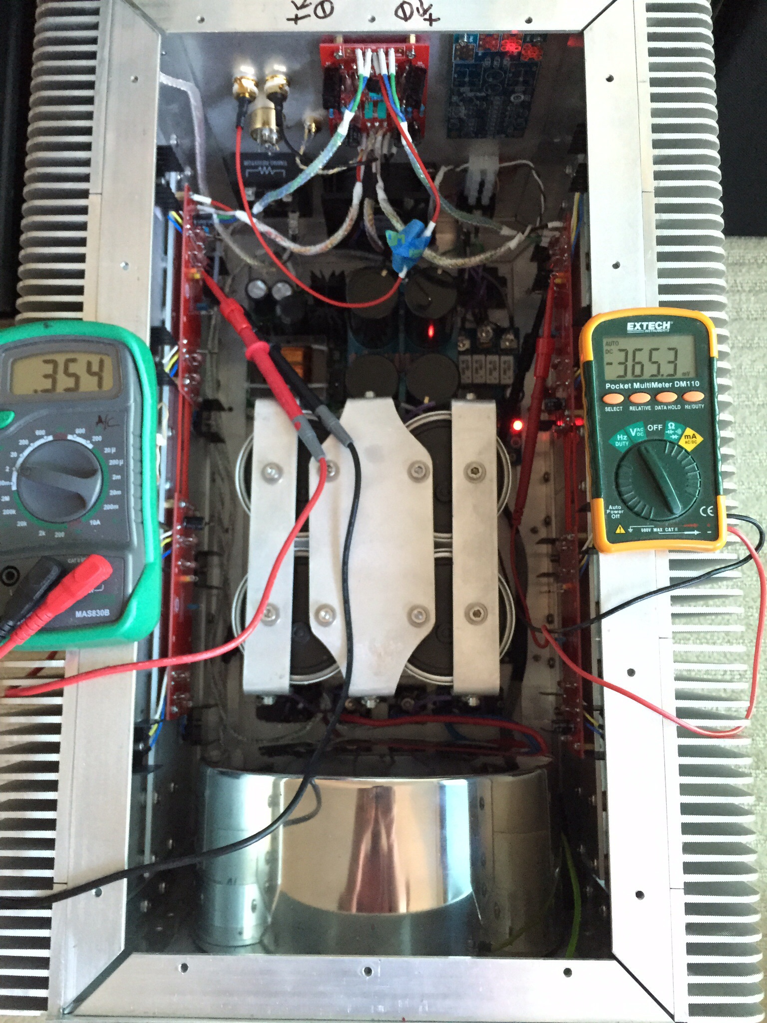

What is the bias current? You have enough to get the diodes conducting, they are only supposed to do that on transients...
How do I measure bias current? What controls the current to the diodes?
Like this -

I played the amps for an hour tonight after this round of changes and on the left amp I had 0.337 bias and temp of 49.1 Celsius. The right amp had 0.366 bias and 47.9 Celsius. Not sure why the right amp is running cooler with more bias. In the next day or two I'll adjust the bias to 0.350 each and see what the temp does and compare again.

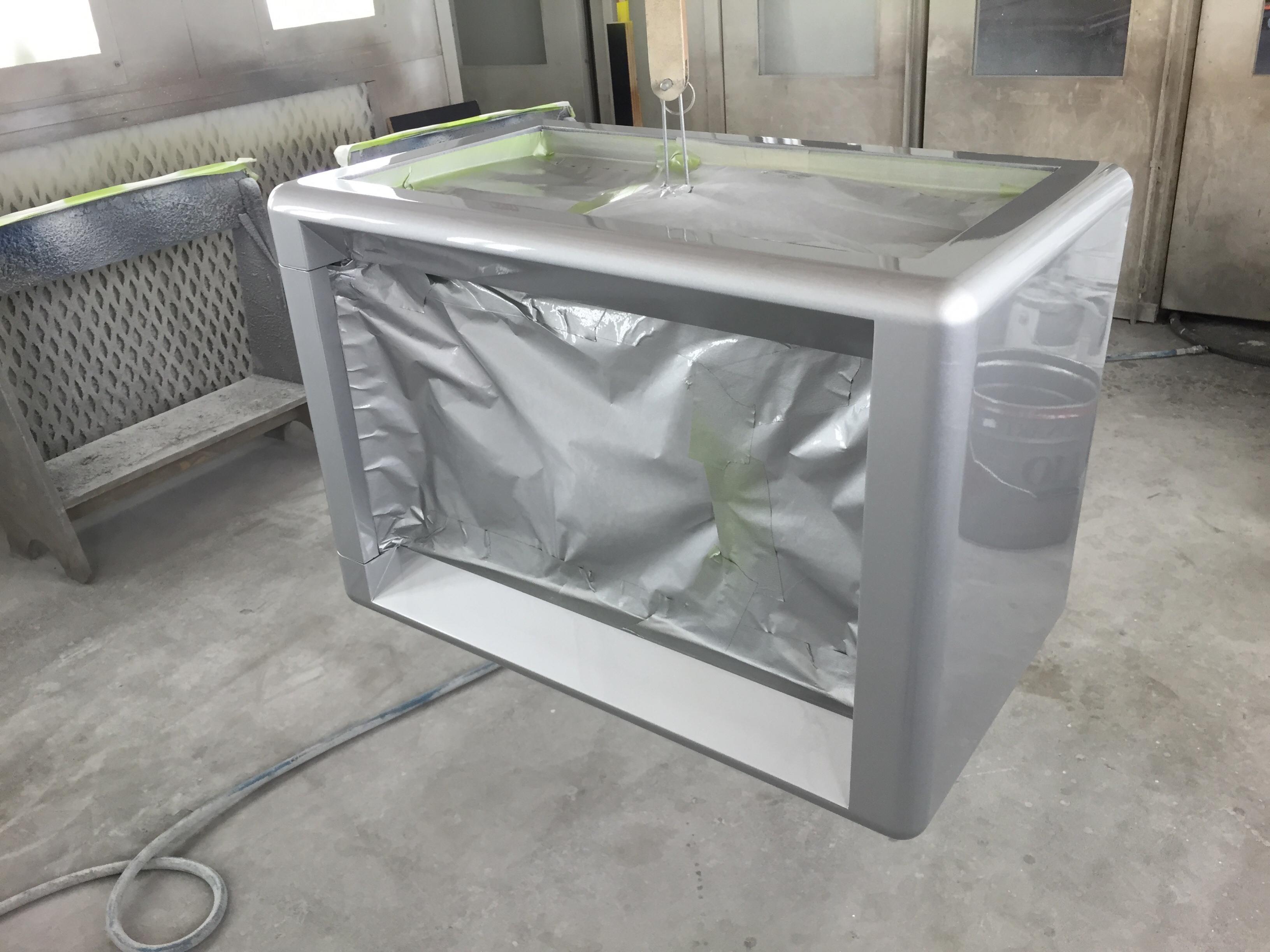

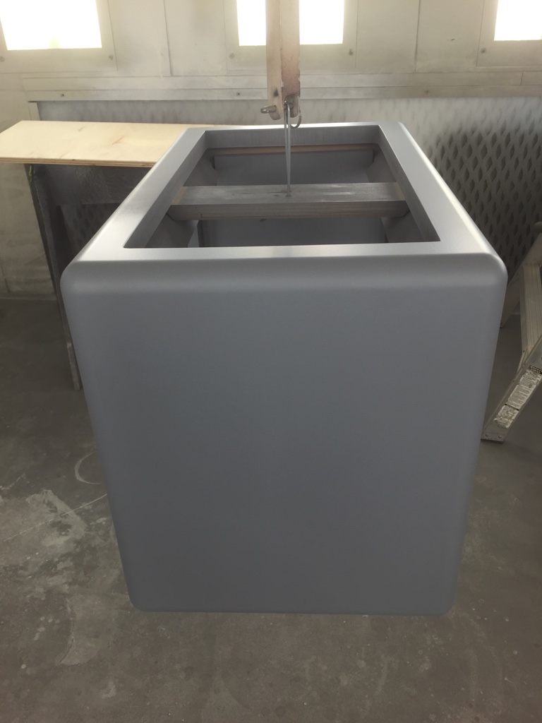

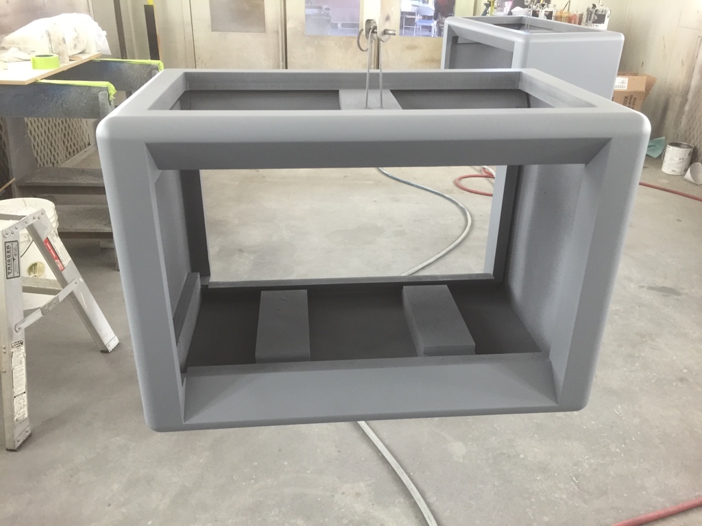

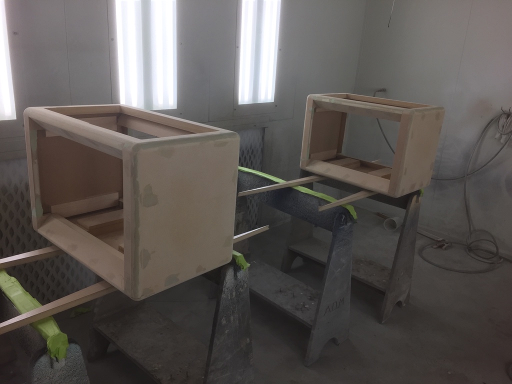

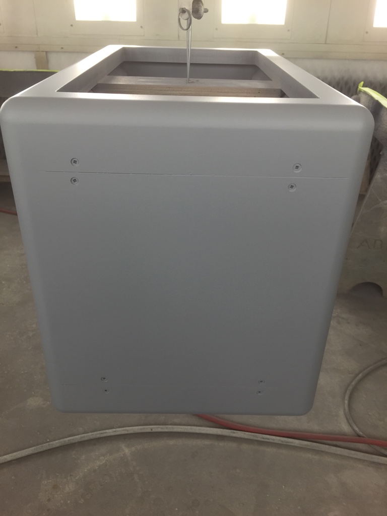

I have finally gotten back to working on the F5. Been working great and listen to it almost everyday. As it sits, it's a big ugly lump of aluminum with a lot of heat sink attached. And I still haven't adjusted P3 yet.
I have had a hard time coming up with a design that I like for more that a week of two. So I settled on making it look similar to my turn table.
Basically a bunch of MDF cut and routed to cover the four sides and leave open the actual sides with the heat sinks. Also set the top and bottom of the sides at a 45 degree angle to slow better airflow.
Raw form
After one round of primer and sanding and then the next round of primer still in the booth.
The top, front and rear will also have some brushed/anodized aluminum panels, and the top and front will also have some glass. The rear panel is removable to allow the amp to slide into place. The aluminum panel will cover most of the seam and the temp screws will be removed. Should look interesting when done. Hope to sand and spray out the silver and clear coat next weekend.
Sent from my iPad using Tapatalk
Raw form
- Aloha F5 v3 Monoblock build
