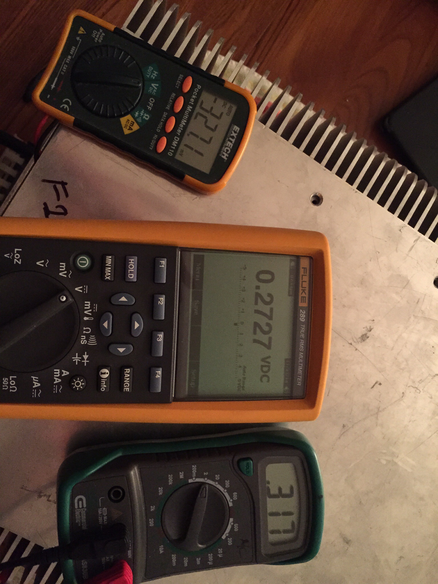

I had to shut it down and run over and pic up my laser thermometer, cooking again now, with the 3rd mm connected to the speaker terminals. The amp was off about 15 mins, switched it on, full power, no issue. I'm using a 4 amp slow blow fuse.
So after 1 hour this is what I have
I've adjust the offset as far as I can, no matter what voltage, the negative stays about 0.01 higher (numerically) and the closest I can get the offset is 0.2727.
Shooting my laser thermometer to the body of the heatsink, directly at the opposite side of the devices, I read 33-37C on the bottom row and 31-33C on the top row. (Cover on, fan on, interior of my condo is 26C) The top cover of the amp is 27.6C.
No noise, no vibrations, no hums, I can hear the cooling fan (with nothing else on in the condo) up to about 5 feet away.
Pretty excited that all the smoke has stayed put!
Are my numbers in range?
Odd that you can't get below 10mV DC offset.
Your DC offset is extremely high.
Is P3 set to the middle when you installed it? (did you measure it)

one DVM is for measuring one side ( say positive ) Iq
second DVM is for offset ( chase with other side biasing)
third DVM is for other side Iq , being there just in case for necessary Greenhorn confusing

Dazed2, thanks for assisting. I centered P3 by meter before installing in board.
The next time I work on it (visitors flying in from mainland tomorrow for Turkey) I will start over, keeping an eye more toward zero offset, as I adjust from beginning. (Especially since I now know to connect to speaker terminal).

What is the allowable range for the zero offset in relation to the difference between P and N readings? While adjusting I was more concerned with P and N matching as apposed to zero offset.
Zero offset is what you are looking for. You can say that the bias is the average of the N and P channel figures, but really, you need to ensure that the larger one does not cause the diodes to conduct. Stay away from 0.4 volts.
BigE , be precise , to not confuse him more
Iq - monitored as voltage across one source resistor ....... say in bracket of 400mV
output offset - as close to 0mV you can get
when output offset is zeroed , Iq of two (upper and lower) halves is practically the same ........ meaning - there is no amp's intention to push DC through speaker
so - to repeat - measure one half Iq and output offset - set them as per tutorial(s)

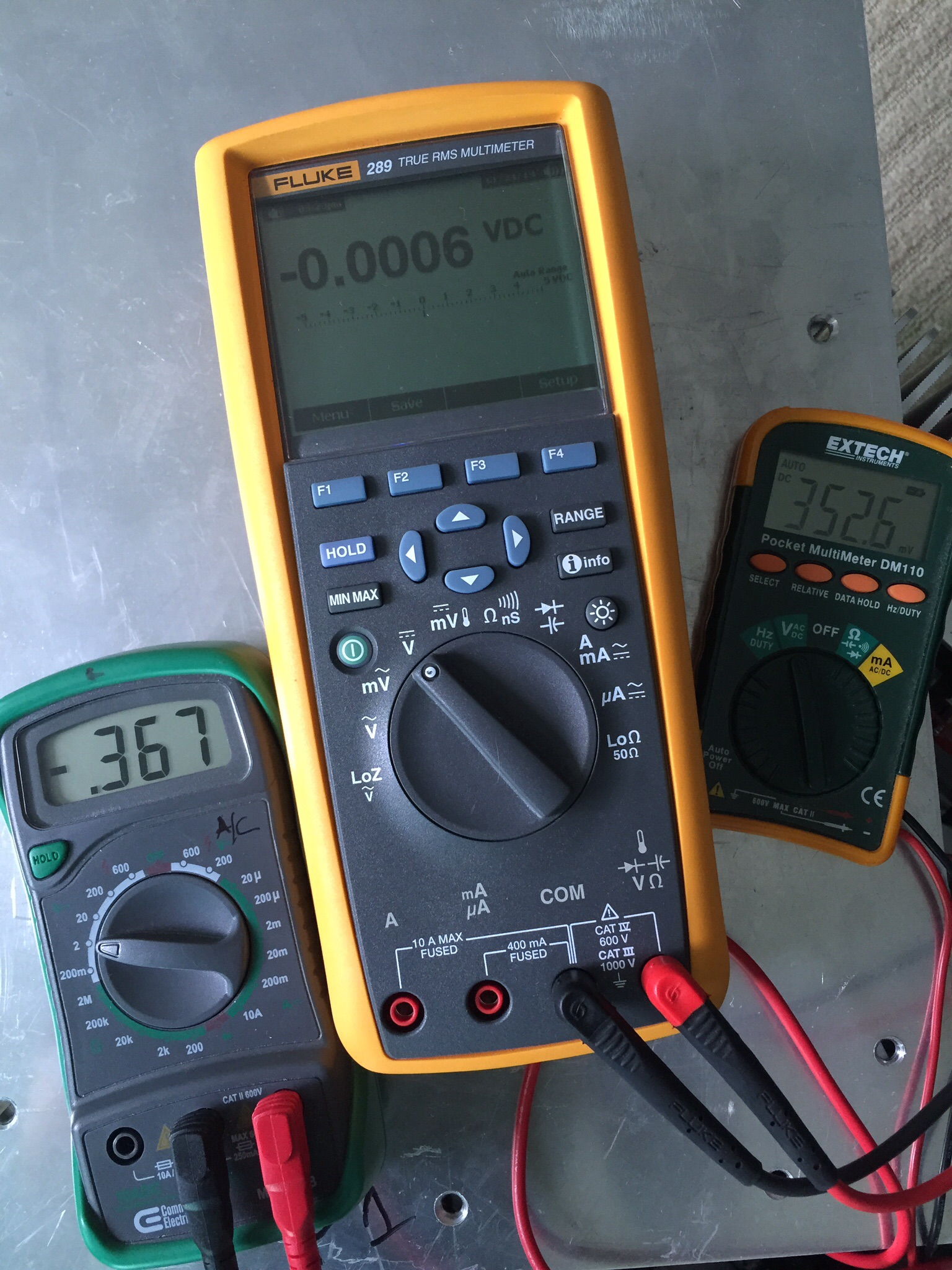

I had about 40 mins to try and rebalance the bias and offset before I had to run to the airport. After letting it run for about 20 mins to settle in I was able to get these numbers
I didn't have time to check the source resistors. Is the relationship between N and P to extreme, or tolerable? Now that I have zero offset.
Thanks!
