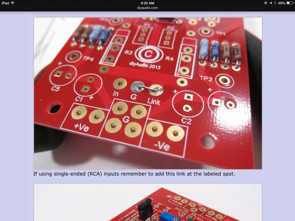

what kind of input is it there? Is that an XLR input? are you planning to run a balanced signal to a single ended amp?

You can't just feed a balanced input in a unbalanced amp.
If you want to make a balanced amp that would change the topology completely.
Or you need a transformer to change a balanced signal to a single ended one.
This is an unbalanced amp, unless you know what you are doing. Taking your direction from the silk screen is a lousy idea.
You can in this layout... but it's just going to be used as single-ended... I suggest just using unbalanced (RCA) connections.
Forgive my ignorance , but how does that work? What happens to the other half of the signal?

Thanks for shedding some light on the subject.You can in this layout... but it's just going to be used as single-ended... I suggest just using unbalanced (RCA) connections.
As I know basically zero about circuit design, some items go completely over my head. In the F5 Turbo article by Pass he mentions Patric and his "balanced" option. I understand that these boards are not laid out for balanced operation, but thought the board layout was designed to accommodate balanced input cables. My current preamp has both balanced and unbalance outputs. But my balanced cables are of higher quality than my RCA's.
What is the upside/downside to me staying with balanced inputs, as I have already gone this far?
Nothing. Well, I guess you can short a couple of pins to make it unbalanced and use your existing cables.
in my case I used a balancing transformer to take the balanced signal to single ended. http://www.jensen-transformers.com/datashts/11p1.pdf
You can see it in one of the pics.
My current preamp had RCA's only, then I added a pair of output transformers and XLR's for balanced amps. So with my current setup it's no problem running RCA's only.in my case I used a balancing transformer to take the balanced signal to single ended. http://www.jensen-transformers.com/datashts/11p1.pdf
But the future?
In my case I added a separate board so that I can switch between balanced (via the transformer) and RCA input. You can always put a switch in.

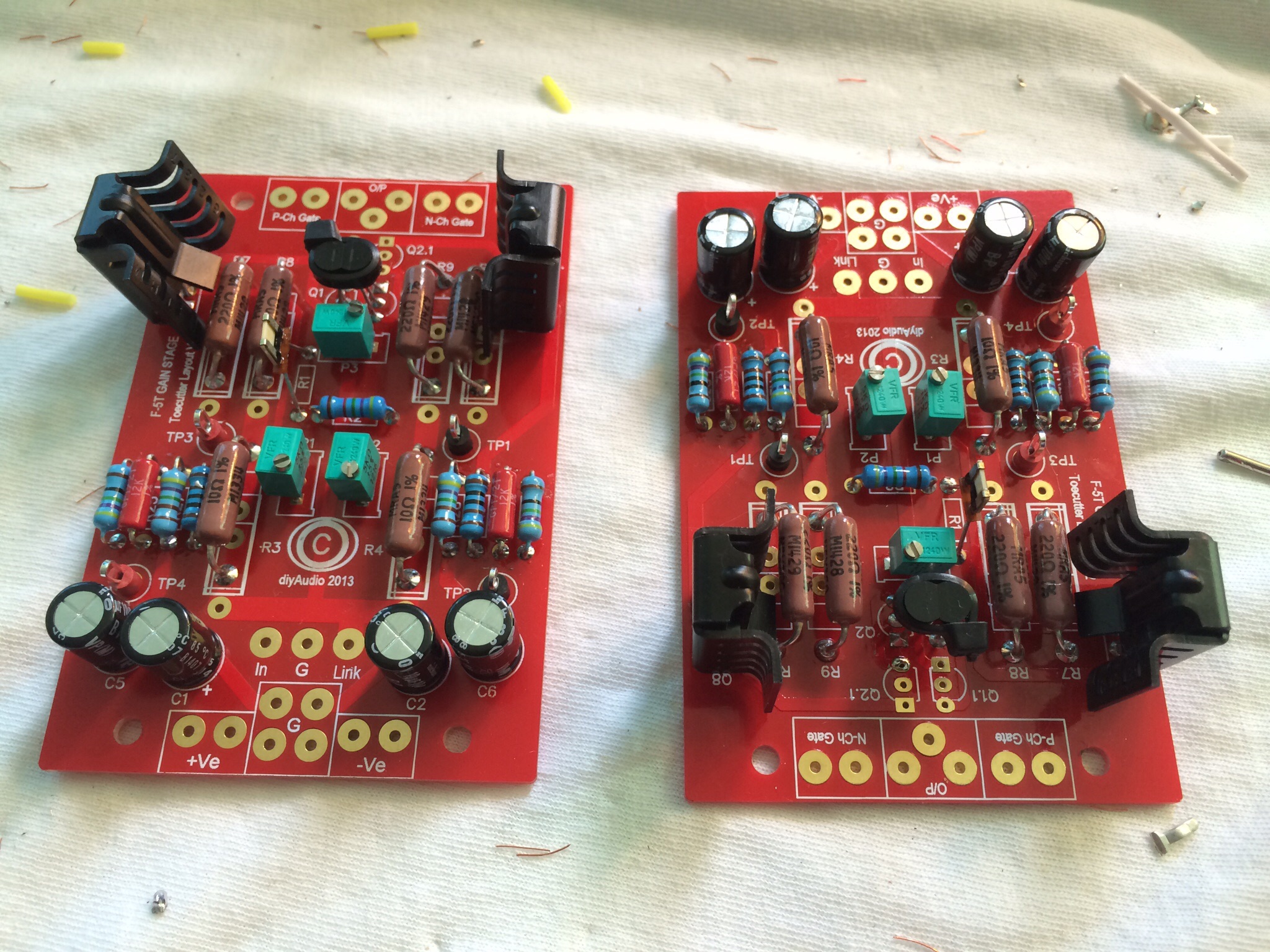

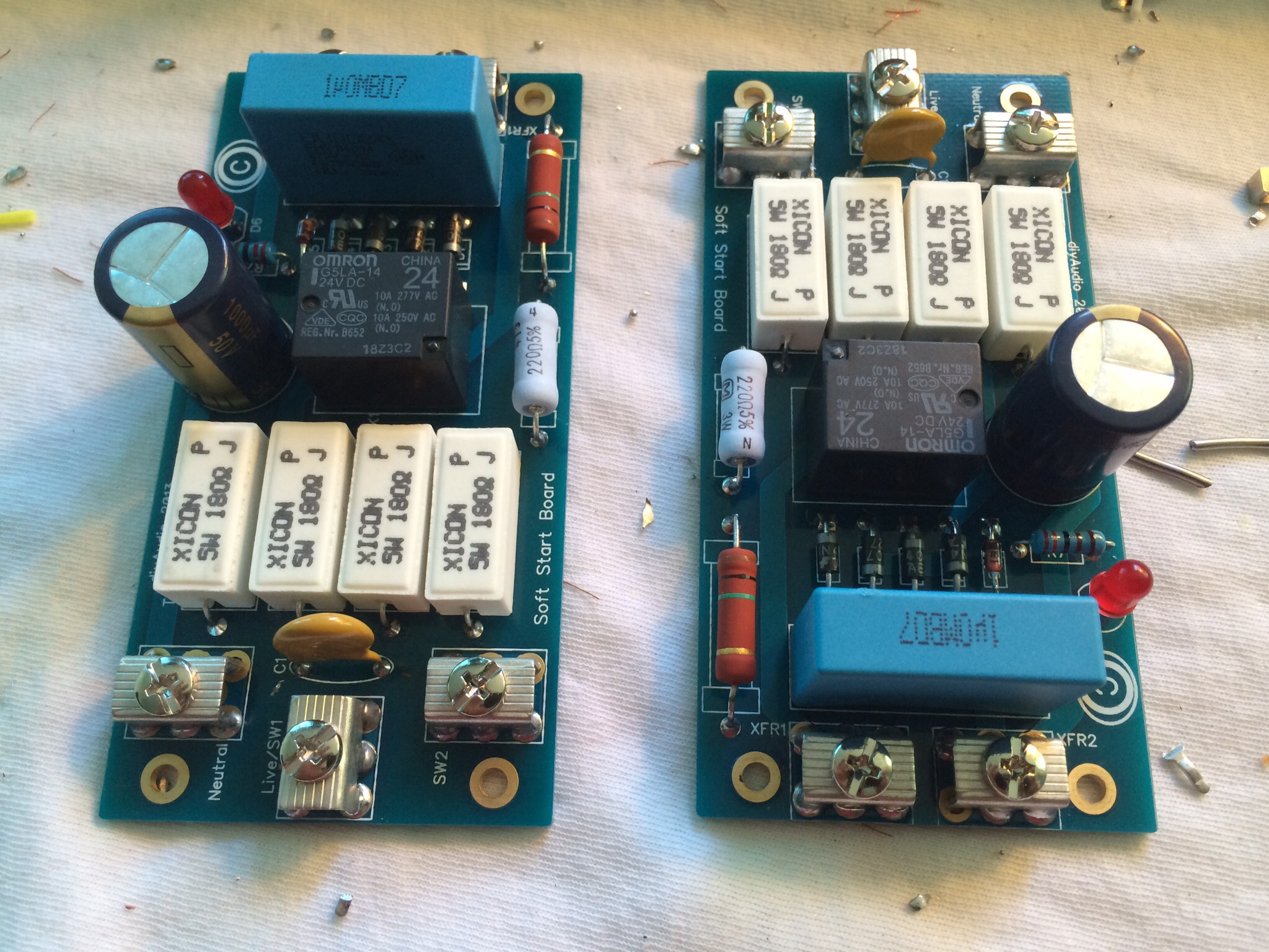

A little update. I have finished installing the N and P boards on both sides of both monoblocks. The misc straggling parts have come in and I'm ready for final assembly.

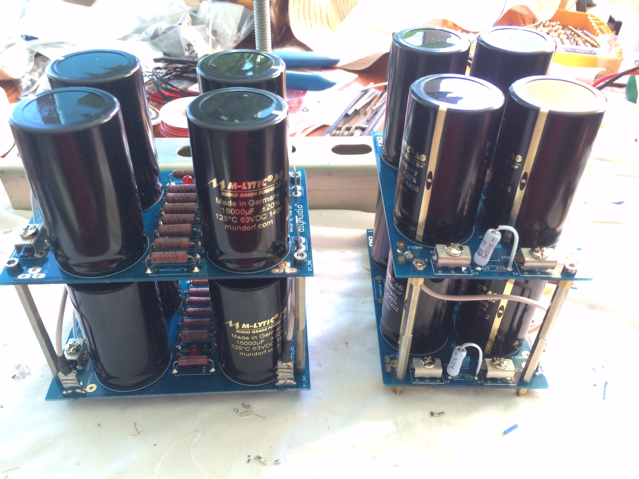

Here is the DIY power supply boards. Since I'm tight on space I am using monolithic bridges and split and stacked the board. One stack for each monoblock. I have a pair of jumpers to tie the grounds together.

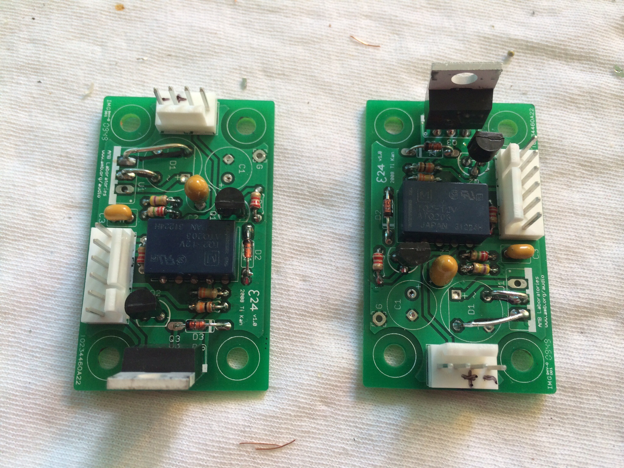

AMB E24 start circuit board for the push off/on button. I have to remove a cap a resistor and the diode as the board is designed for 12 A/C and I have a dedicated 12 VDC supply.
This board is tiny, like 1" x 2". It has a overheat feature that I'll be taking advantage of. I mounted a snap disk to the middle of the upper heatsink that will trip (open on rise) at 75 deg C.
