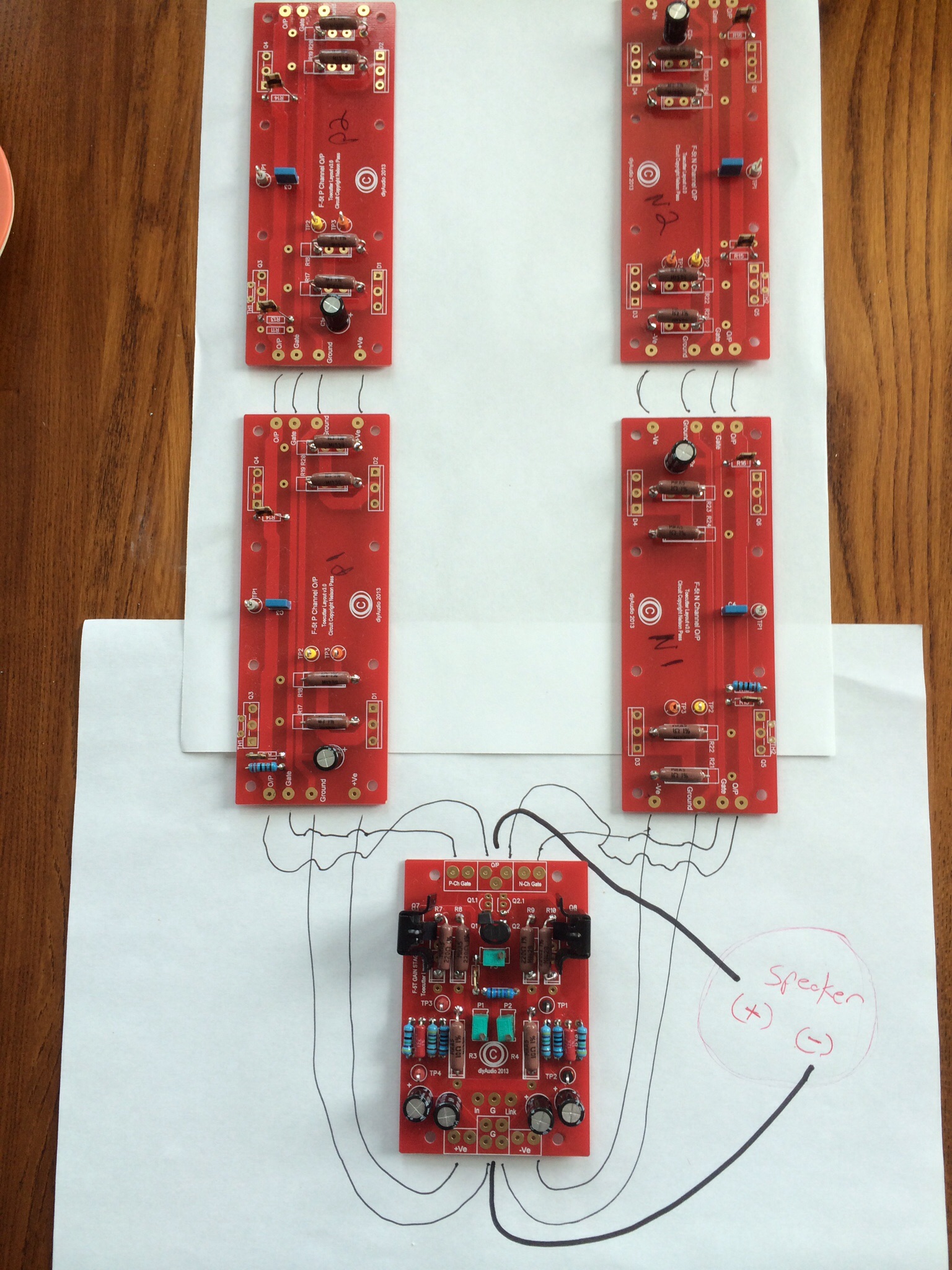

Thanks for the confirmation! And thanks to whoever designed the boards. By centering the FE board on the back panel and N and P boards on each side, make for very short connections for input, speaker, and filtered DC supply.That's perfect.
I'm just about done stuffing all the boards and getting ready to start screwing them in place and start the wiring. I'm confused about the location to tie in the speaker (-) & (+), as I've seen a couple conflicting pictures. Please review and let me know if I have it right
Have you considered the size of the wire you will be using for these connections?

I am with you on the twisted pairs. In the amp being built in this thread would you twist the gate and output wires together from the FE board to the output boards? The other connections are + and G or - and G depending on the output board and those should be twisted. Just not sure about the gate and output wires.

I don't know. The question also applies to every remote mounted transistor, the gate/base current is completely swamped by the current in the collector/drain to emitter /source loop. There is potential for interference and I have not sorted that in my head. Yet the base/gate current is sourcing current that must return in one or other of the high current connections. It seems the gate/base wire/trace should be close coupled. But that frightens me - oscillation !....................In the amp being built in this thread would you twist the gate and output wires together from the FE board to the output boards? The other connections are + and G or - and G depending on the output board and those should be twisted. Just not sure about the gate and output wires.

So gate and output to speaker binding posts would also be the Cardas 15.5?
I don't know but shouldn't the wire to the gate be of smaller cross section? I realize I am thinking this out too much but want to learn the whys rather than just doing it. If you look at the boards carefully you will see that the traces for the gates are smaller than the traces for the +,_,G and outputs.

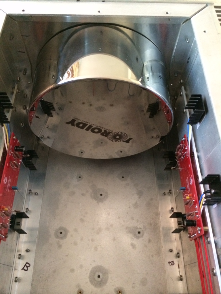

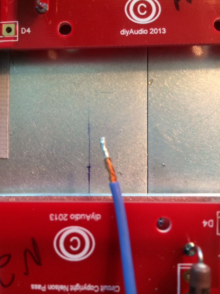

Completed the assembly of the first "P" channel side. Takes a lot of time making all the extensions. Each device is 2" up from the bottom of its sink.
Instead of washers I took Dazed2 advice and used a small heatsink. Cheap and can't hurt.
The Mur3020's are on top, J201's on the bottom
See anything wrong so far?

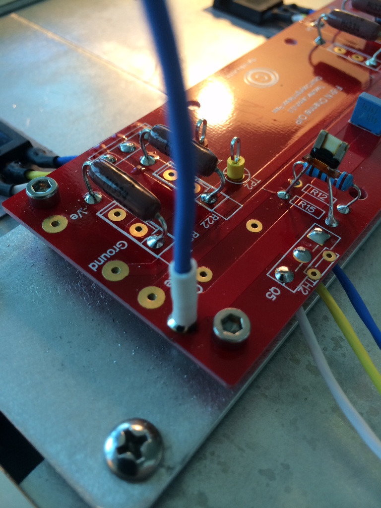

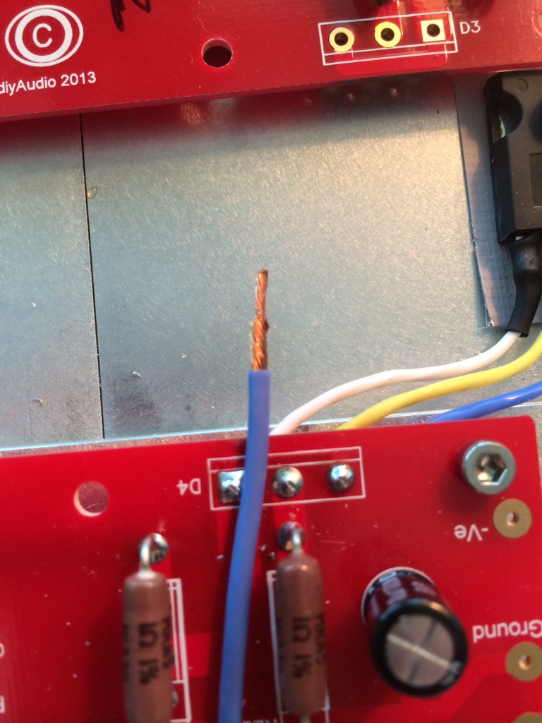

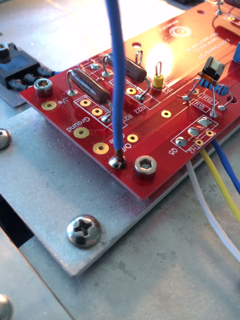

As I'm completing attaching the N and P boards to the heatsinks I thought it a good idea to go ahead and solder in the leads going to the FE board. As has been discussed, the openings in the boards for the leads are on the small side.
I'm using 15.5 ga Cardas litz wire running between the N and P boards and the FE board. The holes in the boards will only fit 22-20 ga stranded.
I had planned on wrapping the end with a smaller solid wire through the opening, like I saw ZenMod do. That works good when you want the wire coming off the board at a 90*, but I decided I need to come straight out.
So I stripped the insulation off about 3/8" up, then using the 20 ga notch on the stripper I cut the strands off about 3/16" up.
Each strand of the Litz wire is insulated so you have to flux/solder/clean the insulation off and make sure the ends are well tinned before inserting into the boards.
I filled the solder pads on both sides of the boards and then re-insulated with shrink wrap.

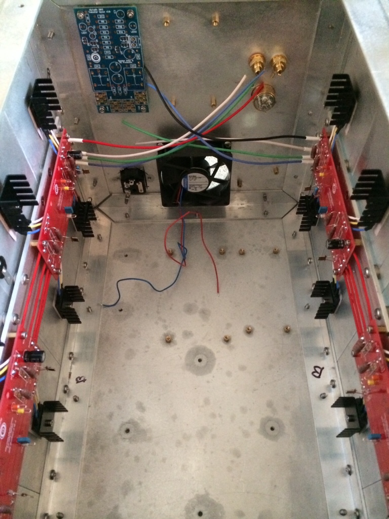

I can't believe how long it takes me to assemble. It took me about 8 hours this weekend to mount the N and P boards to the heatsinks, wire in the extensions to the devices on the heatsinks, and solder in the leads to the FE boards. (1 amp only). Second will go a little faster.
But anyway, here is a couple pics.
