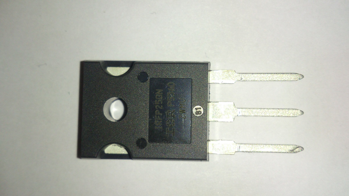

I have bought a couple of 25 x IRFP250Mfrom Mouser.
That is a IR 5. Generation- the newest! part with a bit lower Cob- and i like it, all build
in now- ACA, Aleph J, Circlophone.....

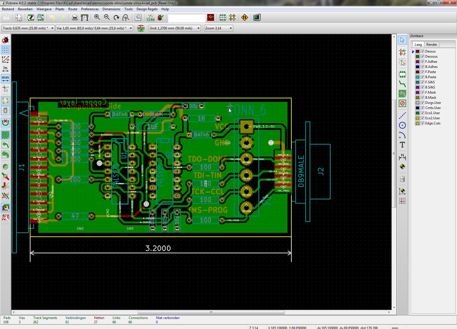

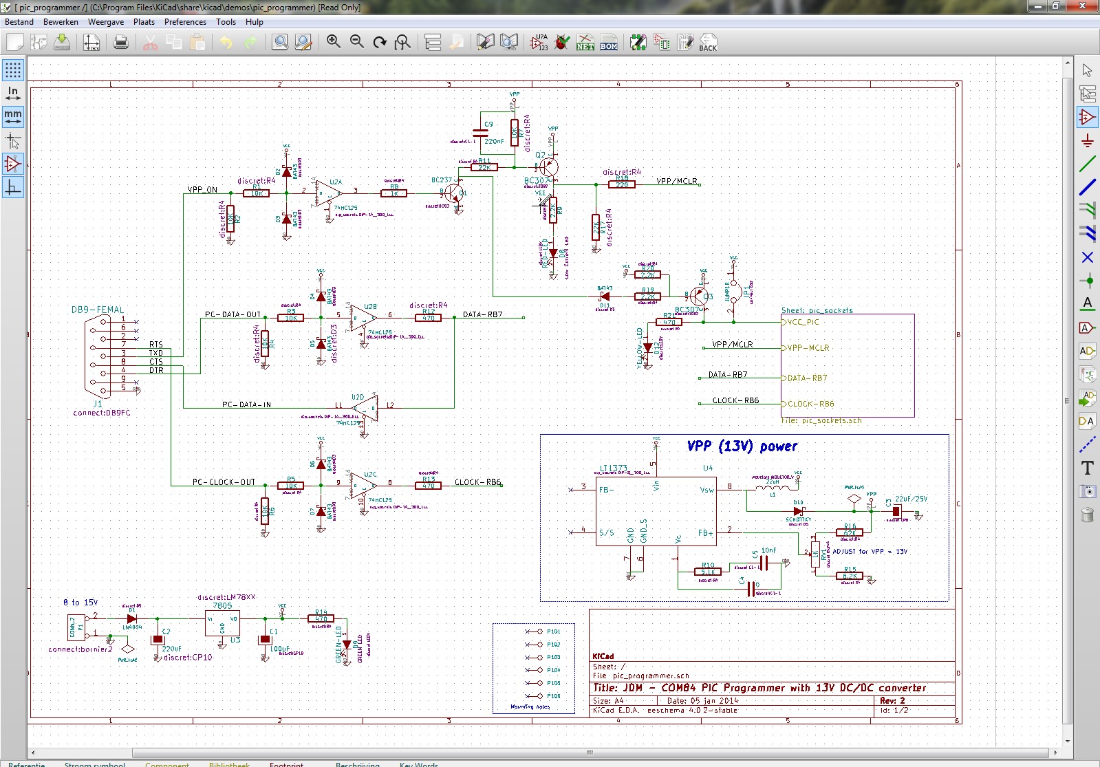

I have download the free Kicad, it is grown nicely to a professional program.
regards
