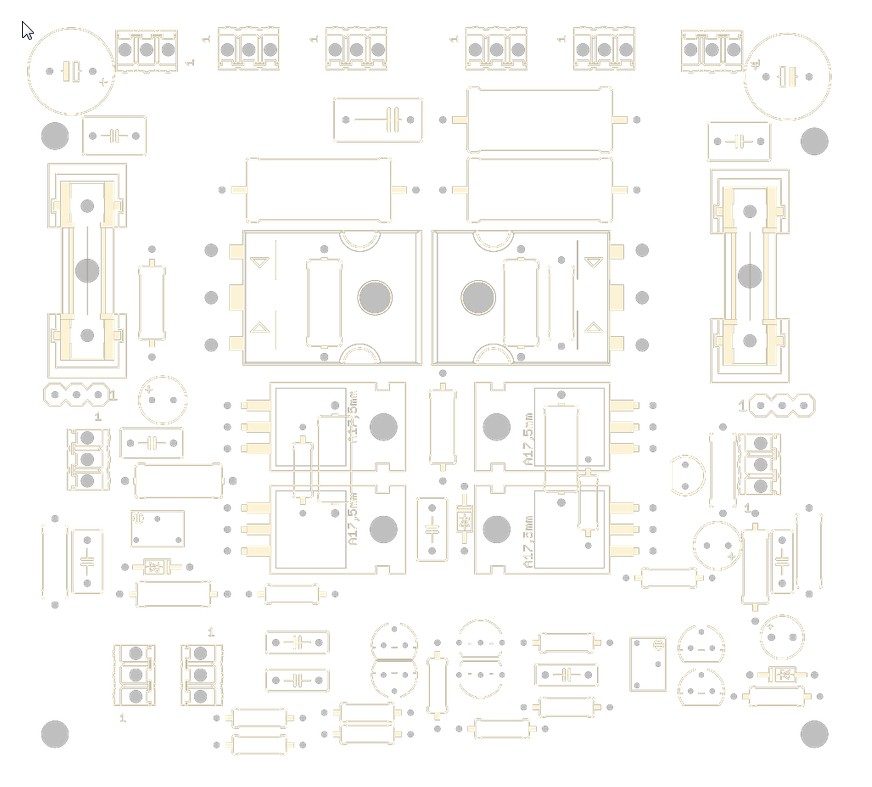

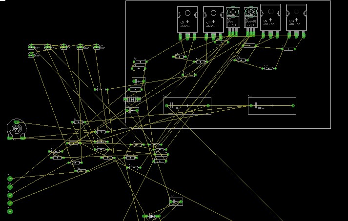

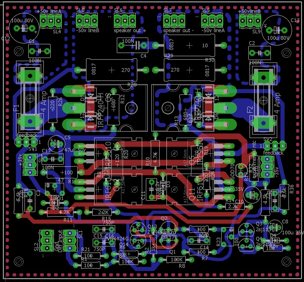

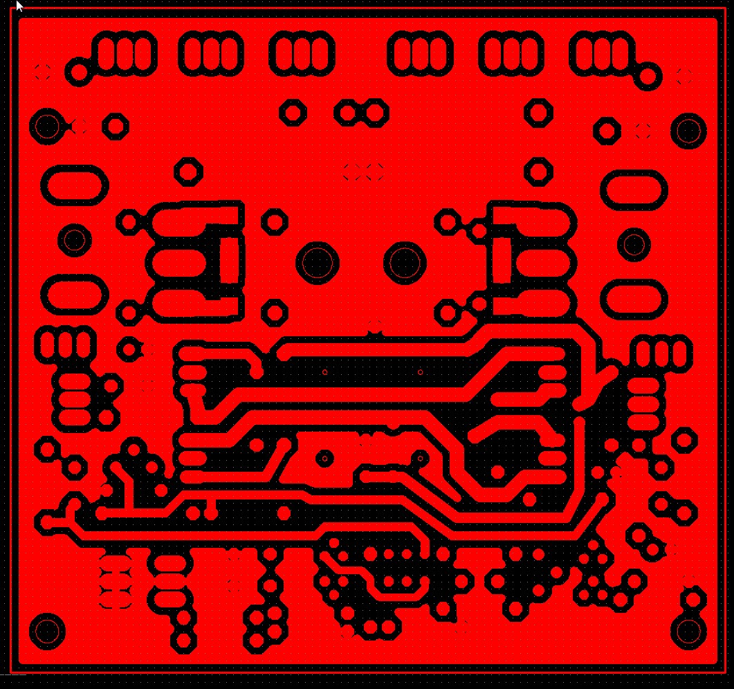

New correcting zip and schematic simulation for upset of amp, so you have a start.
Keep me informed.
The last picture is most current one, and also the zip file included.
The board has no errors, that is what I like about pcb software who help me prevent that, I have do a urp from a pcb house for extensive check, and I do not see airwires anymore what mean everything is connected.
but it is oke to test it afcourse, I have put everything in the zip file, including pcb design, so it can be tested.

Thanks for the updated files and images of the schematic.
Does your Eagle software generate an automatic BOM? 🙂

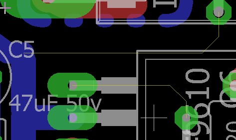

If you do drc in eagle and have miss a small trace it do not give a error, just a airwire, with diptrace it say alarmm alarmm haha.
this is a minus also, I need a audible or tekst window saying one trace is not connected. I see a airwire show up, but if it is a small disconnected wire you do not see it.
regards

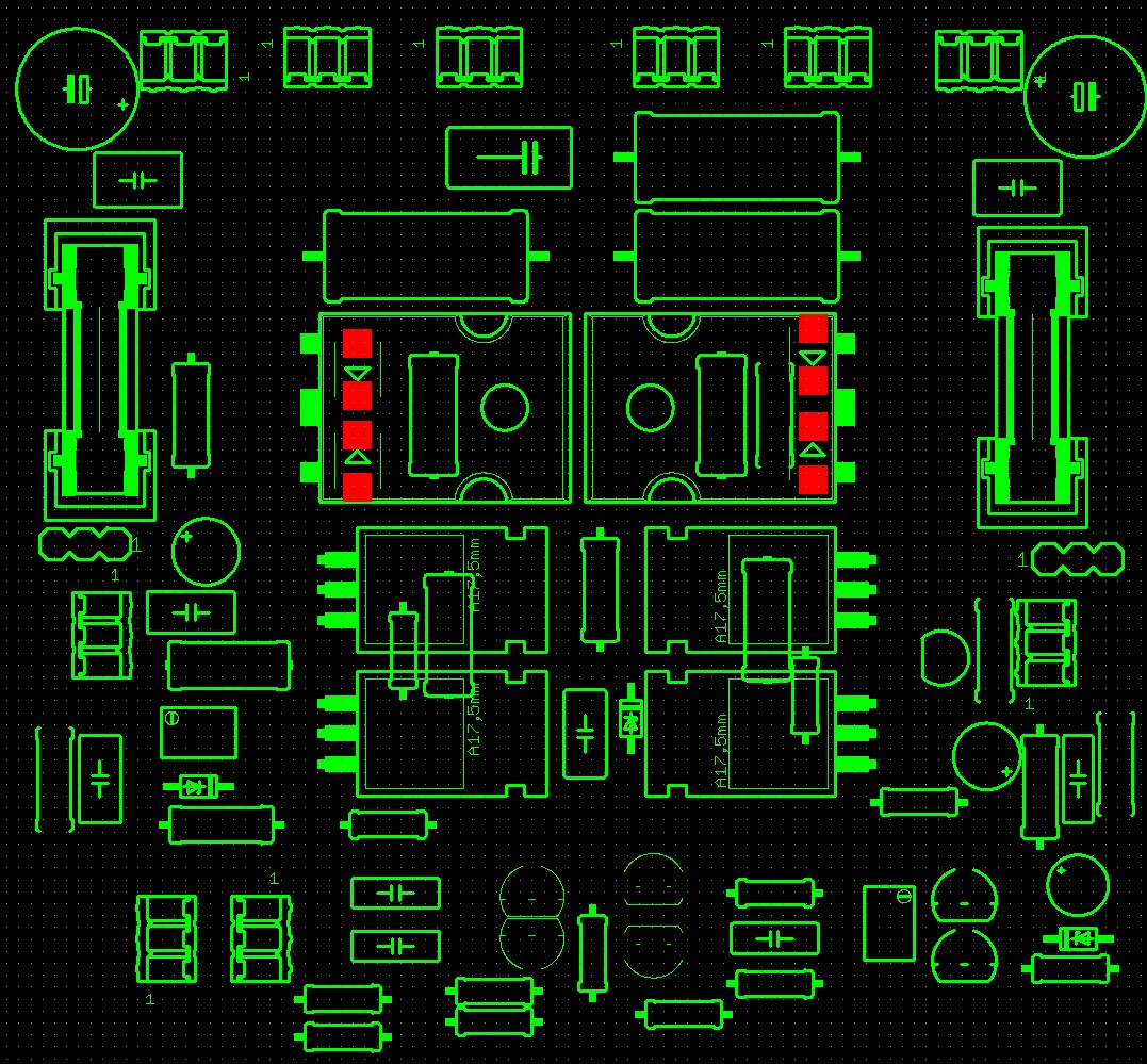

thats the reason why I said you should do a ratnest, on the left hand corner you will see number of airwires still remaining. then you switch on only dimension and unrouted layers and see where the airwires are, no matter how small. use a bright color for "unrouted" layer so that you can see!
But....
If you dont know how to use eagle or cant 'see' air wires, you should use diptrace, all the best!

Hi Prasi
I do see airwires, that is not the problem, however most software do use better error generation, all pro software do giving a message, with eagle I do need to be a type goeroe but I was already started, the next time I go to diptrace or ultiboard in multisim. I do not make pcb,s every day, so I do not now everything about eagle, but did find that more people do not like the way it works, me included. Why eagle do not highlight a not connected wire like ultiboard does or other software?.
I have zoom the pcb to search for airwires but all is connected. see what happens when not in picture but eagle do not give message about it. I agree that eagle has a very nice graphic outlook, very professional looking.

As far as I see this is a ratsnest? so did thing the right way my friend.
X and Prasi
I have now follow your advise and test the board for open connections, did need to studie it to find out how, but i do know now, still so much work to set things up in eagle in compare to others, but worth it.
X the bom, (carefull we are allergic to Bom here) is also present in zip.
I did find errors, but only a wrong shape for the j113.
Now all is oke, did not find trouble.

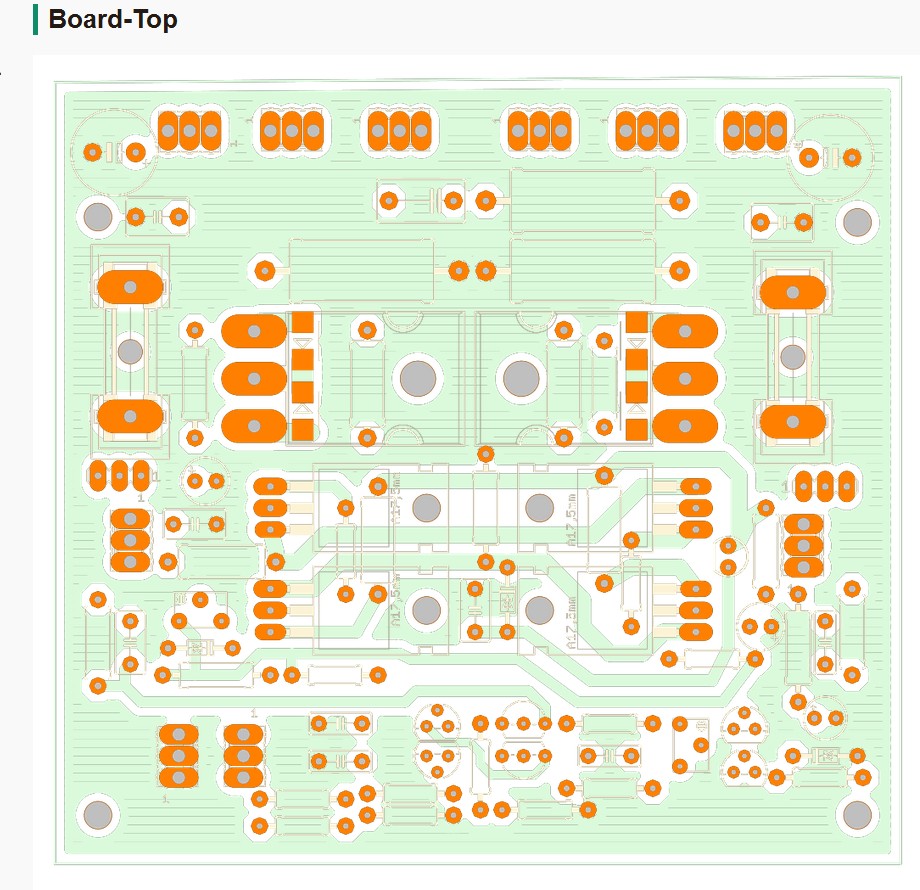

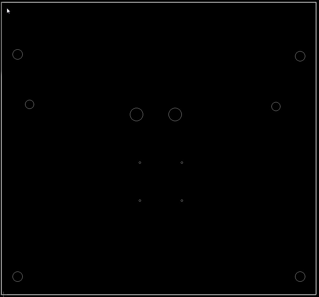

I tried uploading the Gerber zip file to Seeedstudio Fusion and I get the following error messages:
It seems the format you have is not standard. The above files seem to be in the zip archive you provided but the fab house has trouble reading it. Does anyone else have better luck? All the Gerbers that Prasi or Sonal have provided thus far have worked without errors.
I will try uploading to PCBway and see if they give me errors too. They have a human review the file so takes time.

File comp.ps was not identified.
File silk.ps was not identified.
File solder.ps was not identified.
Project does not specify any drill hits

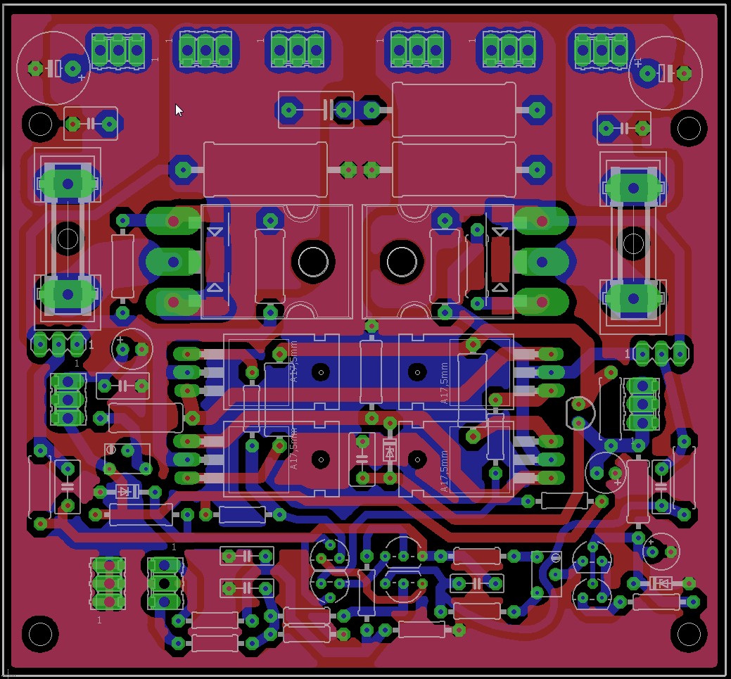

ok kees,
just trying to suggest thing or two i learnt for ease of design validation of your design. it may be better to use white background and bright red unrouted layer color for checking of remaining airwires is all i was saying. once you press ratnest, on the lower left corner briefly you will see number of airwires remaining. if it says briefly "nothing to do", you are good to generate gerbers🙂. use gerb274x.cam (available in default location) for making gerbers and carefully select only the layers you want active on each of the gerber section (e.g. plc, cmp, etc), for drills you can use excellon and generate a .drd file which will be acceptable to almost all boardhouses.
reg
Prasi
ok kees,
reg
Prasi
Thanks Prasi
I have check and see nothing to do, when delete one trace it says one left, so yes now I can see what I do thanks.
For output cam, most of the pcb manufacturers do give scrips for that so always things are oke.

Thanks for checking. I wonder what's the issue with this one manufacturer?
Edit: I got a reply from the second PCB house and they also report a problem:
"Sorry but here a problem with your Gerber files : there is no Drill file (.txt/.drl) / solder mask layer
please check it and re-uploading the correct Gerber files on our site for check again."
This is PCBWay - so there is maybe a missing drill file?
If you can, please generate another set of Gerber files following the advice of Prasi?
reg
Hi X
I do follow Prasi advise put a drl in for you with eagle standart excellon, then it will work, the .txt can then be removed.
