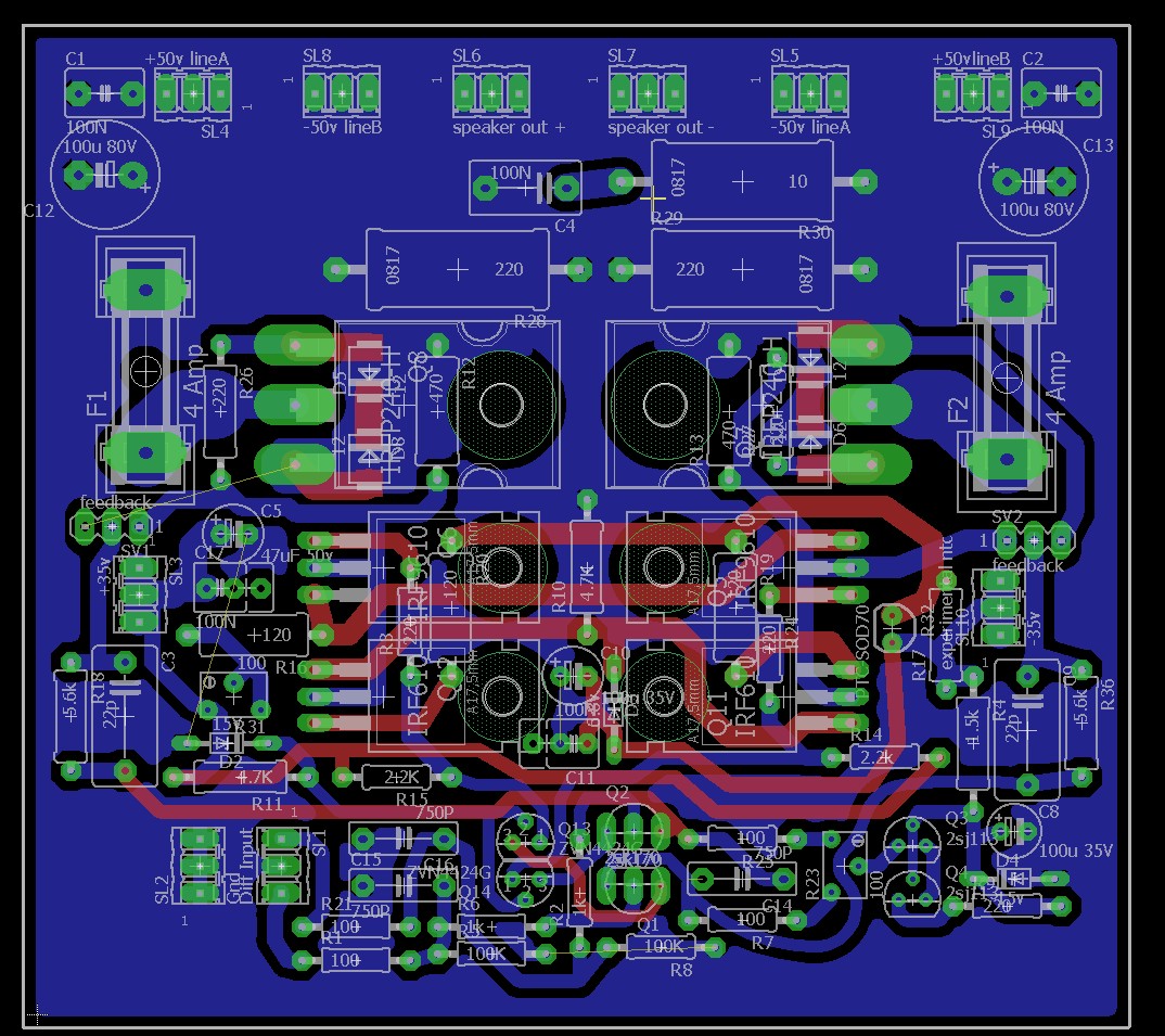

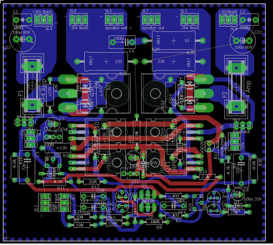

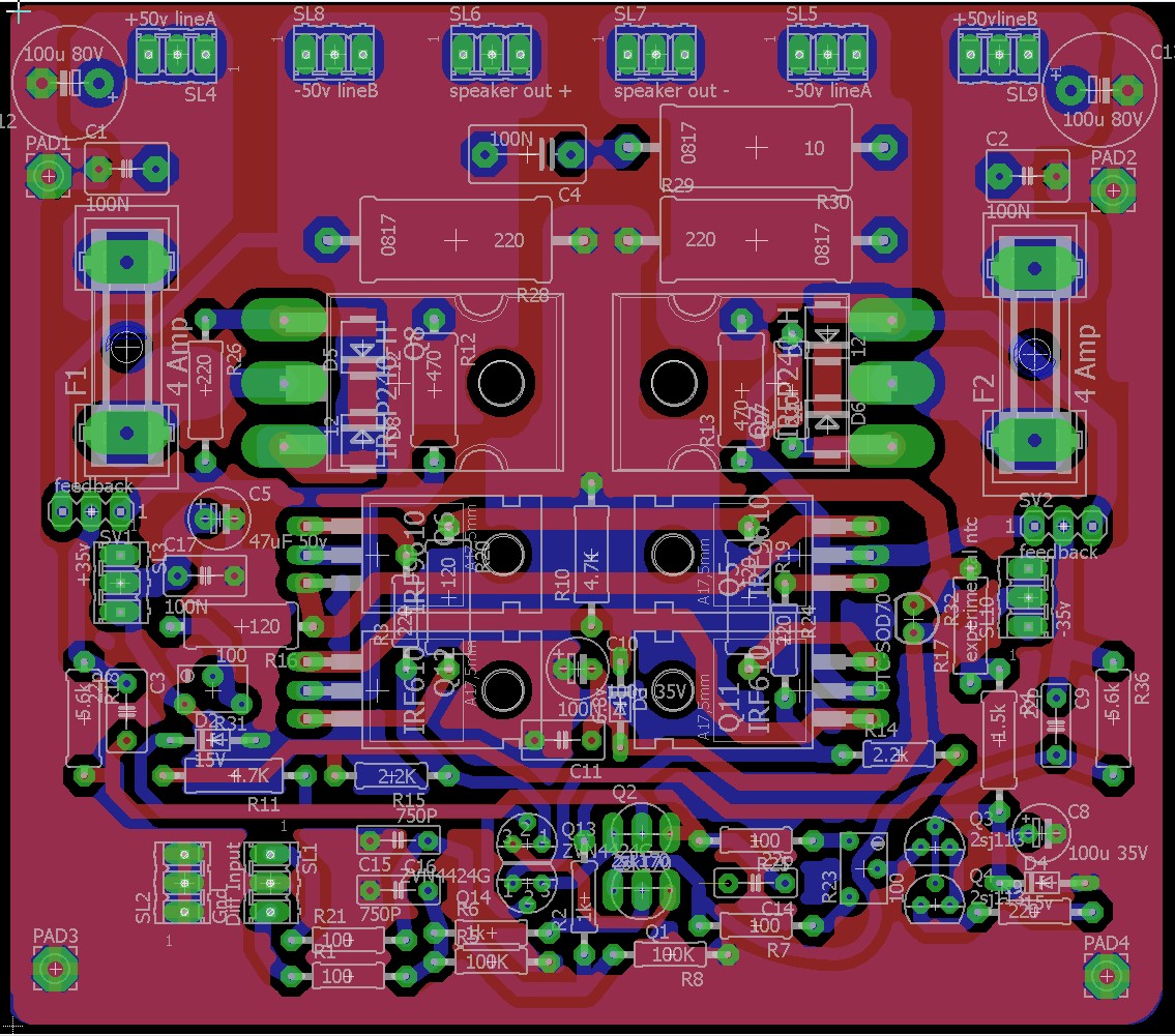

I do not like eagle this time, I have made some polygons and it connect to each other, or move traces on his own.
I use professional pcb software because it check lost connections, I do over to diptrace when this one is done, eagle looks very good on graphics way but has such strange behavior is compare to others.
tomorrow things are ready, and if people now why eagle do work such rare way I like to now.

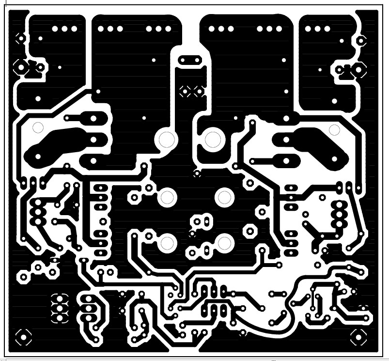

Yes but only as you see on picture one and two on previous post, the polygons even when coupled to two different nets it still connect to everything. I did make poligons for the parts where current flows and connection to these nets, however eagle do not right making shorts.
I do need to find a way to prevent this.

if you share the file with I can try to understand whats going on and may be try to find a solution.

This was a eagle error after I did search I need give them ranks, now it works
that was also the trouble I did mention off, eagle looks good graphically but diptrace do better and more easy, errors are ruled out with it..

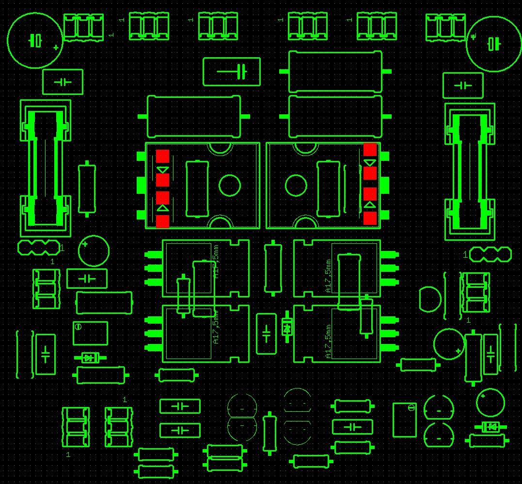

I have now make gerber, but only test and postscript, so you can see how it looks, when you need changes in pads or components you need to tell me and with the dimensions given. And the kind of gerber what you need and maybe drill files.
The caps where sound go through are silver mica, these do fit.
I do go as last action check the mosfet pinouts if these are right now this evening.

Hi Prasi
Did find it, I need to rank them, like 1, 2, 3 etc.
then it do work for me, eagle needs to be told everything, it is a minus.

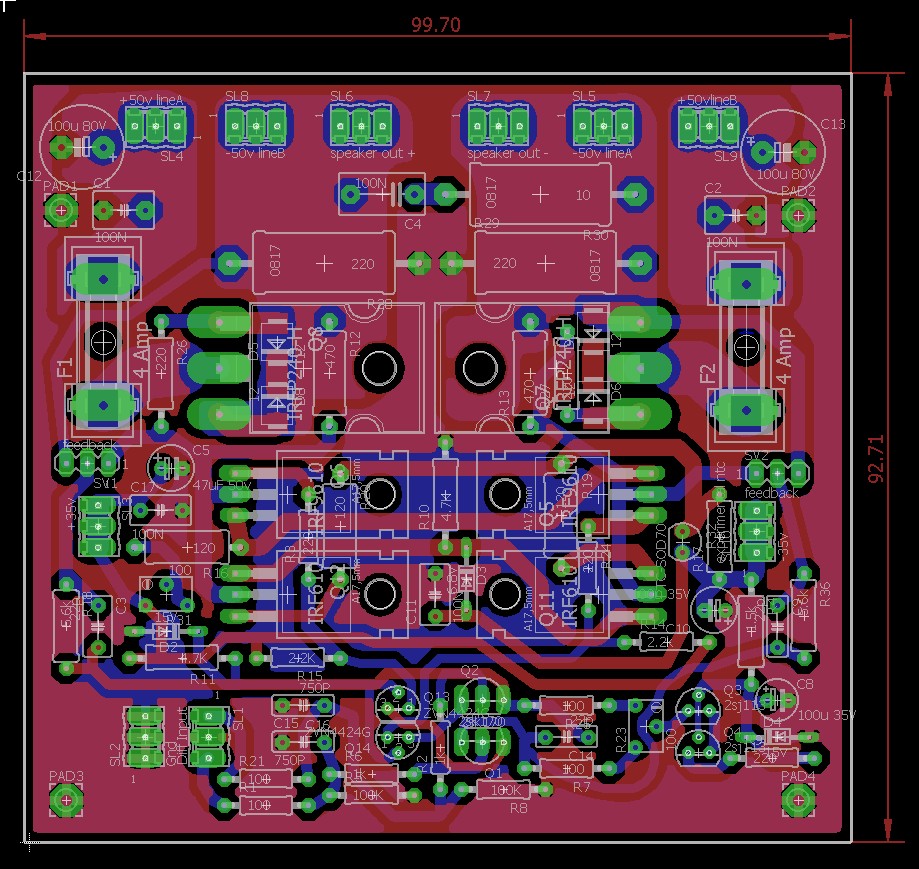

Hi Kees,
Looks very nice. The size appears to be 103mm though - can you please trim to 100mm max? Also, it seems we are back to a dual voltage supply now with 50v rails and 35v rails? 35v is just for the VAS is that right? So what is max current needed? I can probably make a regulated shunt supply from main 50v supply if under 1amp.

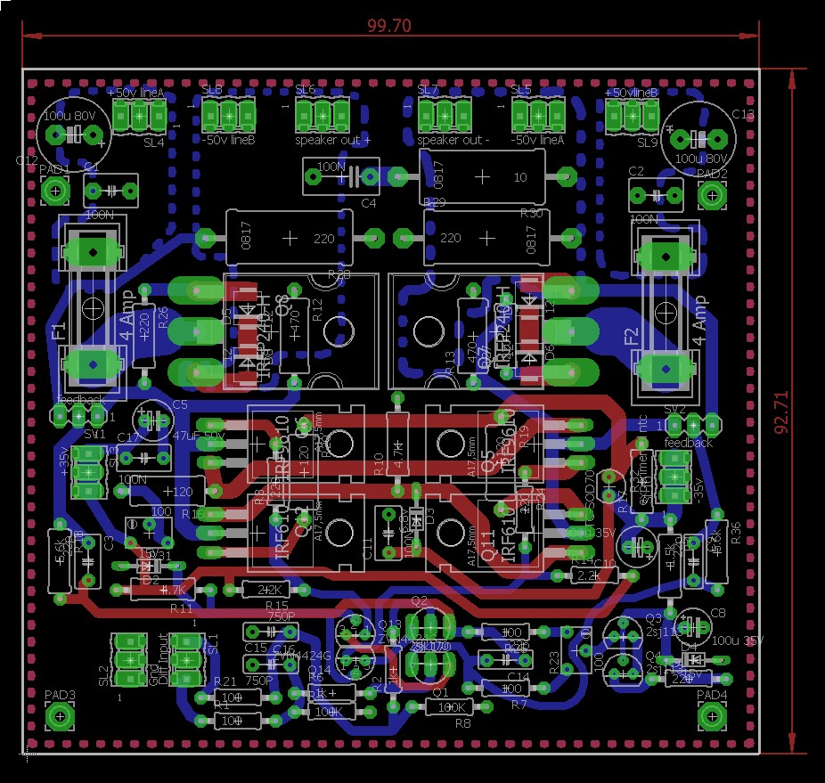

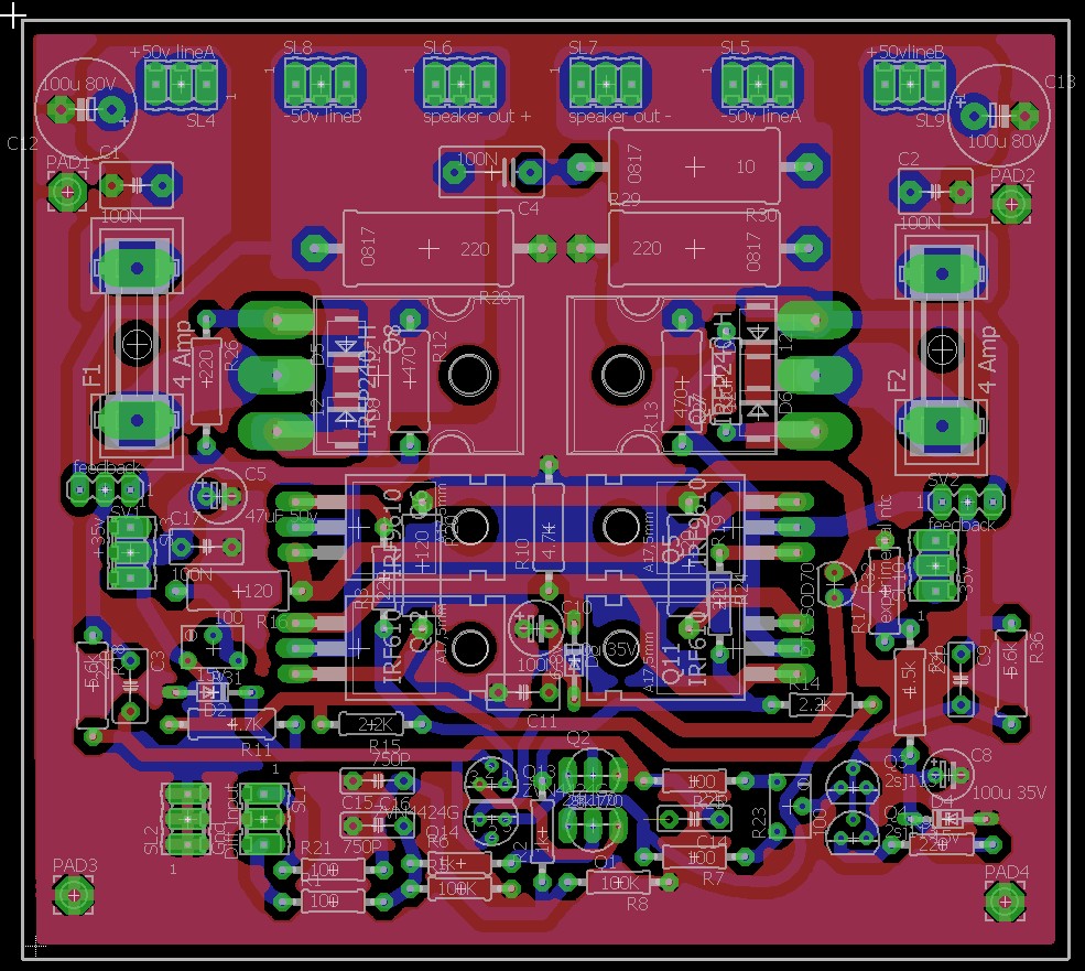

have X squeeze the circolotron amp in a double sided 100 x 100 mm as you ask, I did need to put transistors closer to each other and change some more things.
I think it looks nice, I have keep a big ground and short connections, I ask give a sign when need some different part. And I need to now what kind of output you want for the pcb making, like gerber and drill files.
For the supply it is a power amp you need some more then one amp and 50 volts, look at peaks of 10 amps if you get loud, the preamp has plus and minus 35 volts and need 500 mA or better 1 amp if you have, both work last has more beefy capacitance driving.

Looks very nice Kees. For all power/speaker connections I use the FASTON style spade PCB solder connectors. They have 5mm pitch I think. Maybe 1.5mm holes thru plated with small pad on top side for solder fillet to relieve stress.
Like these:
I have 2.5 and 5 mm used, both can be used, pads are bigger because then it is not easely damaged, you can solder both sides. I do not now if eagle allow small pads on top and bigger on bottom layer.
I have also connector wo you can with a jumper choose for local or full feedback, possible with local you get tube sound like respons.

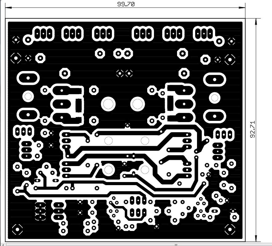

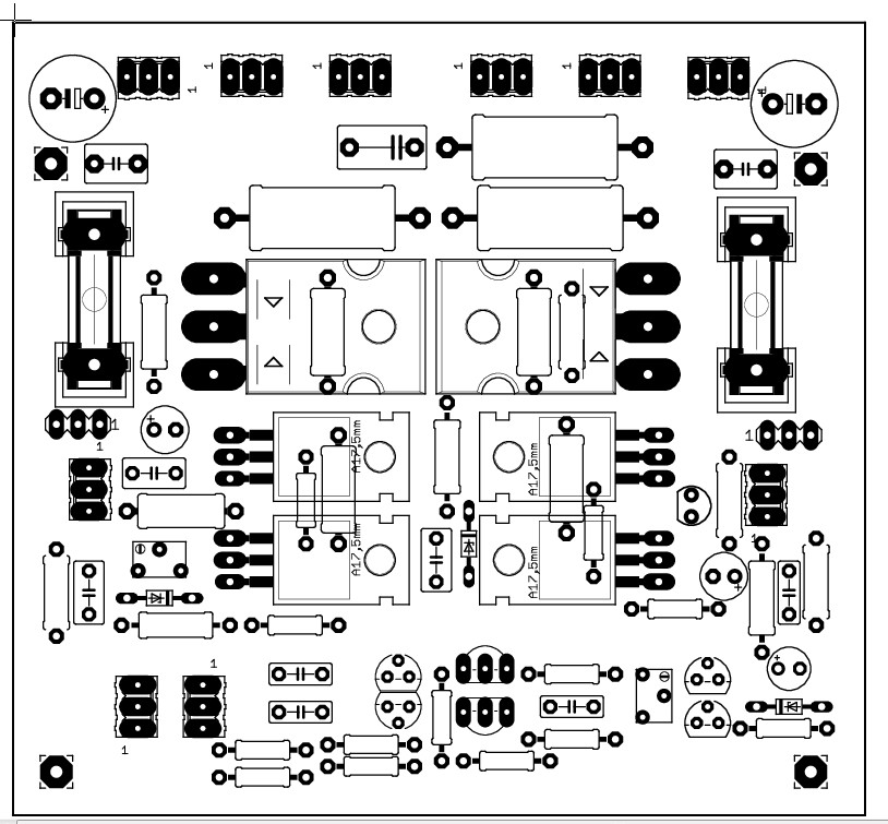

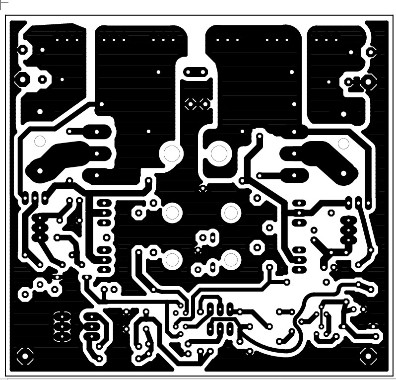

Pictures are postcript output so you can see more how it looks in gerber.
how big are the holes of the connectors?
regards
Holes are big - about same as for pins on IRFP240. 1.5 mm dia should work. Don't go any smaller and large pads are great.
Left polygon is now clean upped.
the space for connectors are big ebough now.
now gerber can be generated, do it tomorrow but give me al the info what you need, type of gerber, drill ets, maybe you have a job file for eagle.

Here is the drill and gerber in a zip. and seem now I am done for the time being with the pcb, it need to build op stage for stage and setup correct idle and voltages, simming is not that perfect. the drivers need to have 25 mA and the Jfets 4 a 5 mA these are indepentend so play with it is the way to go, I go myself make a pcb and start with testing.
Top and bottom copper (.GTL, .GBL)
Top and bottom solder mask (.GTS, .GBS)
Top and bottom silkscreen (.GTO, .GBO)
Drill file, 2.4 leading (.TXT) Tell manufacturer it is 2.4 leading drill file.

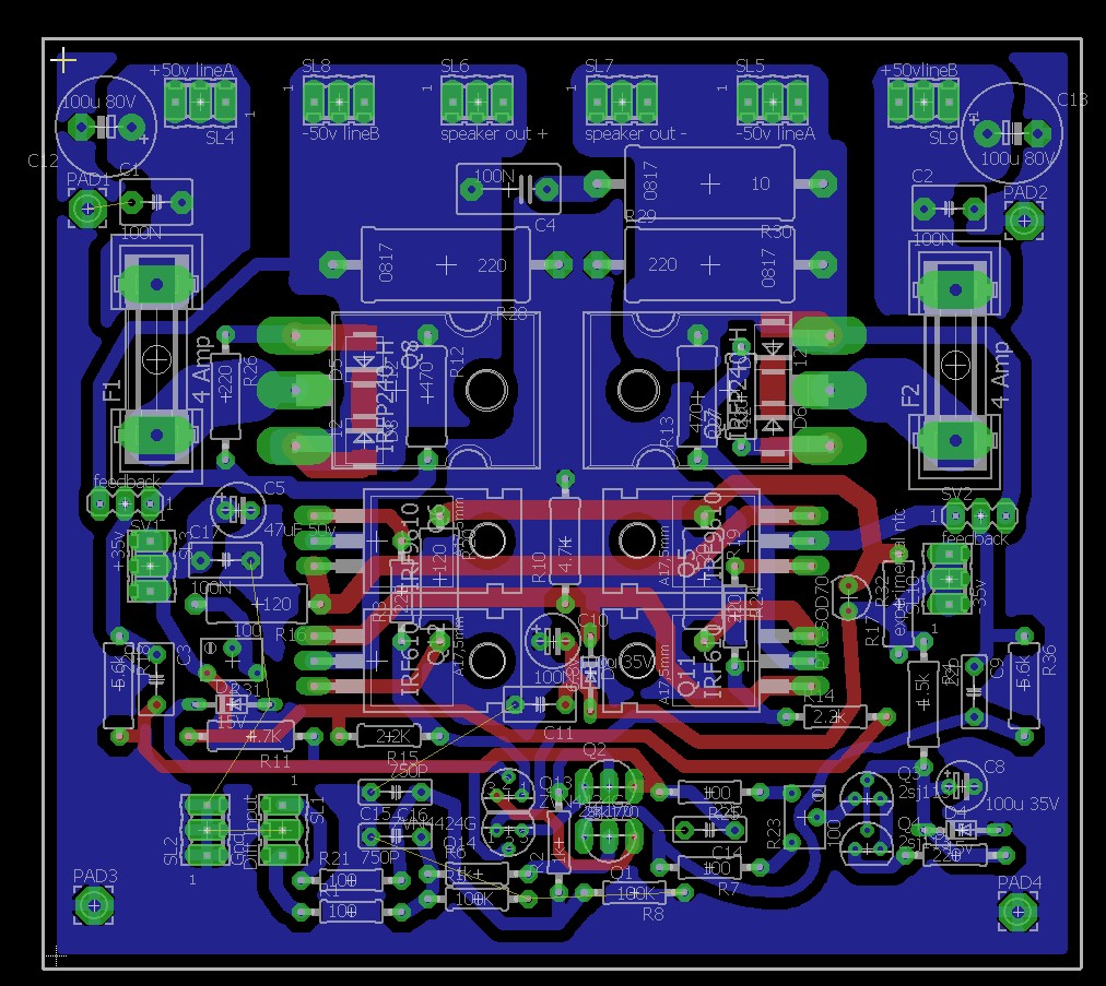

Thank you, Kees. This is a beautiful layout.
Is there an image that shows the traces (top and bottom different colors) and component silkscreen so that we can double check routing for accuracy? I know you say you use Eagle error checking - but I would still like to be able to follow if visually before sending off to PCB fabrication house.

Or is what I am talking about the same as this last image - which is the most current?
