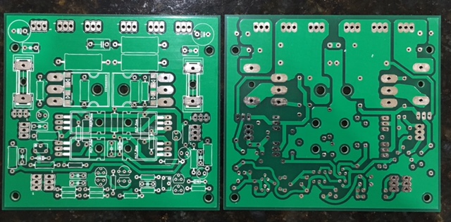

It is in Gerber package but I only use online Gerber viewer to check before submitting job to fab house. Good to have either png file or PDF for easy reference. Probably another week before boards get here to US via HK Post. I have to get Sprint or Eagle one of these days. Never did a layout.
Kees,
The PCBs arrived. They look good - but no part labels apparent. So we will have to go off a separate stuffing guide.

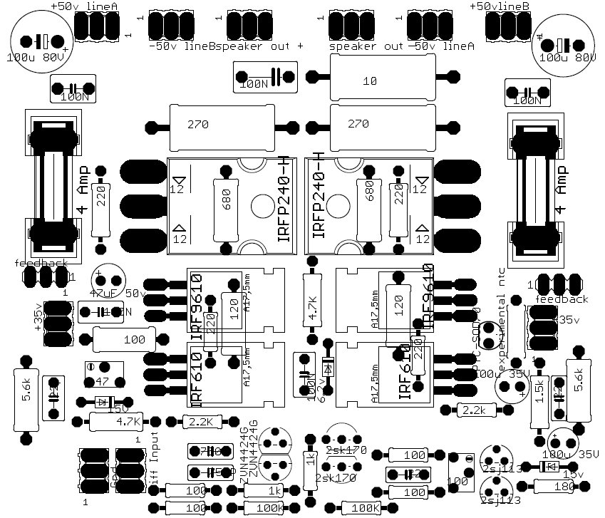

I have zip the stuff so you have a way to stuck the components on it, it is a fault of the pcb maufacturer?.
looks further oke, I think it go to be a nice little circlotron with balls. If we get it stable and working.
When I receive the pcb I get also try it and keep informed, I have experience with this kind of build ups.
regards

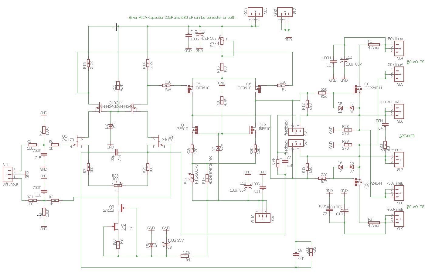

Just my thought ...
-both zener diodes D2&D3 need some parallel connected bypass cap ,
- OPS ground reference resistors R28&R29 can be with smaller values , 100-150R / 2W .
- maybe I`m wrong but I think that balanced GNFB lines need to be interchanged
All the best !

Hi Friend Banat.
Better wether there in belgrade? as I was use to, and nice tomatos who taste nowhere better then there.
Oke, I do not now if for mosfets the zeners will give through the noise she have, with bipolair it does but if it can be measured with modern parts and she sit on source side..
The reference resistors are simulated for higher output voltages, just to be shure it can not burn, can be indeed lower for other demands.
The feedback connections are dependend of fase, I did simulate it this way so it has to be correct otherwise we have a nice transmitter, the jumpers can be used for local feedback, so whe can maybe have tube like sound.
All is simulated, still after that we need to build up step by step because as you now mister murphy can not be simulated.
But I am proud that it is still some small corrections, this you get when not invent the wheel again
have a nice evening.

The A and B belong to each other, it are two voltages from one transformer as need for a circlotron, but for pcb design I did it this way otherwise it get messy.
so voltage A and A is from same winding.
So to be clear, I will need a quad power supply for two stereo channels? Or in other words, qnty two center tap transformers each with two rectifier/cap banks will be needed? Or can I make qnty 4 rectifier/cap bank PSU's from one large center tap transformer?
Maybe a diagram of PSU and amp would be helpful because I am not clear still what is meant by A and B PSU?
If you look at the schematic you can see how it is.
I go drawn a schematic so you can see how, I think an single transformer with two separate 28 Volts windings will do, you can even took the preamp voltage from it with a regulator who give high separation of such.
I let you now.
regards

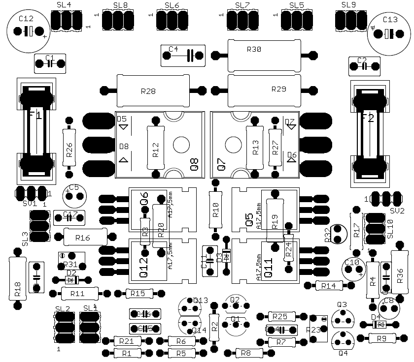

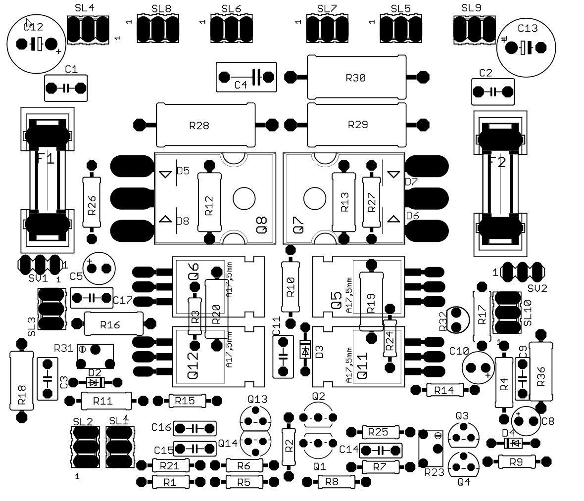

Can you let me know the resistor power for the following?
R28-R30 (5 watts?)
R12, R13, R16, R18, R19, R20, R36
R4, R10, R11, R17, R26, R27
The rest of them 1/2 watts?
Do
I am going to guess that by the size, smallest is 0.25w, next is 0.5w, next (R12/13/18/19/20/36) are 1w, and big ones are 5w. Probably 3w could work though if one looks at what actual dissipation is.
