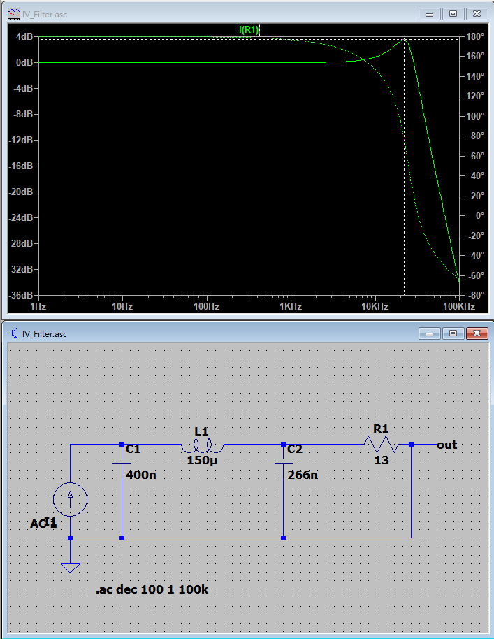

What's missing is a connection to GND for R1, right-hand end. The far end of R1 is designed to go to the virtual earth (pin 2, -ve input) of an opamp. Then you'll get current flowing in R1 - right now looks like you've an open circuit.
In the second plot you're seeing an extremely high Q due to it being an undamped circuit. R1 provides necessary damping, but only when current can flow in it.
Thanks. It works now.
Poting
Great - looks the same as my plot!
I designed this filter to do NOS droop correction - so it could be retro-fitted to any NOS DAC that's using active I/V (opamp or discrete) but I've since thought it could be a more generally applicable tweak to any DAC with current output where external opamps are in use (think AD1955 and PCM1794). For those applications the NOS boost won't be desirable - if anyone's interested I can tweak the filter to give a flat response.

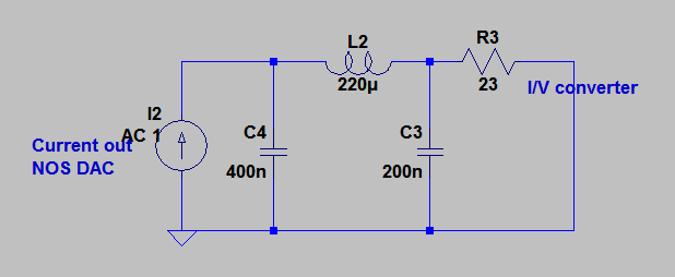

I can't recommend a filter which stays flat all the way to 96kHz given that lower bandwidth is going to reduce noise and is known to sound better. Here's a version which is flat to 20kHz (about 0.3dB down). Note there's 23R for the termination resistor - for 10ohm input impedance you'll need 13R between the filter and your I/V.

Does the SIM account for the R (damping) of the inductor?
BTW is it air core or not, and if not, what is the suggested core? sendust?
I assume this is done on a PCB so there's no significant parasitics etc?
I would very interested in seeing how the circuit performs in a real application vs the SIM prediction. Are you planning to try?
I assume this is done on a PCB with very short traces so there's no significant parasitics etc?
Yes, I will try that. I am using certain ferrite bead at this moment. I wish to filter out more HF grabage before IV stage.
Yes, but it turns out not to be particularly critical to this.
Air core for 150uH is going to be fairly bulky but might work. It'll be sensitive to picking up all kinds of stray noise though so I'd not recommend it unless you're ready to shield it externally. The suggested core is gapped ferrite (as used by the SLF7045 range I've already mentioned).BTW is it air core or not, and if not, what is the suggested core?
Are you kidding me? Sendust is great for power supply chokes but too lossy here.sendust?
Parasitics will depend on layout, however its a very low impedance circuit so a few pF here or there won't be a concern.I assume this is done on a PCB so there's no significant parasitics etc?
I've been using the NOS droop version myself for over a week. What would you like to see? I haven't plotted its FR but its sounding great.I would very interested in seeing how the circuit performs in a real application vs the SIM prediction. Are you planning to try?
