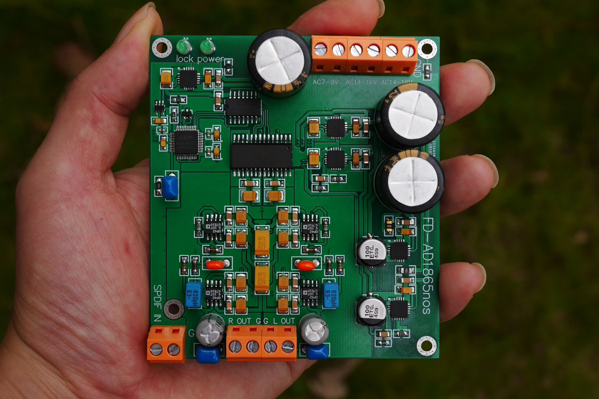

And, could this DAC be modded to bypass SPDIF input, and instead accept I2S signal direct to the chip, like what Matt has considered doing with the Little Giant board?
I've taken a look at the AK4118 and I can't figure out how it can drive the AD1865 correctly, given that the DAC requires simultaneous (both L and R channels) input and the AK4118 has only one data output which outputs L and R sequentially in all possible output modes. Its possible the designer has done a fudge and updates the L and R channels alternately. In any case to hack it to accept I2S doesn't look trivial to me, just from the point of view of additional logic being required.
The AK feeds I2S to a 74HC7266A. I think you can hack the lines between these two? This is mine (small attached pic on the left) but it seems there is another version now with different routing, regulators closer to the DAC IC and bypass caps on the output electros (large attached pic on the right). But given mine has serious issues (probably something oscillating) I can say for sure, don't buy it.

Ah yes, you're right of course. I didn't even bother to check since it's going back. Thanks for pointing that out. I can check again when I'm home if needs be, or the pics should show the hardware settings. the underside only has caps so everything relevant is in the pic I think - no hidden traces under the IC cos of that cluster of caps under it. So, one transistor (?) and one resistor and pins 1, 3 , 8 , 9 all tied together. the rest is spdif in and power in related I think. The aliexpress ad still has the first design so better pics are there AD1865 decoding finished board r2r decoding nos mode DAC hifi audio good-in Digital-to-Analog Converter from Consumer Electronics on Aliexpress.com | Alibaba Group
I looked up the logic gate and I think you're right. I guess he uses the LR CLK to toggle data output between L and R, but if that's the case, it would seem to me they would either be out of sync or out of phase? 😕
Without any data storage being used (like some shift registers) I reckon the best that can be done is updating the two channels alternately within the sample period. So they'll have a time delay between them of about 11uS. That's not out of sync but it is out of phase, very much like the original Sony CD player which time-shared one DAC between L and R.
