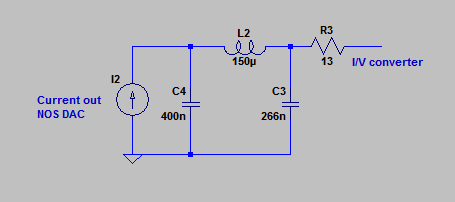

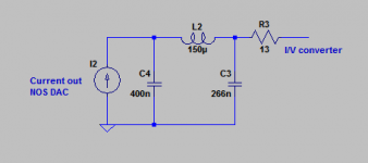

I agree @Rick its very important to roll-off the HF before it gets to the I/V. Here's the filter I'm using with my AD8067 I/V stage - its a 3rd order LPF with enough peaking to provide NOS droop correction.
The 13ohm resistor (R3) is the termination for the filter and its value is fairly critical to getting the correct FR. With opamp I/V the input impedance at the -ve pin of the opamp is normally very low (created by feedback) so the filter can be used as-is with an opamp following. It can also be used with a discrete stage with the proviso that R3 will need to be reduced so that the sum of it with the input impedance of the I/V stage equals 13ohm.
The caps should ideally be NP0/C0G - use 4*100n in parallel for 400n and 2*100n + 2*33nF for 266n. The inductor isn't too critical in terms of ESR, I'm using SLF7045T-151 (TDK).

Hi Rick - there's one caveat with this droop-correcting filter. That is the impedance seen by the DAC's output rises sharply at the filter's corner frequency. I'm seeing about 8dB boost meaning that close to 20kHz there's an equivalent load of about 33ohm. With the 4mA total swing that results in a worst case 131mV peak-peak at the DAC output.
If that turns out to be too high the solution is to scale the C and L values to give a lower characteristic impedance. For example if L was reduced to 100uH the 400n -> 600n and 266n -> 400n. The 13ohm becomes 8.7ohm and the worst case swing is 87mV.

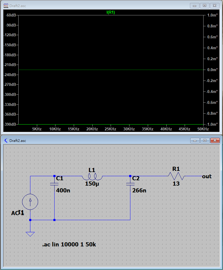

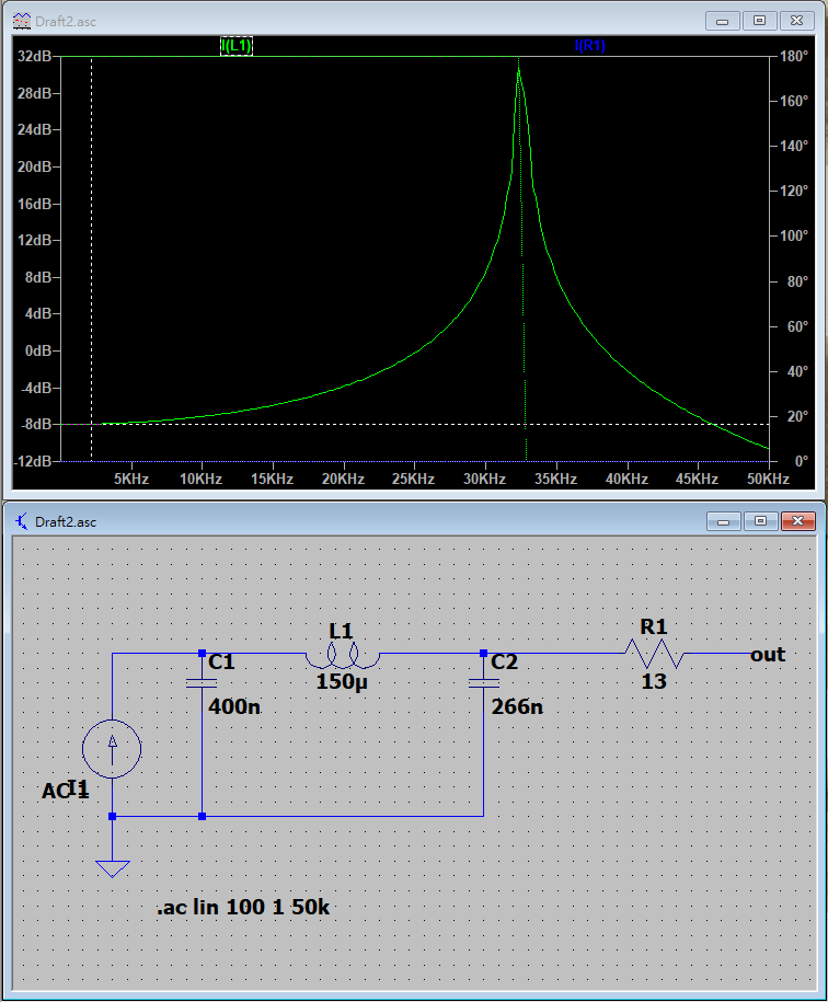

What's missing is a connection to GND for R1, right-hand end. The far end of R1 is designed to go to the virtual earth (pin 2, -ve input) of an opamp. Then you'll get current flowing in R1 - right now looks like you've an open circuit.
In the second plot you're seeing an extremely high Q due to it being an undamped circuit. R1 provides necessary damping, but only when current can flow in it.
