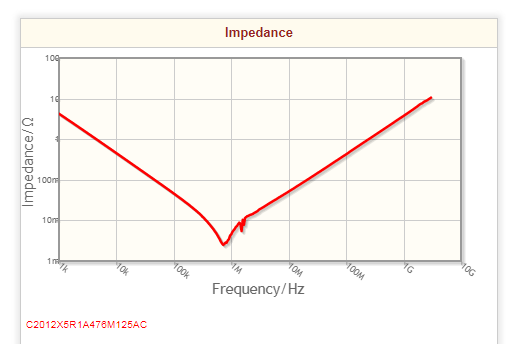

An LC filter has the C as shunt element, here I'm using a couple of 1000uF polymers in parallel so their ESR most likely won't be the bottleneck (its <10mohm per cap), the wiring will be. In addition each opamp (in SOT23-5) is decoupled by a 47uF ceramic directly beneath with even lower ESR than the polymers.
<edit : attached impedance curve of local decouplers>
