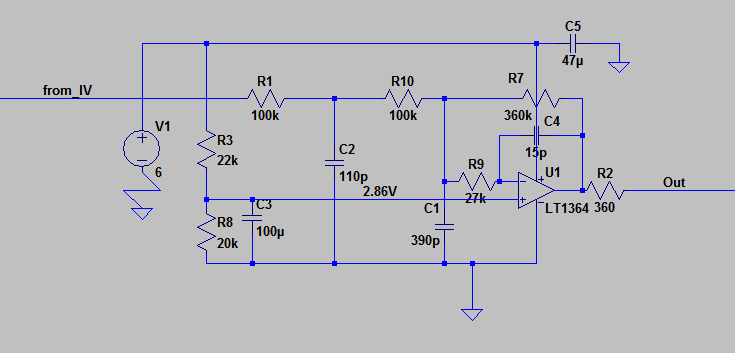

Since I already simmed it in LTspice, here is the filter stage which is the 2nd opamp (the first one is the I/V which I'll draw up next).
The AD8065, while it has a rail-rail output stage (meaning it can deliver the full 2VRMS CD-standard output signal while running from a single 6V rail) doesn't have a rail-rail input stage. So we need care in arranging the input bias, the highest it can go is 3V on a 6V supply. This kind of filter (called multiple feedback or MFB) works very well in situations where the input common-mode range is limited, it uses the opamp in inverting mode. The caps chosen create a slight lift in the HF but not a full NOS droop correction, then roll off at 18dB/octave (due to there being 3 of them). It has a gain of almost 6dB so allows the I/V stage to operate with just 1VRMS at its output.

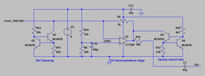

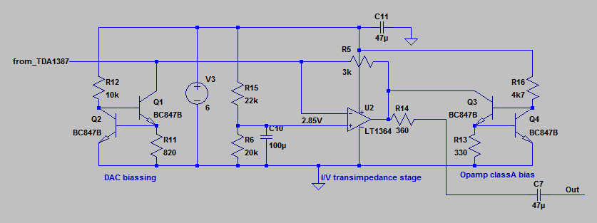

Here's the I/V stage - ignore the LT1364 label in this and the previous schematic - its definitely using AD8065 🙂
This is the schematic of what I was running which still sounded to my ears distinctly of opamps. That being an artificial brightness to the sound - which some listeners do like, calling it 'detail'.
I've since made a few changes which reduce the brightness but if you're a 'detail' lover then this design is for you 😀
As for poorer performance at low voltages, AD8065 isn't your typical opamp. Its fully characterized at 24V (max), 10V and 5V. The GBW is slightly higher at 5V (155MHz vs 145MHz).

Furthermore, in the AD8065 I/V stage schematic above, why not have a capacitor to ground right at the tda1387 output? I know doesn't filter everything, but if we can trivially get rid of some junk early on, why not?

As for the cap to GND question - that's what Scott Wurcer suggests in the datasheet for AD797. Yesterday I did simulate a cap to GND and got a very interesting result for the frequency response. I shall post up the plot later.

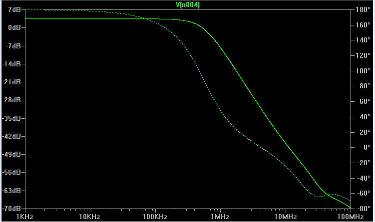

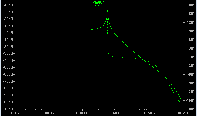

Here are a couple of plots made in LTspice of the I/V circuit I posted up earlier. The first one is what happens with a 2n2 cap to GND from the DAC's output. I chose 2n2 as that's about what I recall Scott Wurcer using on the AD797. As you can see there's a very large peak in the FR. We can quite easily get rid of that though by putting a feedback cap across the 3k (opamp feedback resistor). With 150pF we get a very nicely damped response which is shown in the second plot.
Note I'm using LT1122 for this - chosen as the LT opamp most similar to OP42 (14MHz GBW, 60V/uS slew, JFET input). Changing to the AD8065 would increase the freq of the peak as its a faster part.
Eyeballing the second plot the resulting circuit has roughly a 500kHz bandwidth, -3dB. That's 25X the audio bandwidth. This observation gives us a starting point for getting an answer to Matt's earlier question - how to choose the GBW for an I/V opamp?
