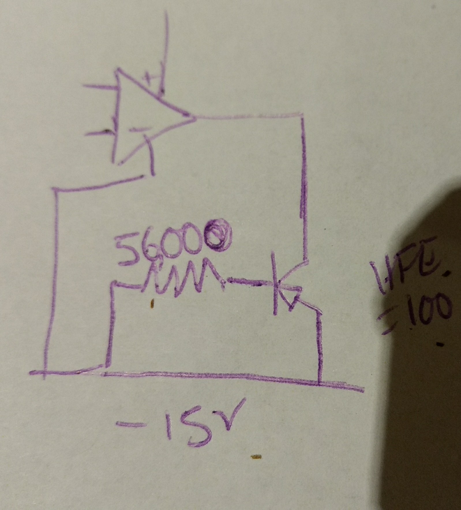

. use a 2 or 3mA current source to the -ve rail
Is this what you mean? Is this correct?
It's half way to being correct - I was thinking of a two transistor current source. You can find the schematic on this page, its (b) in fig 9.24 (scroll down). Its using two NPN transistors, BC846B work well but its not very critical on transistor type. R1 will be 220ohm and R2, 47k when fed from a 15V supply (i.e. the 0V rail).
https://www.edn.com/Home/PrintView?contentItemId=4015906
An excellent article by Johh Linsley Hood. Thanks for the link.
