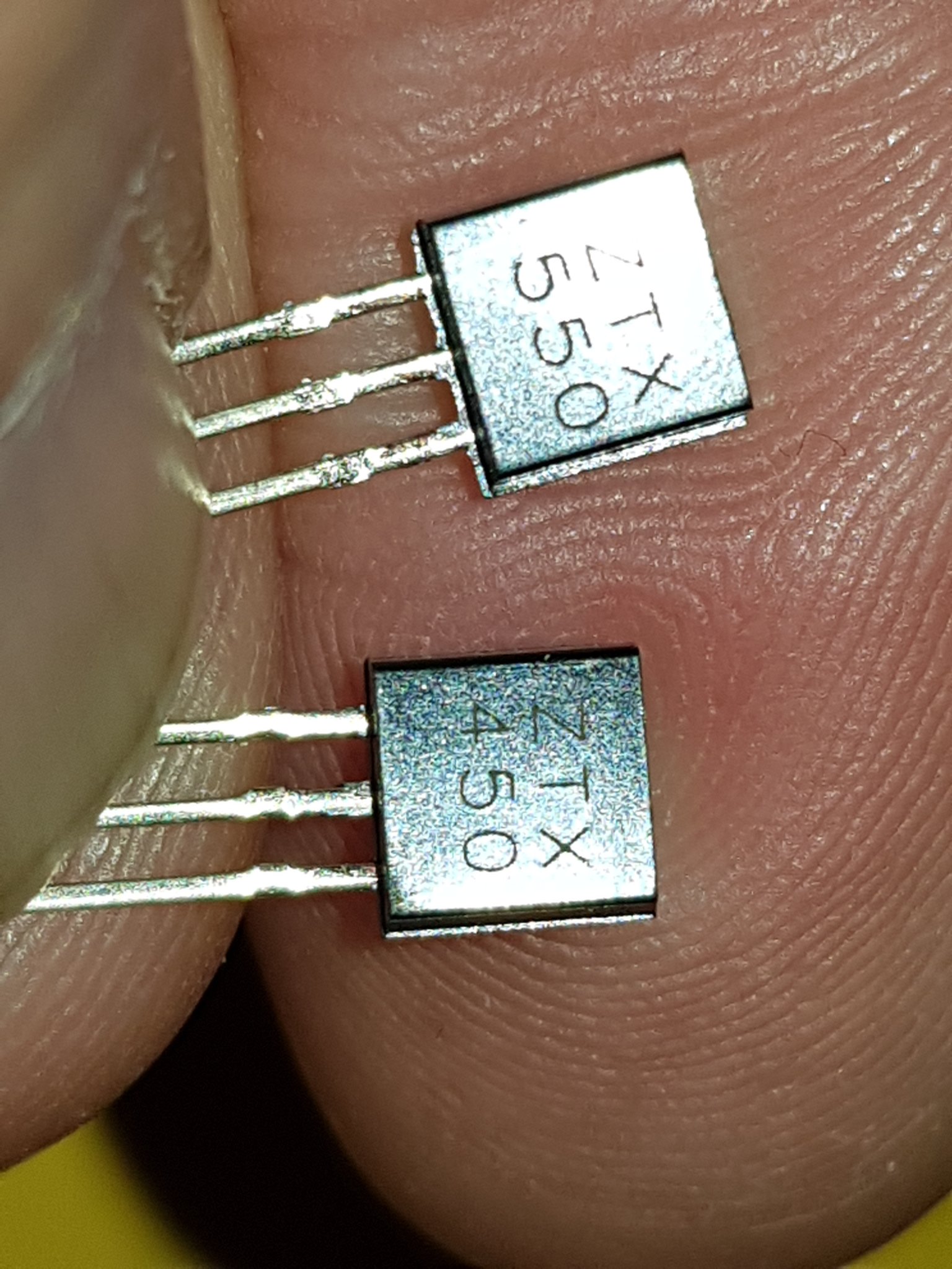

@Dennis Huinamghiwook, Please check the DC voltage at R11 or R12 - black probe at Ground, red probe at R11 or R12. What is the voltage? Does the voltage change if you adjust R7?
I used ZTX450, ZTX550.
@Ben Mah
1 turn of R7 changed about 3V of R11, R12.
ex.
R11 8.98V -> 9.28V
R12 8.94V -> 9.26V
and my BOM from 'Aleph J build guide for noobs'
Getting about 0.3V per turn seems about right, but the R11, R12 voltages seem wrong. I would have expected them to be in the -19V range (assuming ~ +/-23V rails).
Can you please measure your rail voltages on the amp PCB? Black probe on GND, red probe on V+ and V-.
What Dennis said.

I adjusted R7 and obtained dc offset voltage sudden back and forth range ... in about 1 VDC.
DC offset is not stable and so much sensitive to just a little turn of R7.
DC offset rises to over 10 VDC again.
Both heat sinks was warm.
I powered it up again and dc offset started at -23.4VDC and decreased to under 1VDC ... and not stable. ... and over 13VDC suddenly again.
That's interesting. The original Zetex/Diodes parts use an E-line package while your earlier photos with Q2 and Q3 (https://www.diyaudio.com/community/attachments/20240325_014245-jpg.1290187/ and https://www.diyaudio.com/community/attachments/20240325_014216-jpg.1290186/ ) seem to show the 'round' side of the TO-92 package. And I have not found any second sources for those parts that might have used TO-92 instead.I used ZTX450, ZTX550.
I just want to make sure you don't have a pin-out problem with those transistors.
Those are parts. Porn implies joints. You read the wrong guide, should have been this one: https://www.mindbodygreen.com/articles/kama-sutraA little late night porn. The 2nd photo shows the resistors after I checked them against the BOM, as you can see I wrote down the values which saved a lot of time when stuffing the boards.
Finding the resistor locations from the board stencil often was more difficult to locate vs. locating it in the Guide.
I’m curious if your ZTX series of transistors are genuine. They don’t look anything like the ones I have that I purchased from Mouser. Can others compare and let us know?
Do you have any BC550/560 transistors on your bench? They can also be used in the Aleph J circuit as substitutes. BC560 for Q2 and BC550 for Q3, Q4.

Fairly generic bipolars can be used in those positions. As long as their betas are not too low and their pinouts fit the PCB (i.e., the centre pin is base) they should work ok.
@namghiwook: Have you double checked the correct parts are in the right places and that all solder joints are ok? Also, where did you source the jfets?
