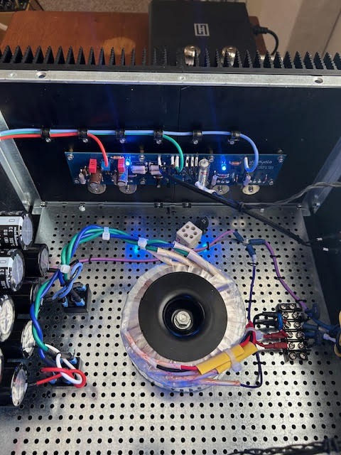

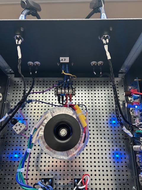

Good evening,
I have been reading the posts and learning a lot, I am new to amp building, but wanted to give a shout out to 6L6, poseidonsvoice, zen mod, and the rest of the members who give a lot of time and experience on this forum. Much appreciated! I wanted to share some pictures of the second Aleph J that I built.
Thank you for all you do,
Kelly,
