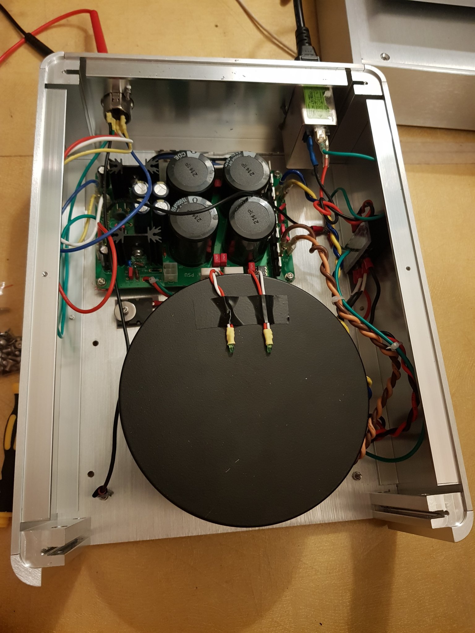

I'm using SLB without capacitor bank.
Can I find some pcb for capacitor bank or wiring diagram?
Can I use this Kemet Cap 40V 36000uf x 2 and capacitor clamps?

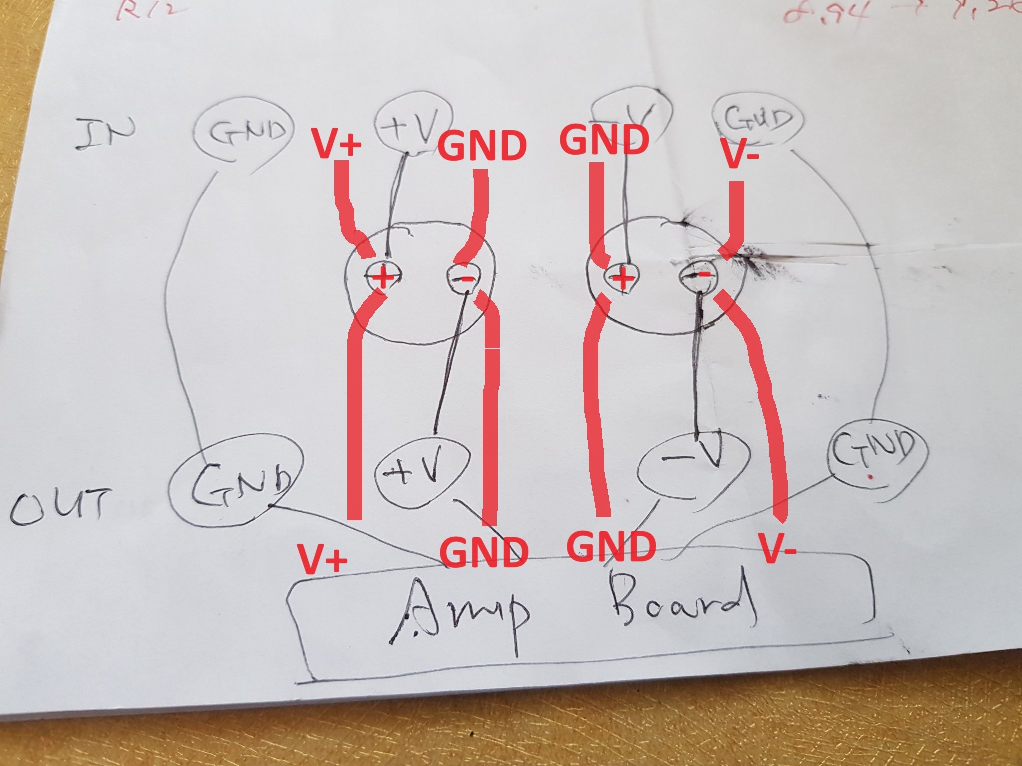

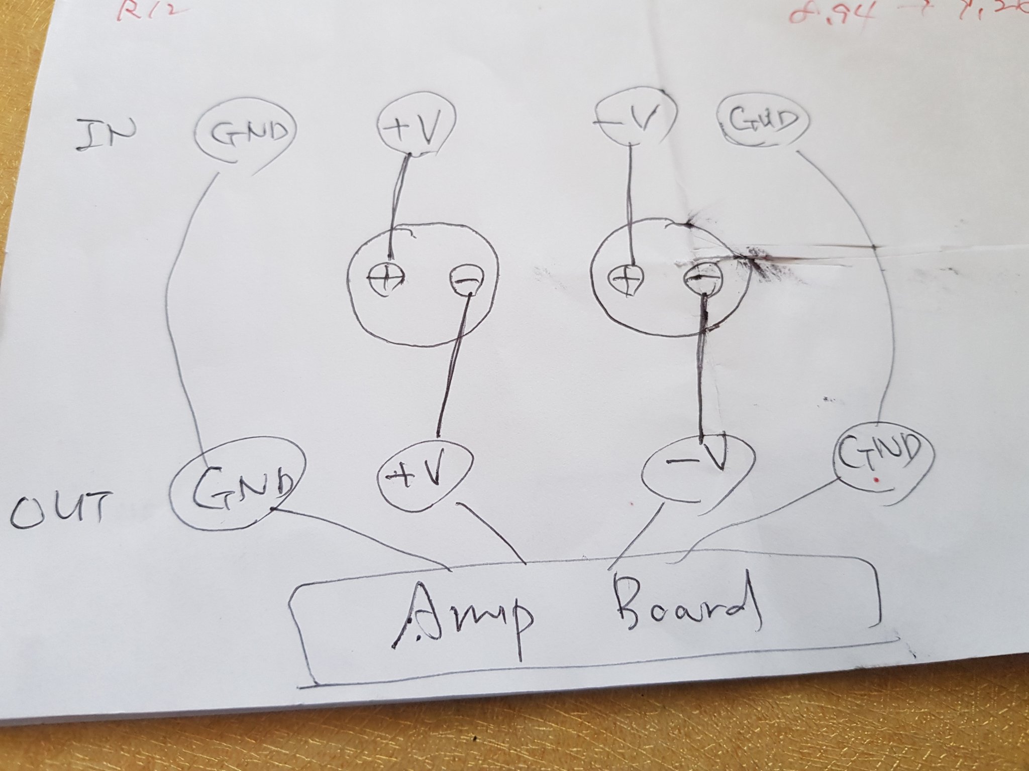

Is this wiring right?
