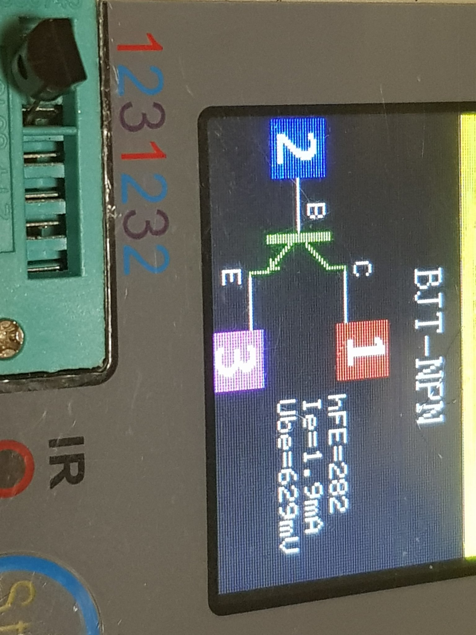

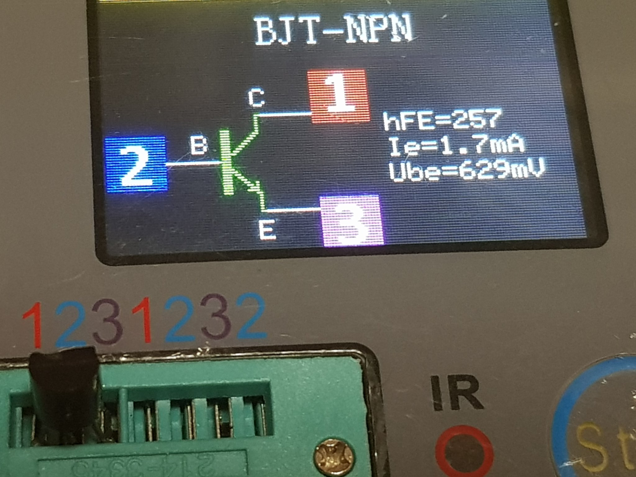

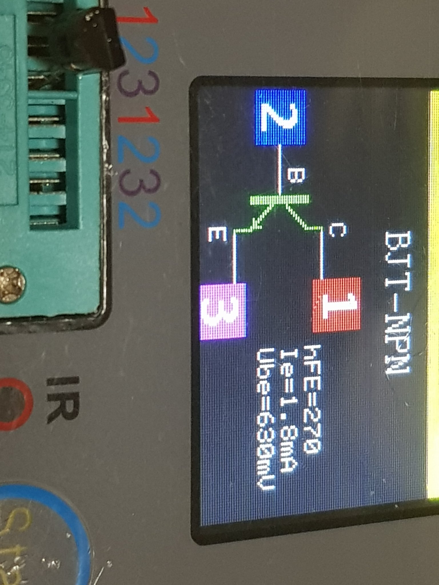

@namghiwook : As Anand also pointed out earlier, your bipolar transistors don't look like the original Zetex parts. Can you measure run your Mega328 on the ones you have? What do their hFE and Vf or Uf look like?
Please let us know what happens after reflowing the solder and cleaning the PCBs.
Thanks,
Dennis

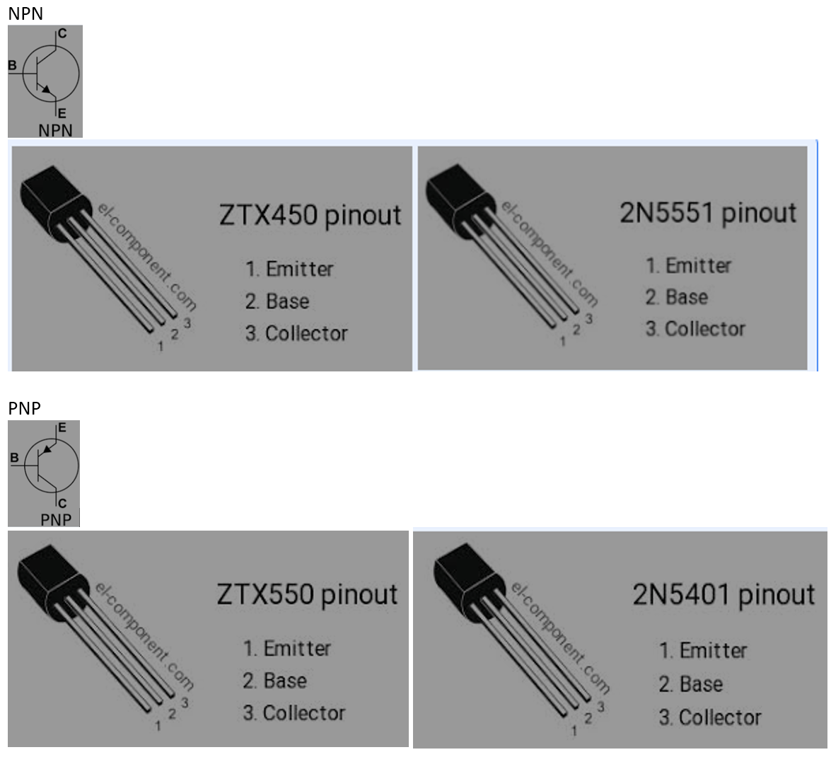

I desoldered Q2,3,4.
The desoldered Q3,4 (ZTX450) is NPN.
The desoldered Q2 (ZTX550) is NPN. woops.
These ZTXs seem to be fake.

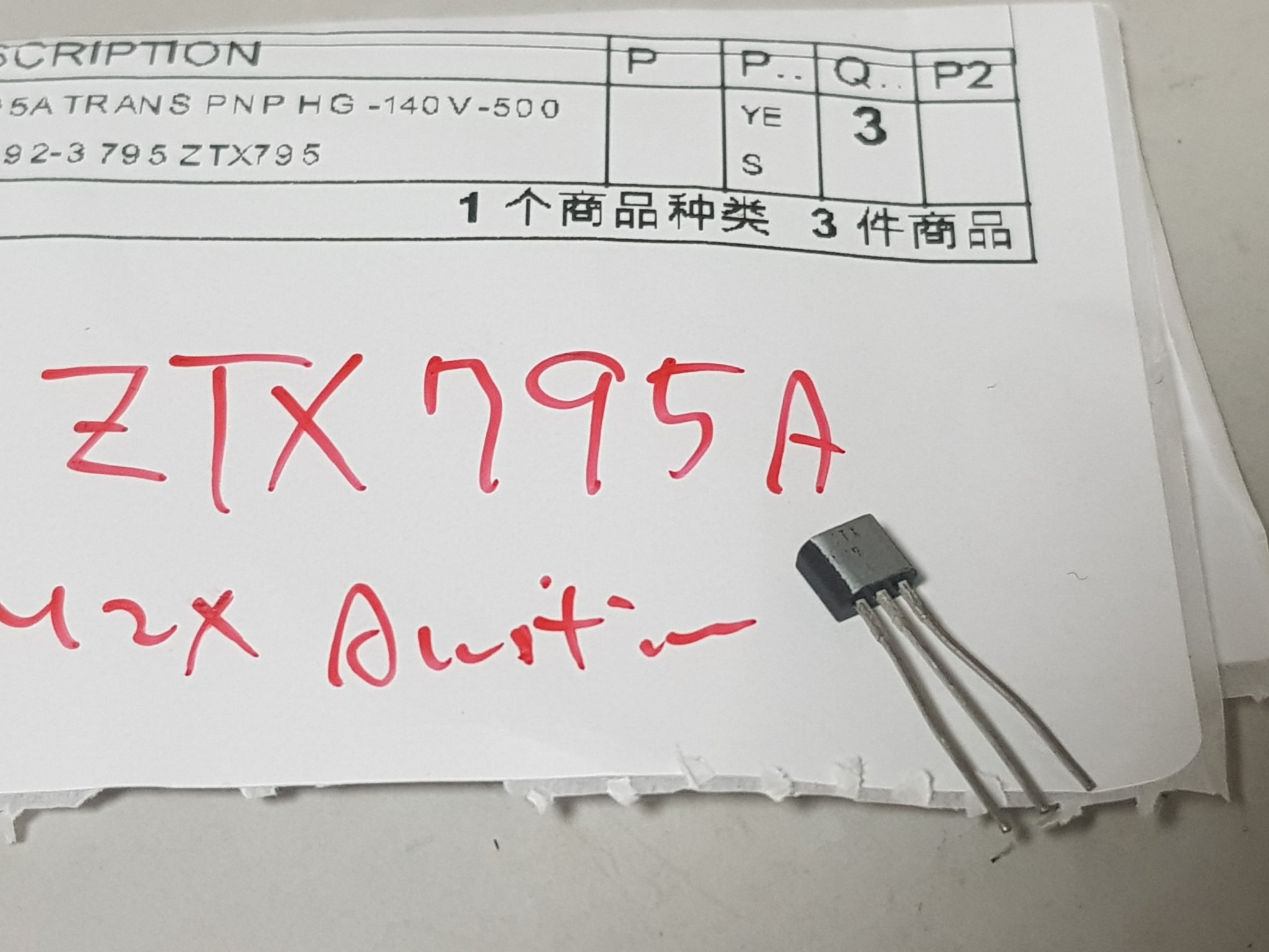

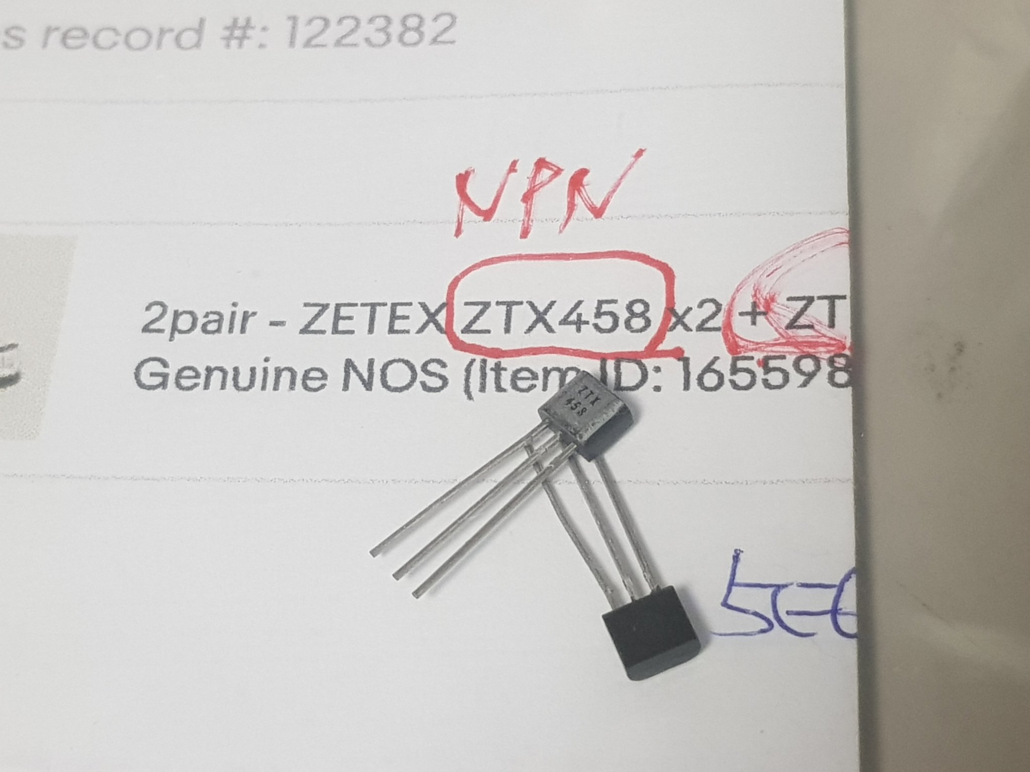

I have ZTX795(PNP) and ZTX458(NPN).
Can I use these?

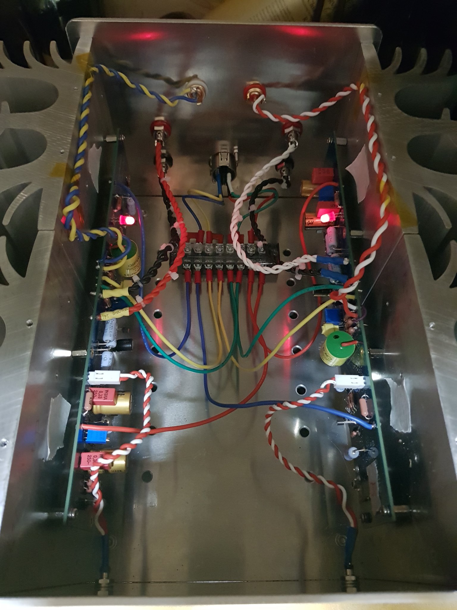

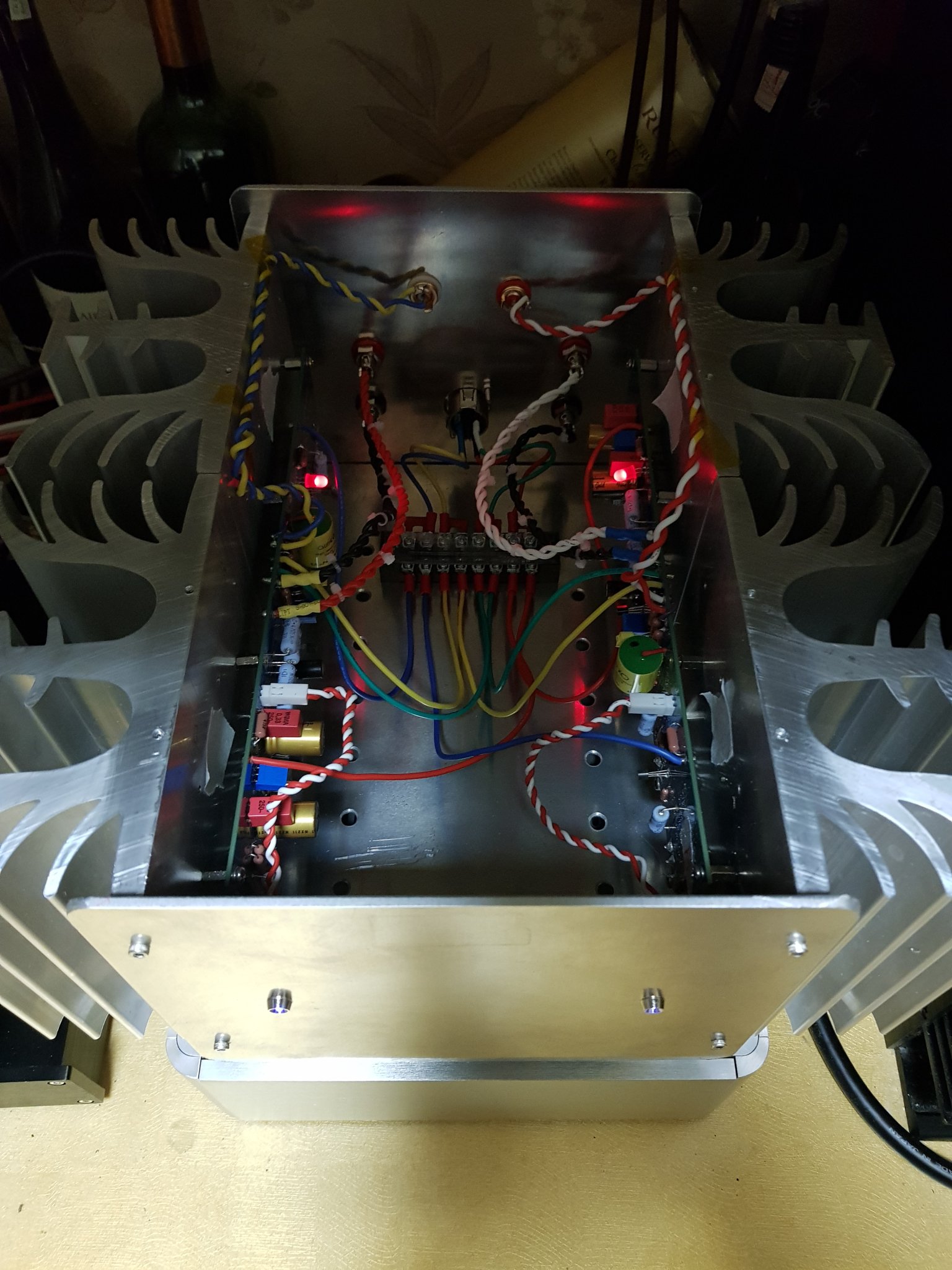

An Aleph J should exhibit no more than a soft thump upon turn off.
The SLB boards require (yes, require) at least 10,000 uF, and up to 36,000 uF of bulk capacitance on their output to function correctly. This can be in various forms, including several 10,000 uF caps remaining from previous projects.
My point is that XRK971 intended it to not require additional capacitance. From the pictures, it has 30mF of capacitance per rail. The schematic shows it as a CRC of 15mF-0.2R-15mF in front of the capacitance multiplier. For a Class A amplifier is that not a reasonable amount of capacitance?
Reactions: andynor
Yes, regardless of intent, a CapMx supply will not function correctly without capacitance on its output. The input filter is just enough to reduce initial ripple to a point where the pass transistors (complementary feedback pair in this case) can bring the output ripple to an acceptable level. The final bulk capacitor(s) form a low frequency pole in conjunction with the speaker impedance. We want this to be the lowest pole in the amp/speaker system. Both transistors in the CFP need to have low Vcesat figures. That prevents the pass element from snapping off prematurely.
I have used SLB boards in my F6 and DIY Sony VFET amps. They work quite well when done properly. I tried building both amps with and without the extra bulk capacitance. Both examples exhibited a clear improvement in performance with the extra caps. Fortunately the bulk capacitors don't need to take up too much floor space. Kemet makes some excellent screw terminal capacitors with 40V rating in 24,000 uF and 36,000 uF models.
My point is
I'm not familiar with developing process of these circuits, but when I spotted some guys using cap multiplier without final cap bank, I did comment that final cap bank is absolutely necessary - no replacement for displacement and cap multiplier isn't anything else than Beancounter's choke......... so ..........
and boyz who tried what I wrote informed of much better behavior after installing some proper capacitance where it needs to be
