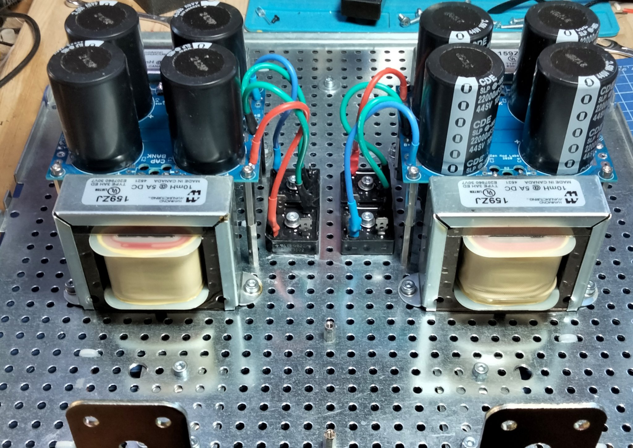

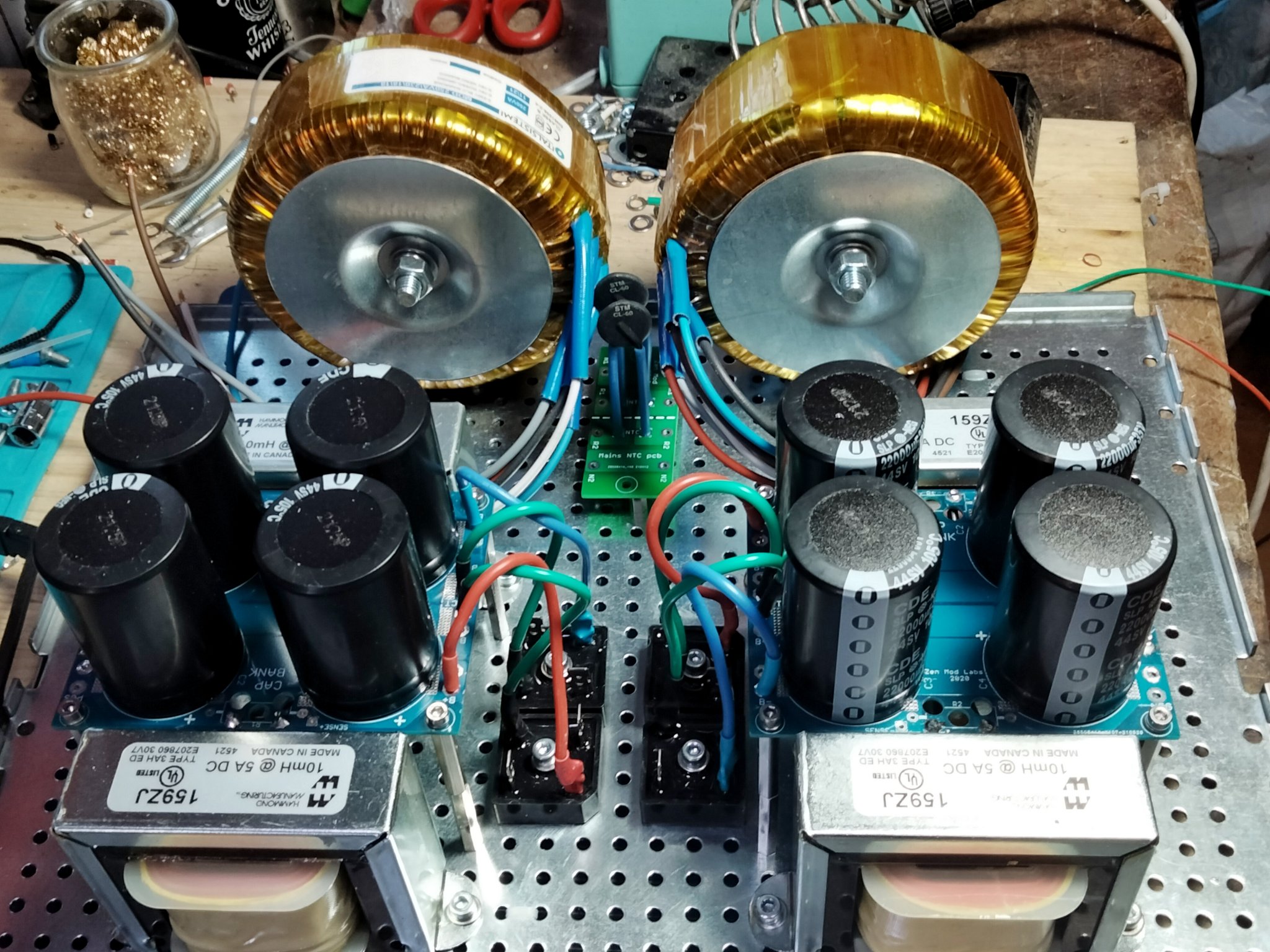

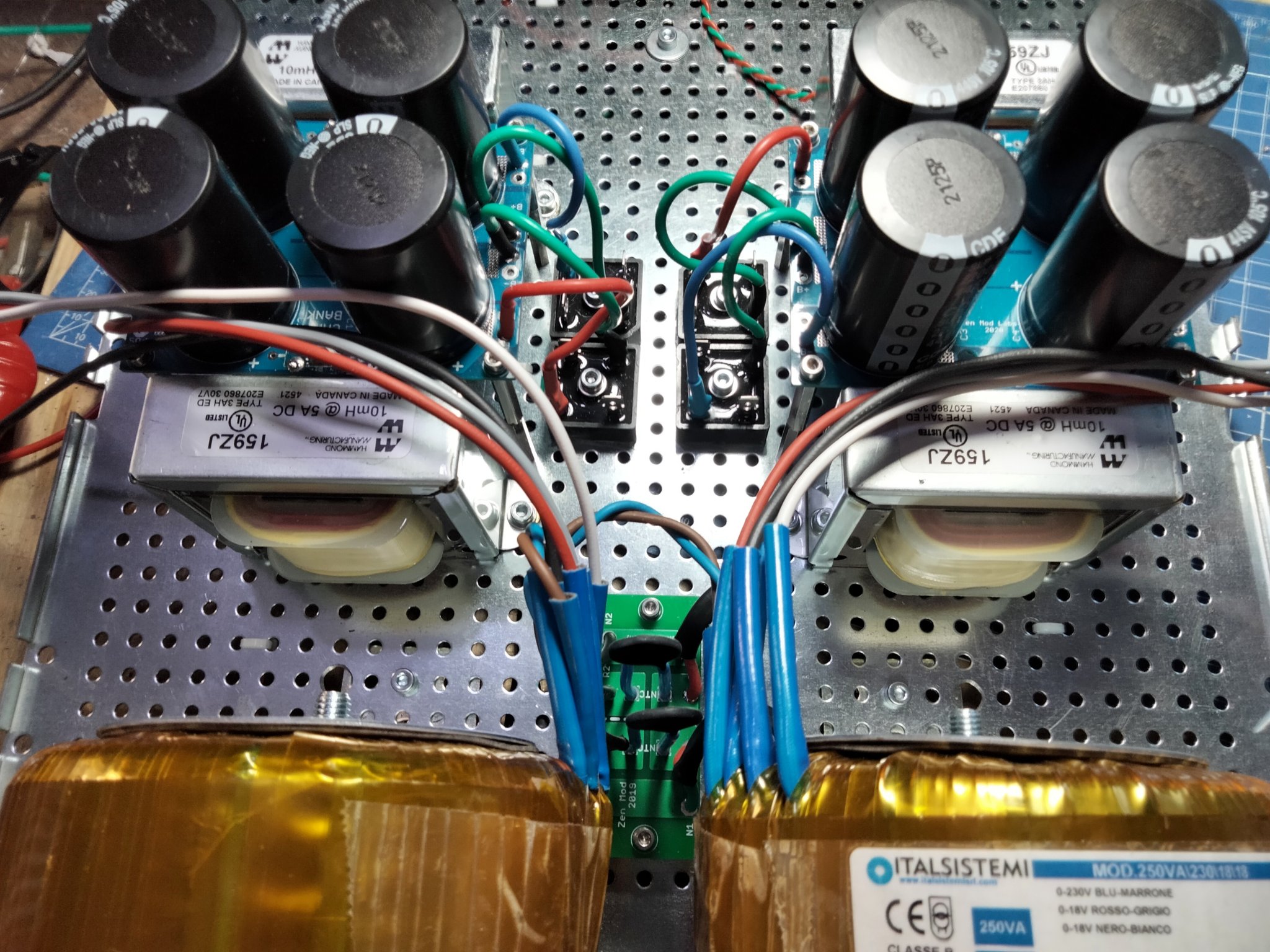

hope your Donuts are having twice 18Vac , each, or you'll have Mute Dual Mono
Twice? I bought only half a secondary…. Jeeeeeez

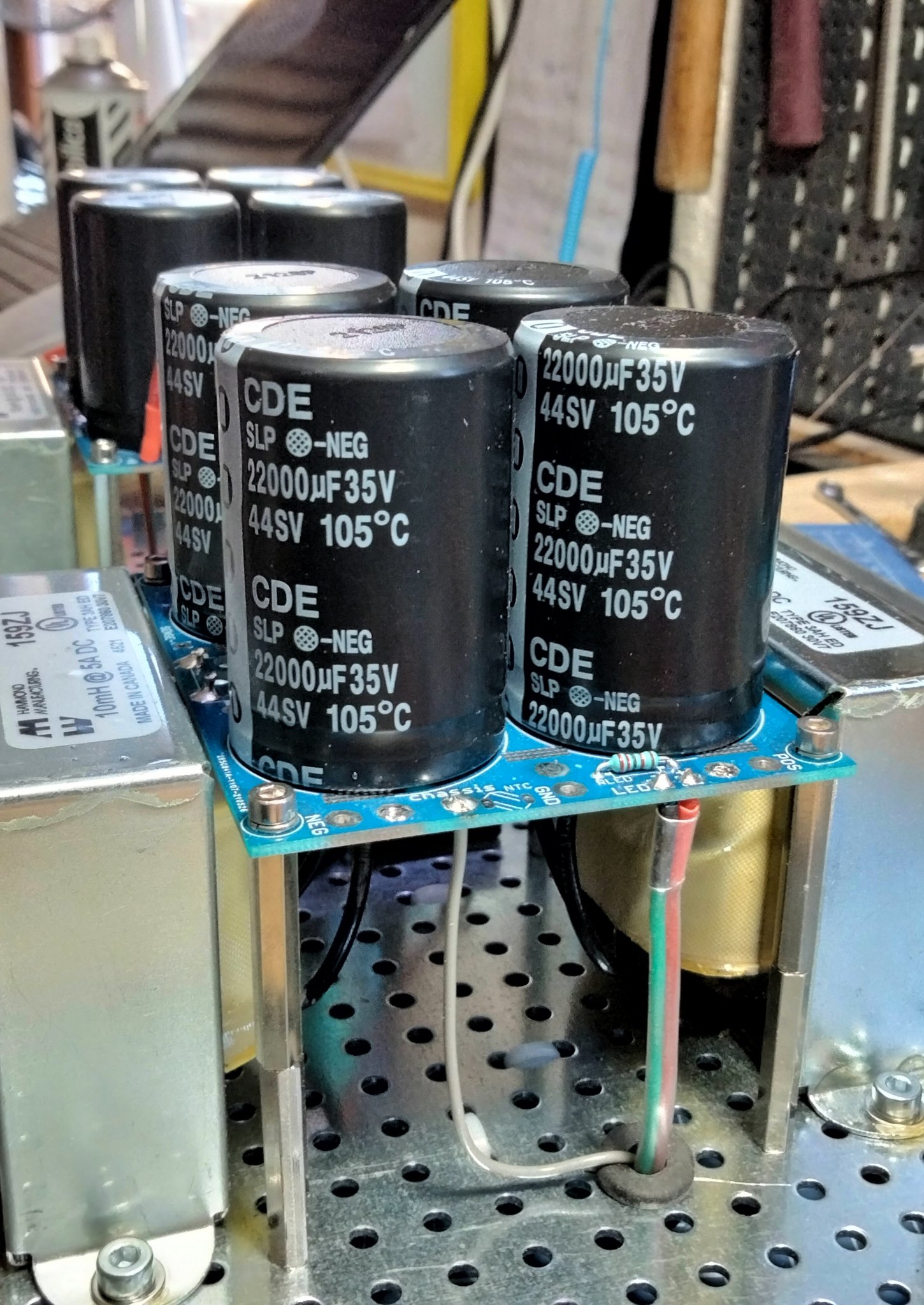

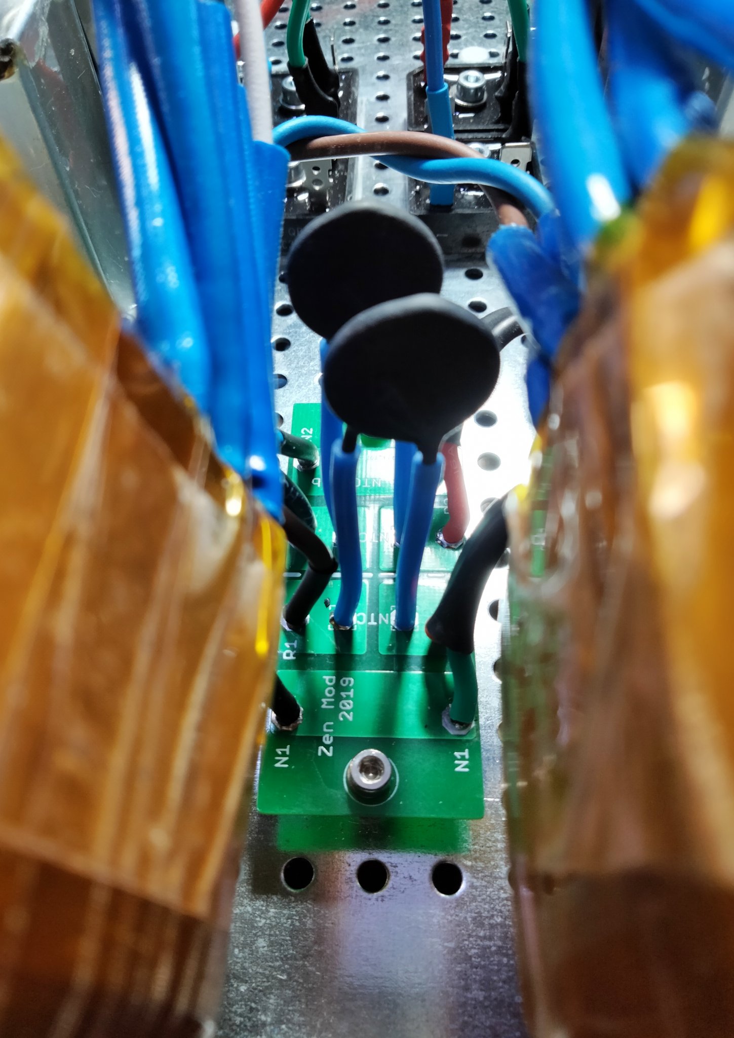

Forgot to mention the obvious 10uF film caps for decoupling at the load. @ 1/10.000th of last cap value. Just copying the BA-2 decoupler value/ 1/10.000 rule. So no maths involved. We’ll se how it goes

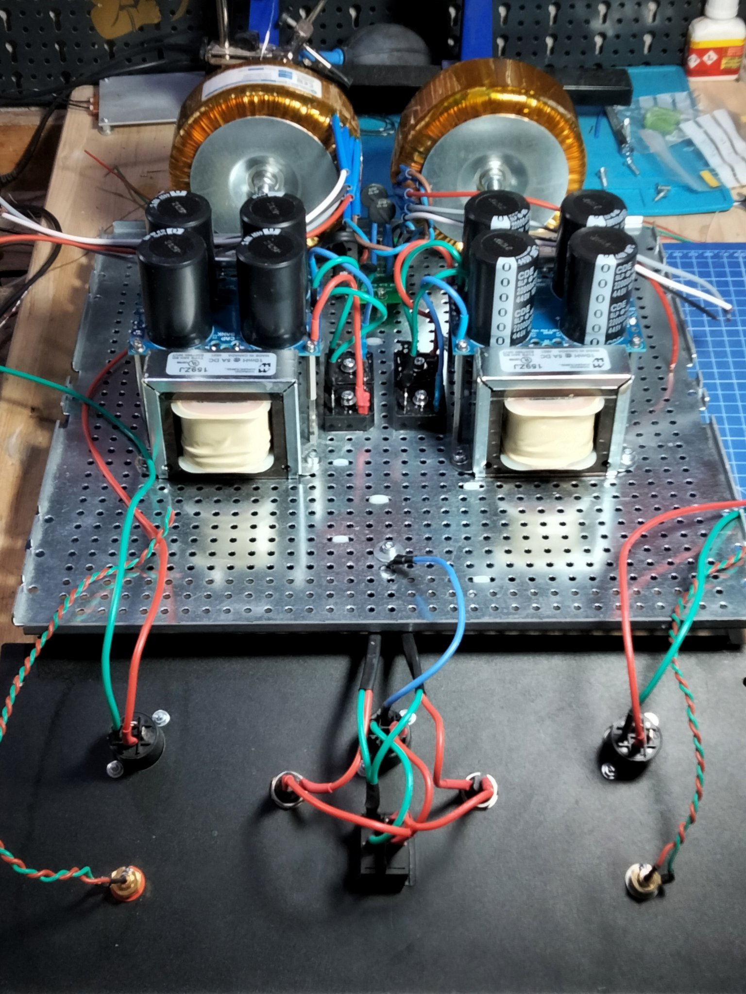

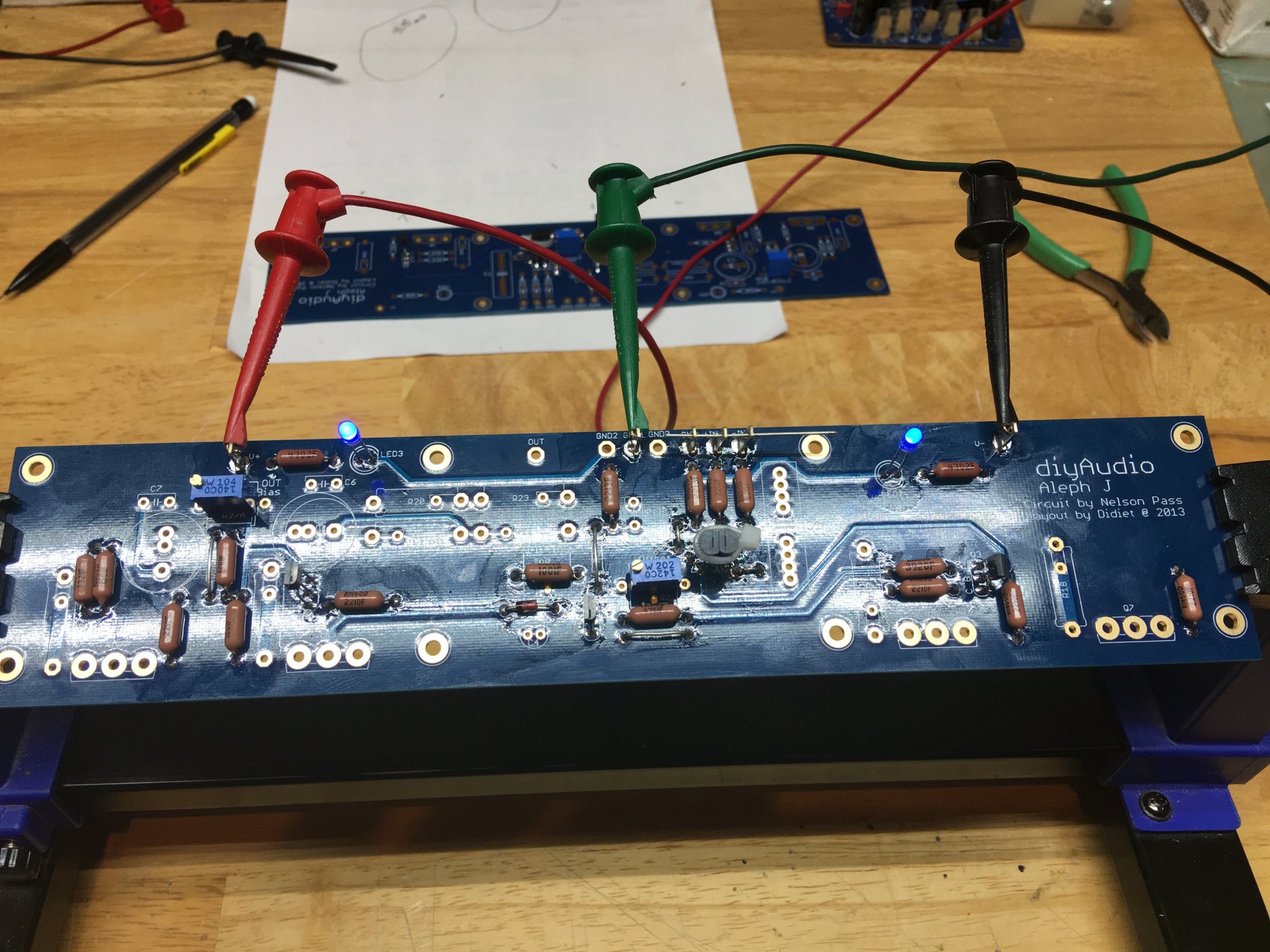

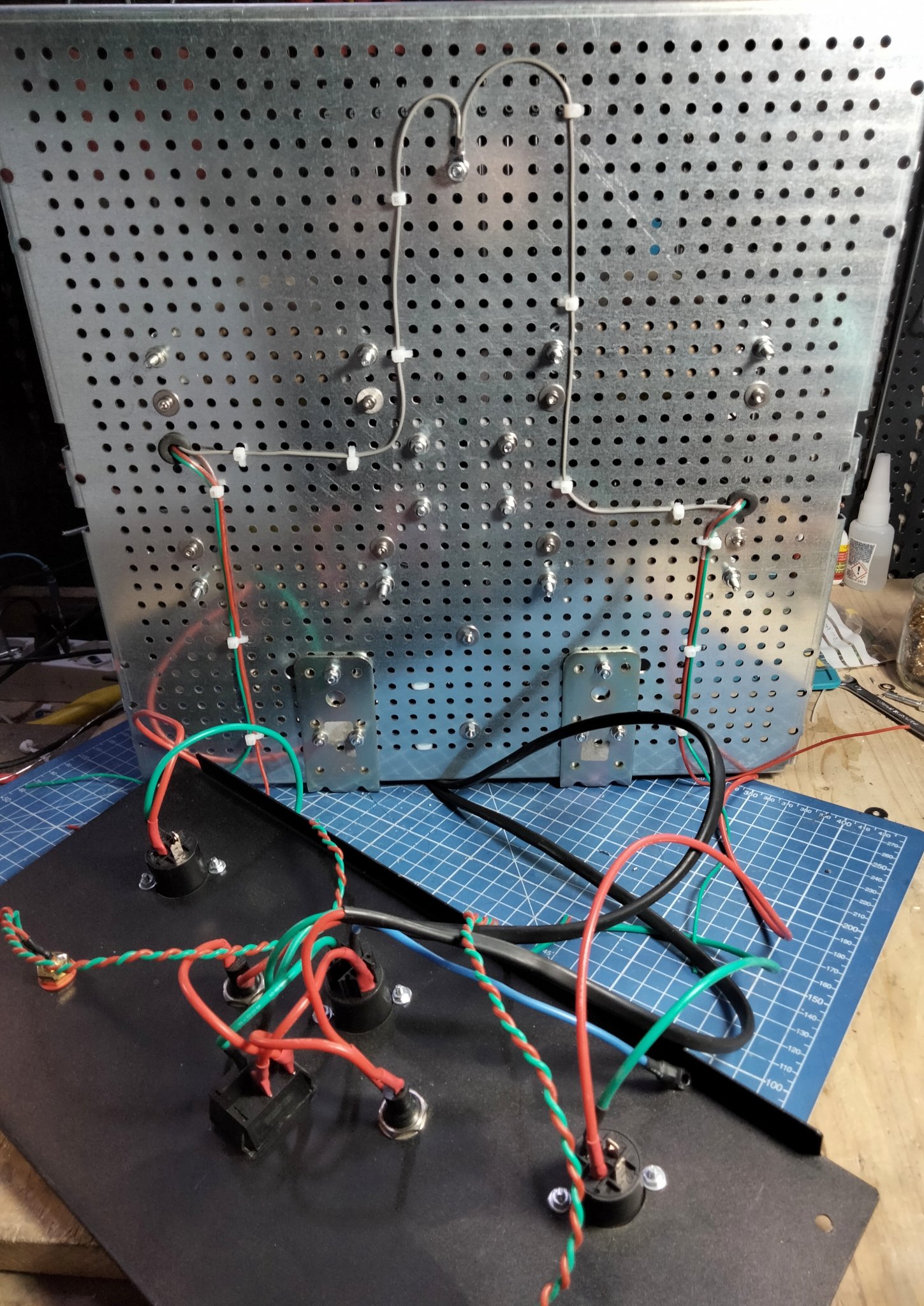

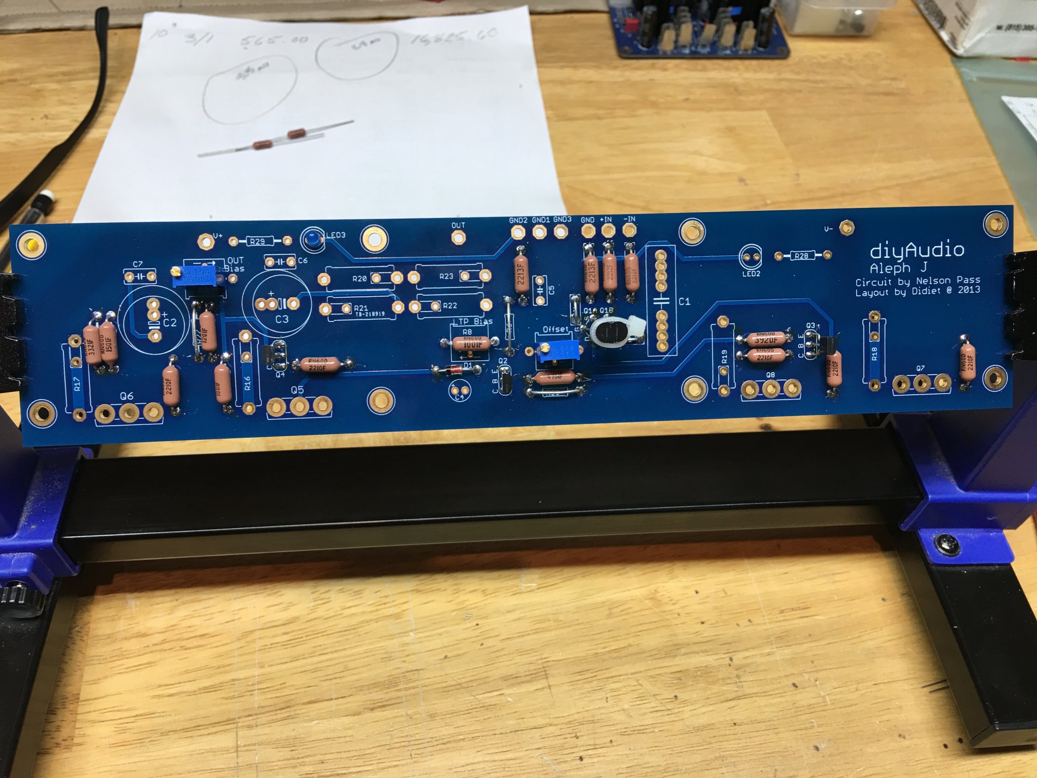

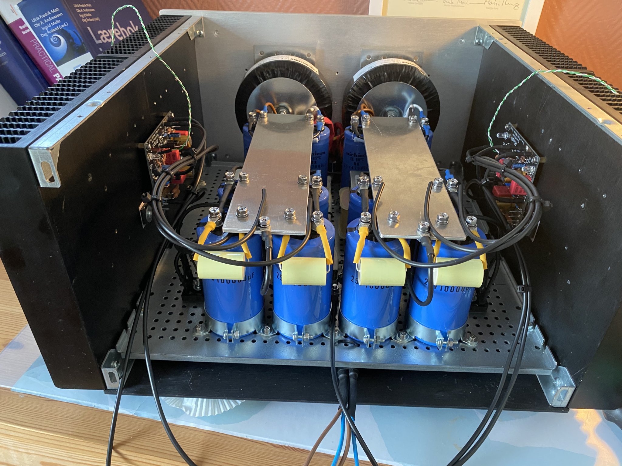

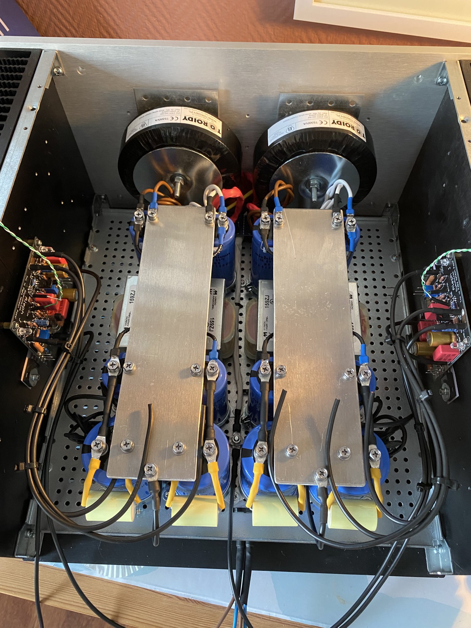

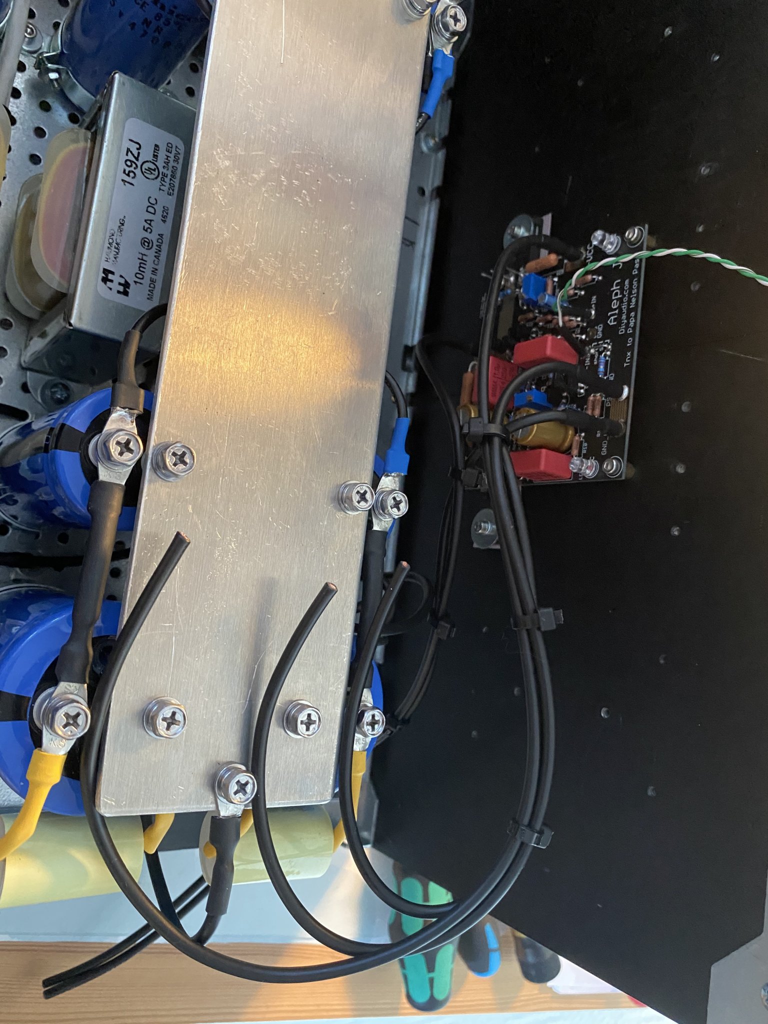

After replacing R23 on the left channel, for proper Iq, PSU is now slid in, and wiring beginning to take shape. After connecting rails, next and last step is the back plate.
MOSFETs are now torqued to 0N9, for a target dissipation of 50 watts per device. Bokys ice cube suggestion finally settled it.

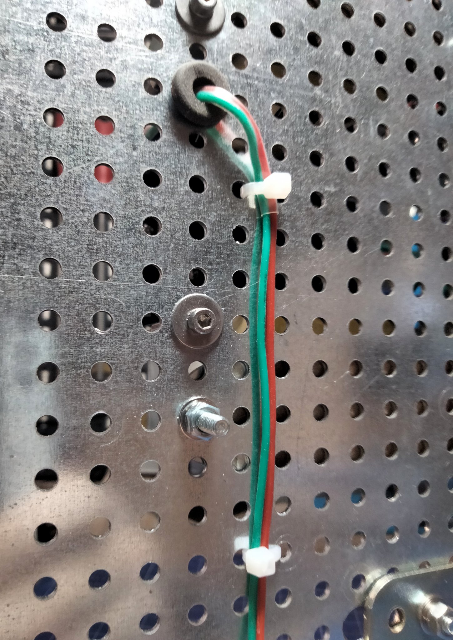

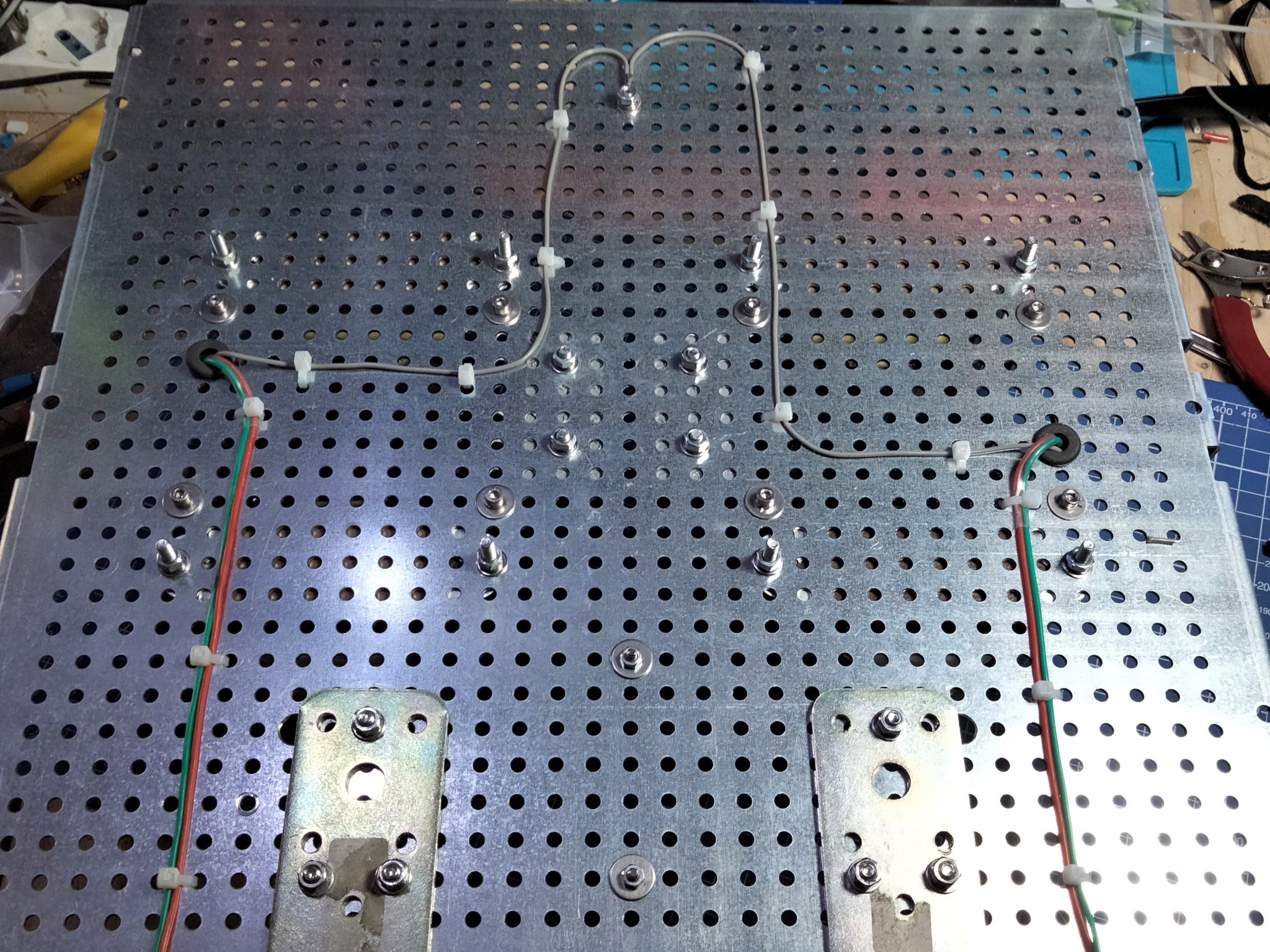

After fiddling back and forth with wiring, I settled for this. It keeps the DC wires close to the speaker wires, fairly low in the chassis, and fairly short taking into account how far back the rails are.
Also, pulling the PSUs max towards center line, makes it fairly easy to adjust Iq and offset even though it’s pretty cramped.
Pretty happy with the overall layout. My cleanest wiring so far. Chose not to twist extremely tight. Testing will show if that is needed. But I think and hope not.
Edit: most direct DC wiring puts the wires above the ground plane. I have a bit of OCD wrt it shorting somewhere down the line, so will try this first. There will be plenty of wire to rerpute the wires later.
Andy
Andy

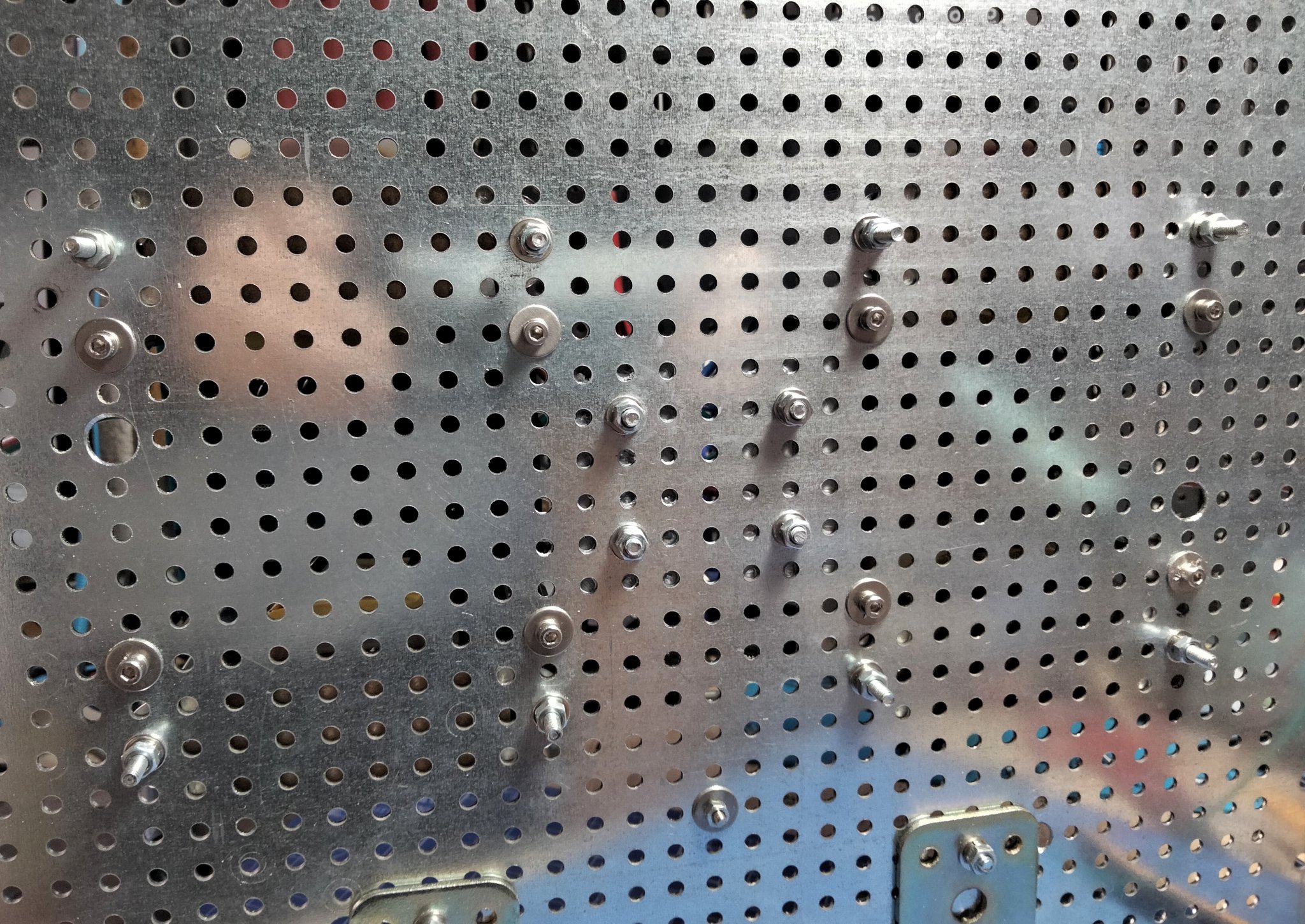

Andy
Andy
take a look at PL amps having Al ground plane and rails
they're not chickened regarding wire isolation in long term
this is not concrete shaker or Car
- Aleph J illustrated build guide
